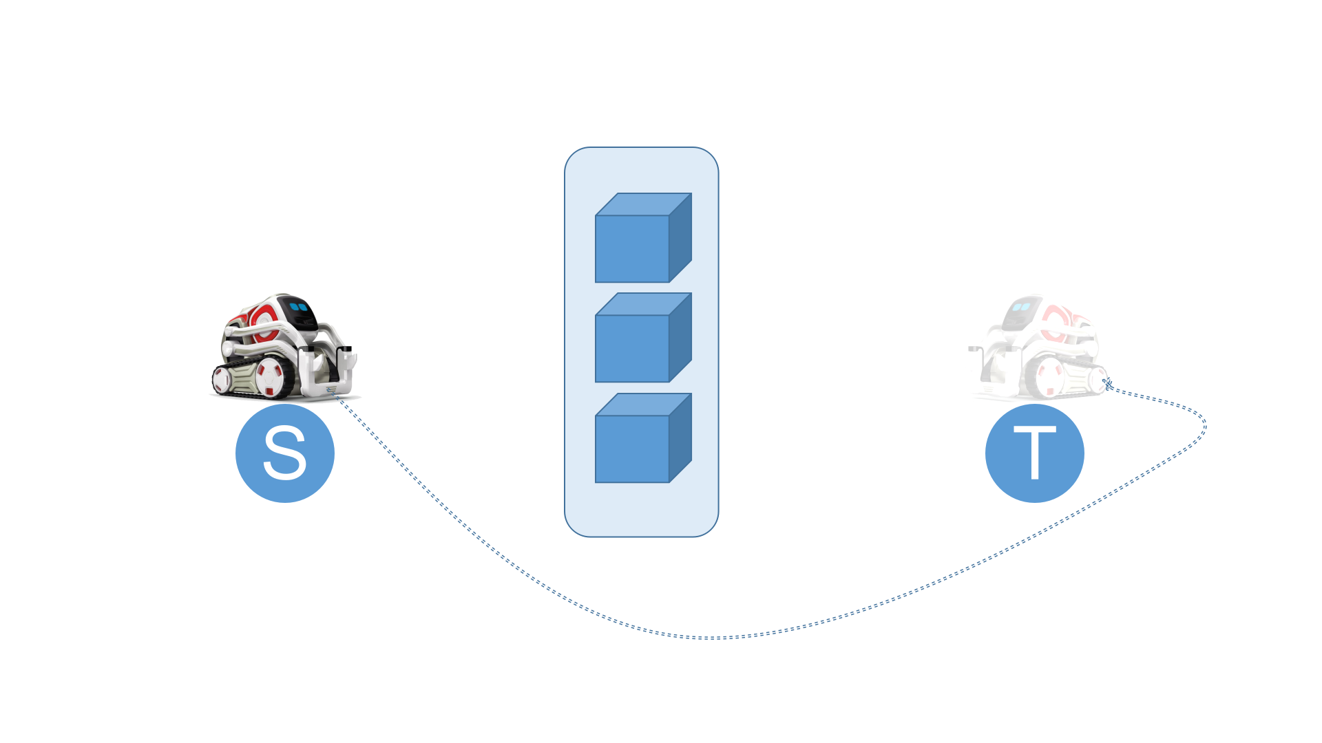

问题描述:Problem Description:
机器人从S点自主行驶到T点。The robot moves autonomously from point S to point T.

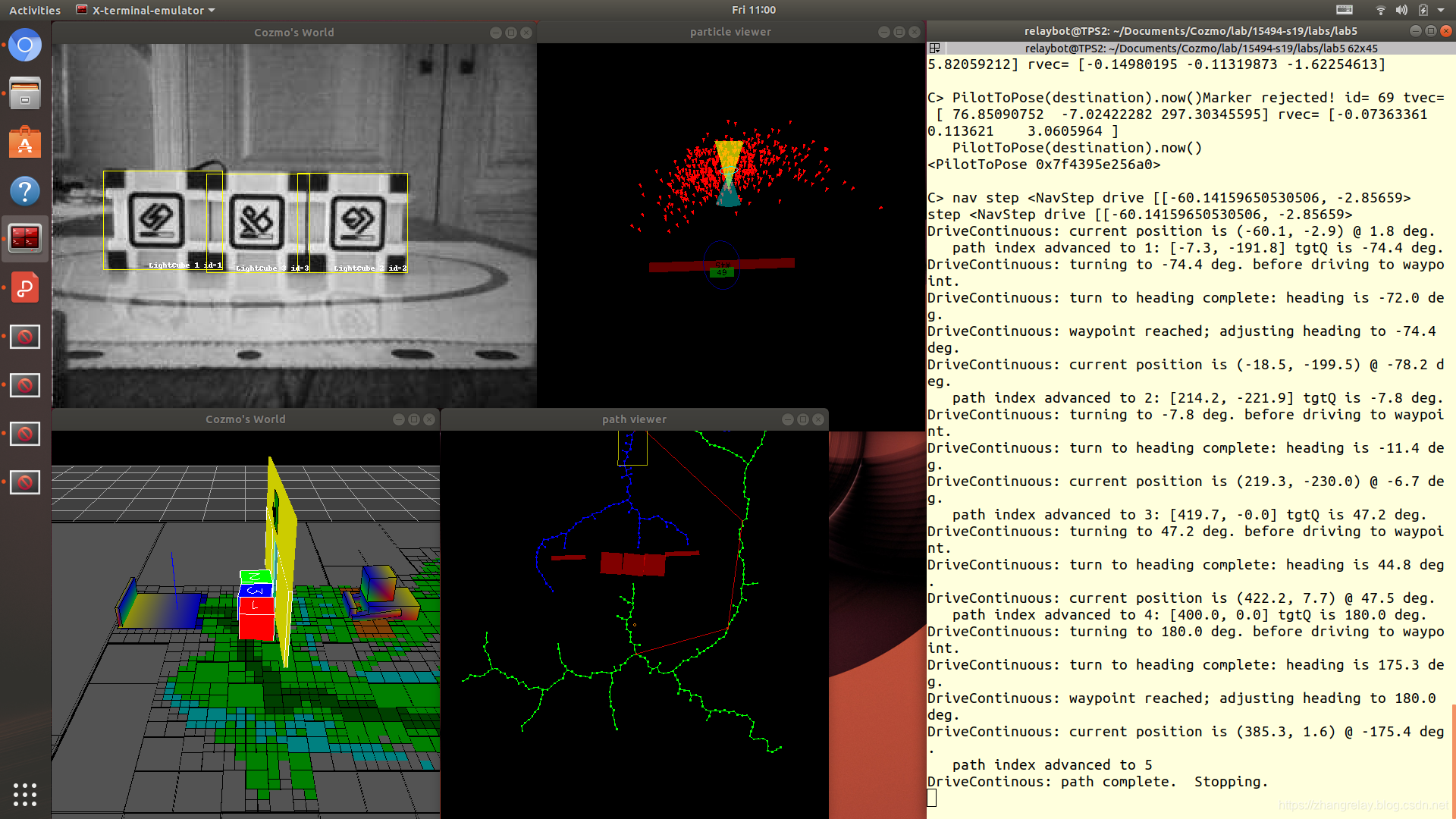

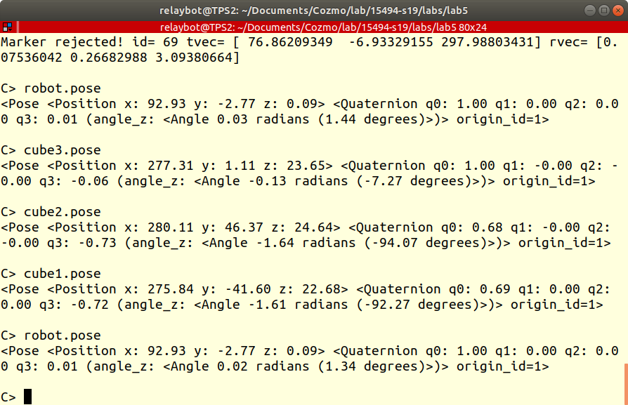

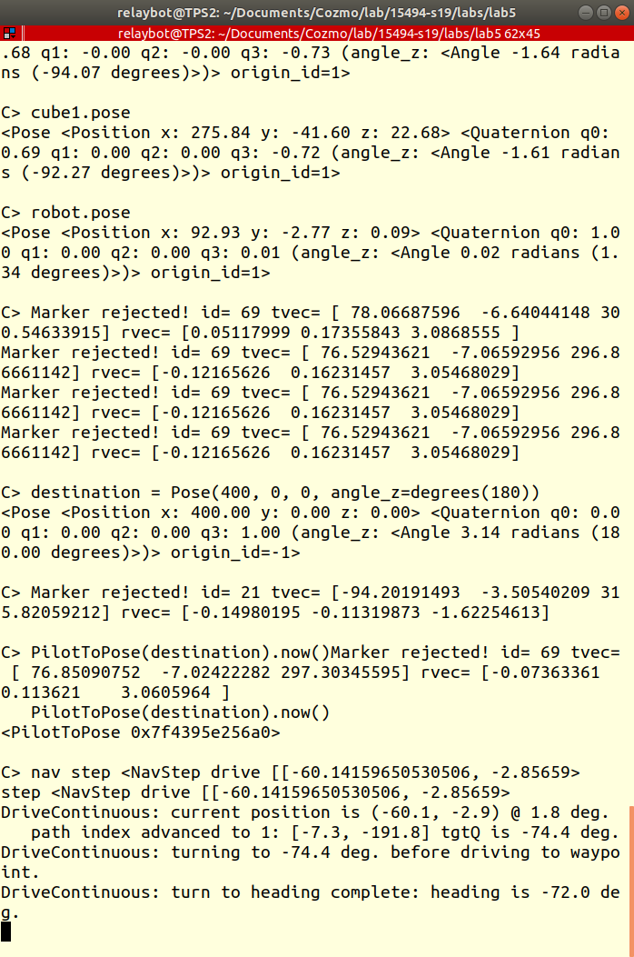

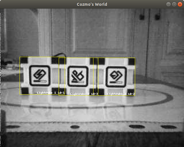

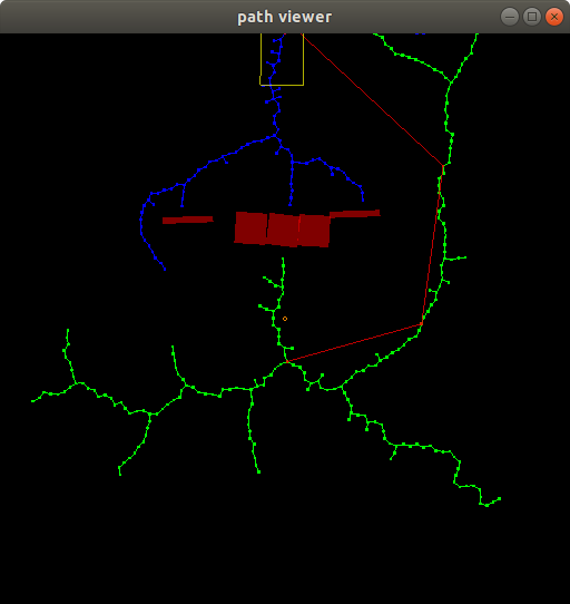

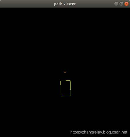

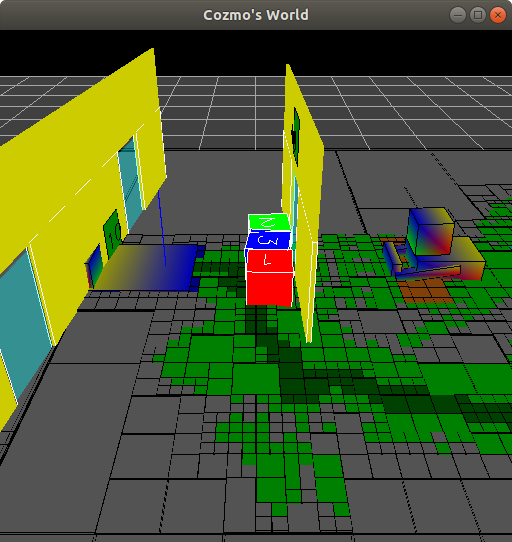

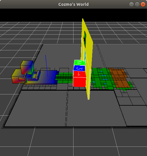

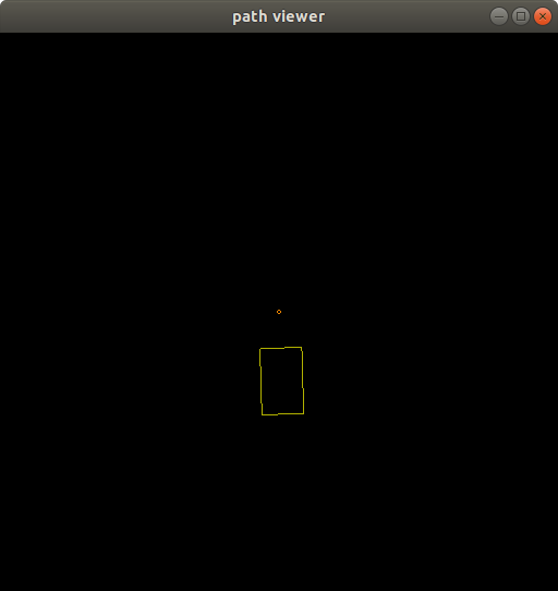

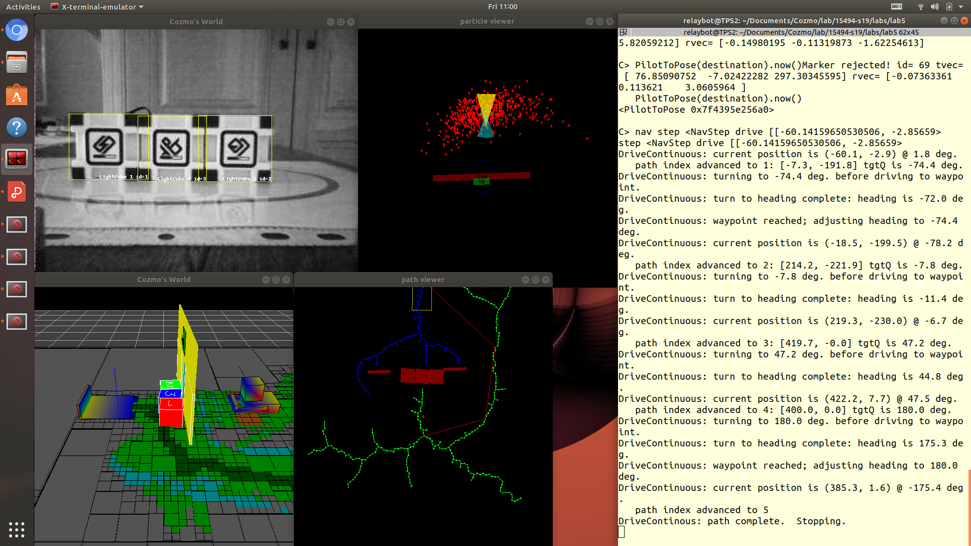

查看机器人和立方体的坐标,并设置目标位置和方向。View the coordinates of the robot and cube and set the target position and orientation.
起点处各窗口信息如上。The information of each window at the starting point is as above.

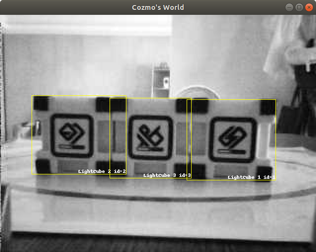

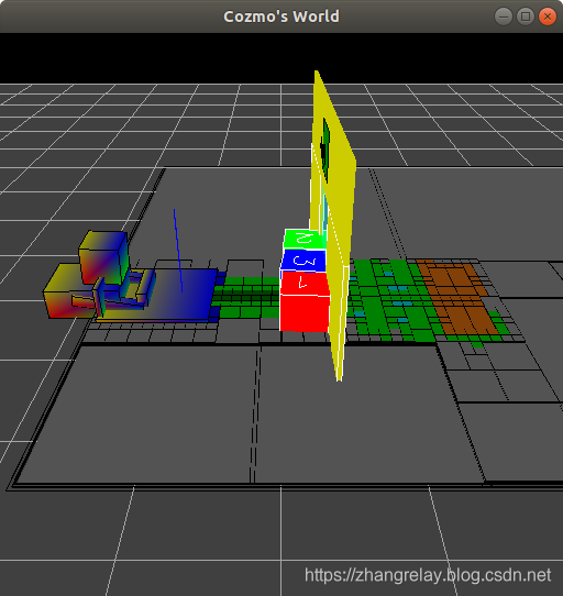

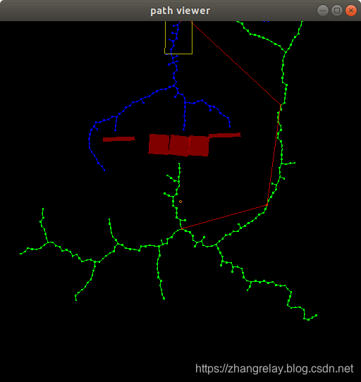

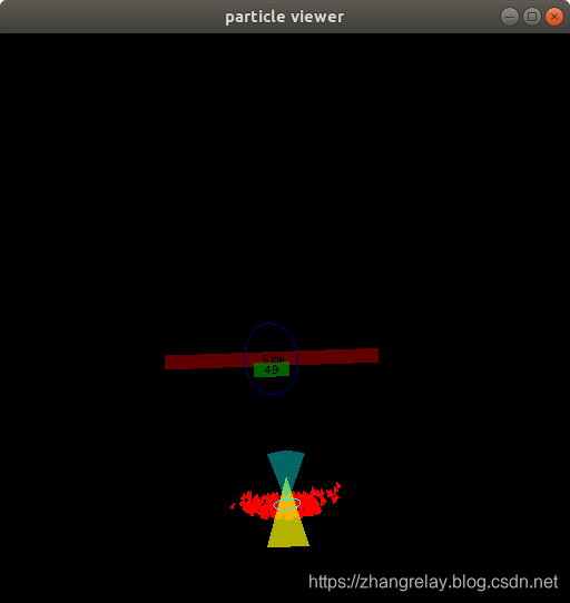

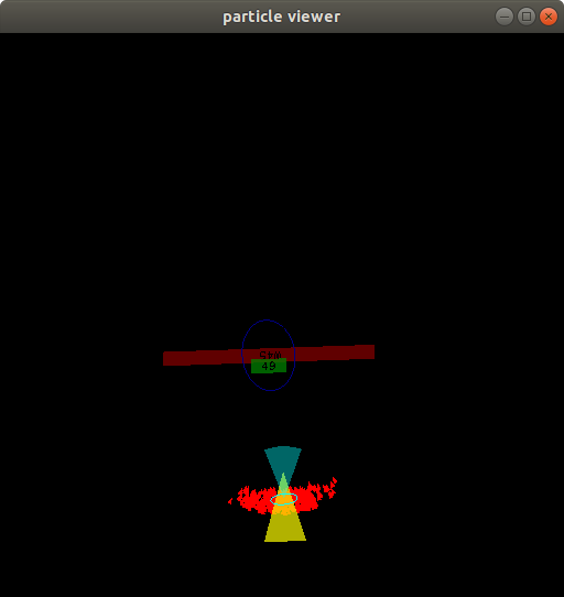

路径规划中。Path planning.
终点处各窗口信息如上。The information of each window at the end point is as above.
