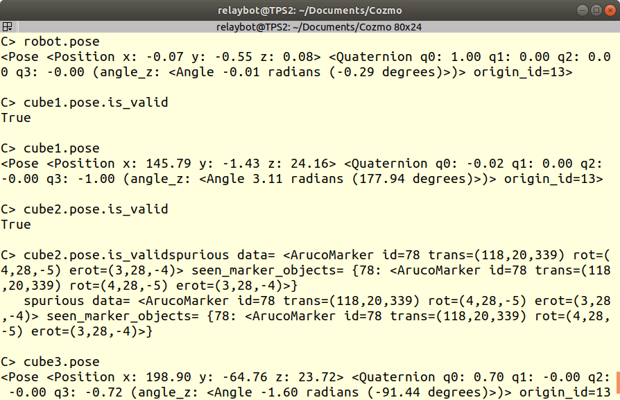

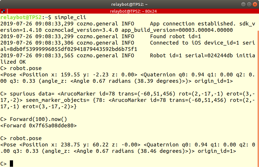

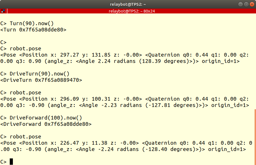

机器人前进或转向后,位置的变化数据。The change in position and orientation data is output after the robot moves forward or turns.

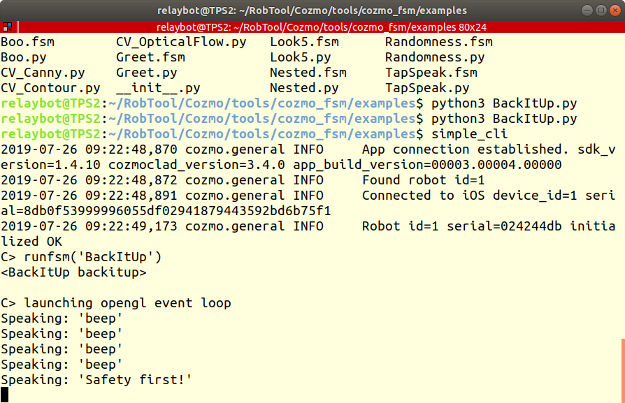

案例 demo:
  1. """
  2. The BackItUp demo illustrates the use of fork/join to launch
  3. parallel actions and synchronize them again. The fork is performed
  4. by the NullTrans transition with two destinations, while the join is
  5. performed by the CompletionTrans transition with two sources.
  6. Behavior: Cozmo backs up by 100 mm while simultaneously beeping. He
  7. uses DriveForward instead of Forward to avoid conflict with the Say
  8. action. When he's done backing up, he stops beeping and says 'Safety first'.
  9. """
  10. try:
  11. from cozmo_fsm import *
  12. except ImportError:
  13. raise ImportError("Can't find the cozmo_fsm package. Check your search path.")
  14. class BackItUp(StateMachineProgram):
  15. def setup(self):
  16. """
  17. launcher: StateNode() =N=> {driver, speaker}
  18. driver: Forward(-100,10)
  19. speaker: Say('beep',duration_scalar=0.8,abort_on_stop=True) =C=> speaker
  20. {driver,speaker} =C=> finisher: Say('Safety first!')
  21. """
  22. # Code generated by genfsm on Thu Feb 16 23:51:48 2017:
  23. launcher = StateNode() .set_name("launcher") .set_parent(self)
  24. driver = Forward(-100,10) .set_name("driver") .set_parent(self)
  25. speaker = Say('beep',duration_scalar=0.8,abort_on_stop=True) .set_name("speaker") .set_parent(self)
  26. finisher = Say('Safety first!') .set_name("finisher") .set_parent(self)
  27. nulltrans1 = NullTrans() .set_name("nulltrans1")
  28. nulltrans1 .add_sources(launcher) .add_destinations(driver,speaker)
  29. completiontrans1 = CompletionTrans() .set_name("completiontrans1")
  30. completiontrans1 .add_sources(speaker) .add_destinations(speaker)
  31. completiontrans2 = CompletionTrans() .set_name("completiontrans2")
  32. completiontrans2 .add_sources(driver,speaker) .add_destinations(finisher)
  33. return self

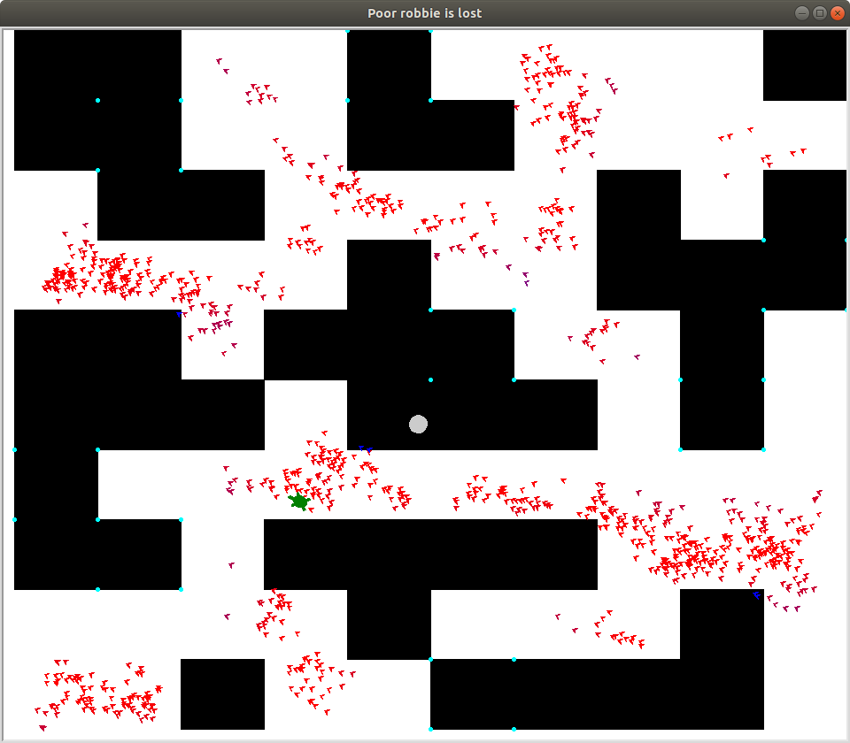

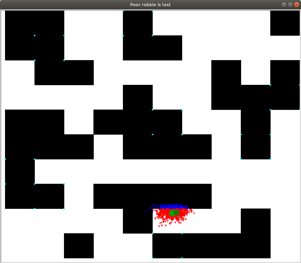

particle_fiter_demo:

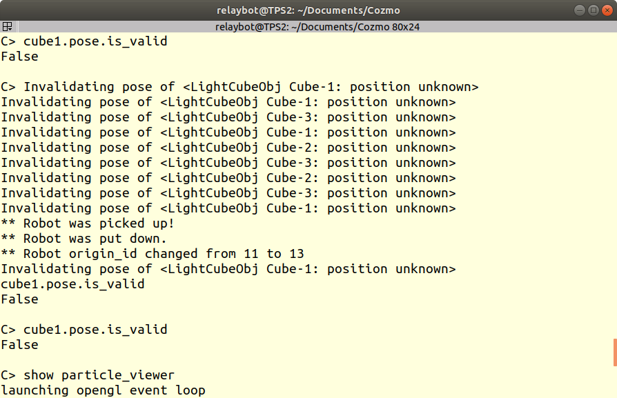

立方体 cube
