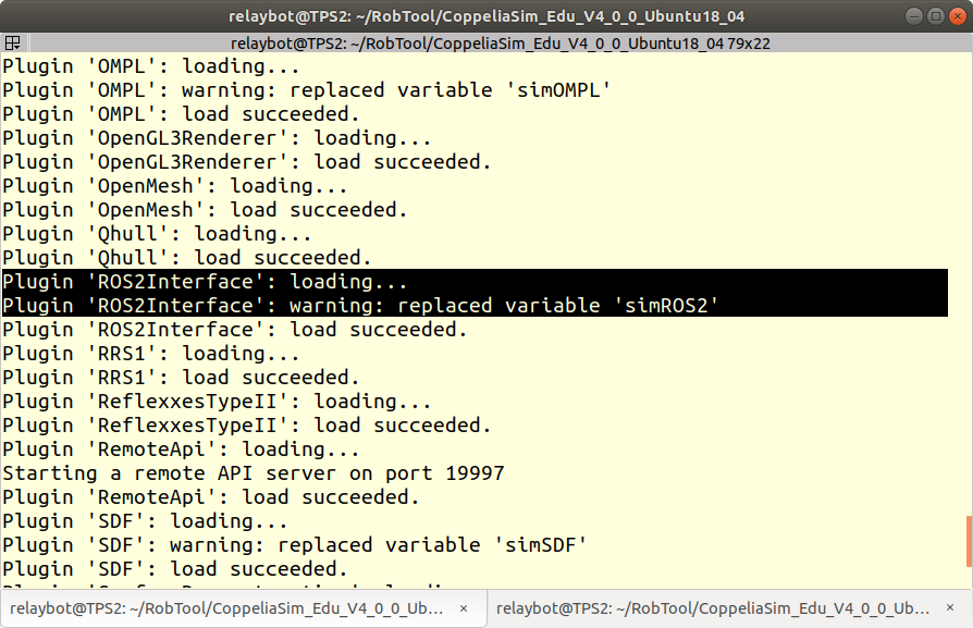

启动CoppeliaSim的指令如下:
$ ./coppeliaSim.sh
会发现如下接口启动,说明ROS 2接口一切正常。
 无需担心warning……

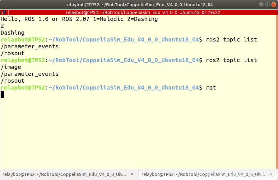

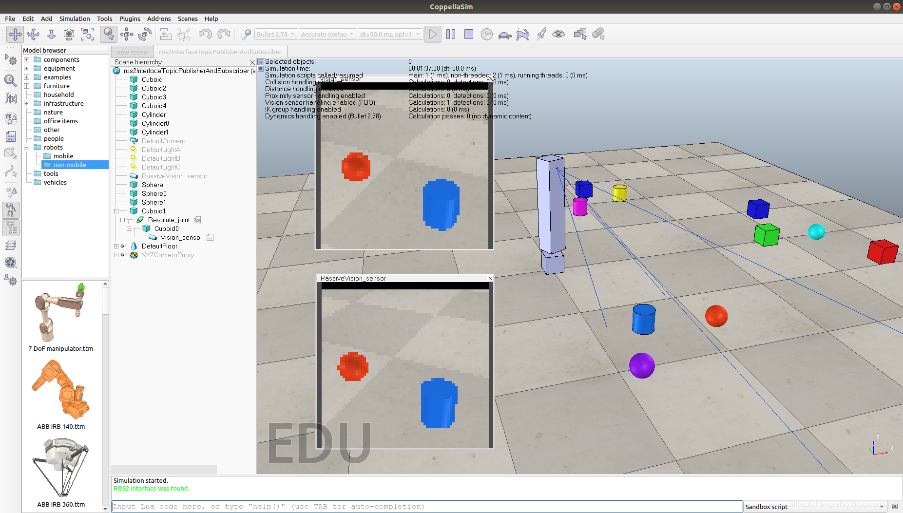

开启一个案例玩耍起来(ros2InterfaceTopicPublisherAndSubscriber.ttt):
使用终端查看一下消息:

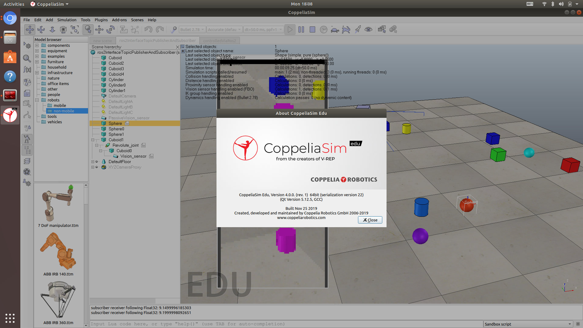

添加一个仿真时间:

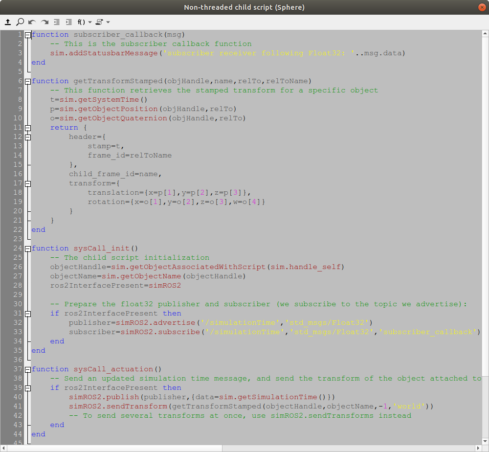

选择sphere,添加子代码如下:
      function subscriber_callback(msg)
       -- This is the subscriber callback function
       sim.addStatusbarMessage('subscriber receiver following Float32: '..msg.data)
      end
      function getTransformStamped(objHandle,name,relTo,relToName)
       -- This function retrieves the stamped transform for a specific object
       t=sim.getSystemTime()
       p=sim.getObjectPosition(objHandle,relTo)
       o=sim.getObjectQuaternion(objHandle,relTo)
      return {
       header={
       stamp=t,
       frame_id=relToName
       child_frame_id=name,
       transform={
       translation={x=p[1],y=p[2],z=p[3]},
       rotation={x=o[1],y=o[2],z=o[3],w=o[4]}
      end
      function sysCall_init()
       -- The child script initialization
       objectHandle=sim.getObjectAssociatedWithScript(sim.handle_self)
       objectName=sim.getObjectName(objectHandle)
       ros2InterfacePresent=simROS2
       -- Prepare the float32 publisher and subscriber (we subscribe to the topic we advertise):
      if ros2InterfacePresent then
       publisher=simROS2.advertise('/simulationTime','std_msgs/Float32')
       subscriber=simROS2.subscribe('/simulationTime','std_msgs/Float32','subscriber_callback')
       end
      end
      function sysCall_actuation()
       -- Send an updated simulation time message, and send the transform of the object attached to this script:
       simROS2.publish(publisher,{data=sim.getSimulationTime()})
       simROS2.sendTransform(getTransformStamped(objectHandle,objectName,-1,'world'))
       -- To send several transforms at once, use simROS2.sendTransforms instead
       end
      end
      function sysCall_cleanup()
       -- Following not really needed in a simulation script (i.e. automatically shut down at simulation end):
      if rosInterfacePresent then
       simROS.shutdownPublisher(publisher)
       simROS.shutdownSubscriber(subscriber)
       end
      end

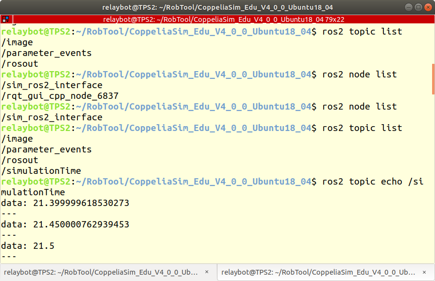

这时,可以使用:
$ ros2 topic echo /simulationTime
查看开启仿真的时间。

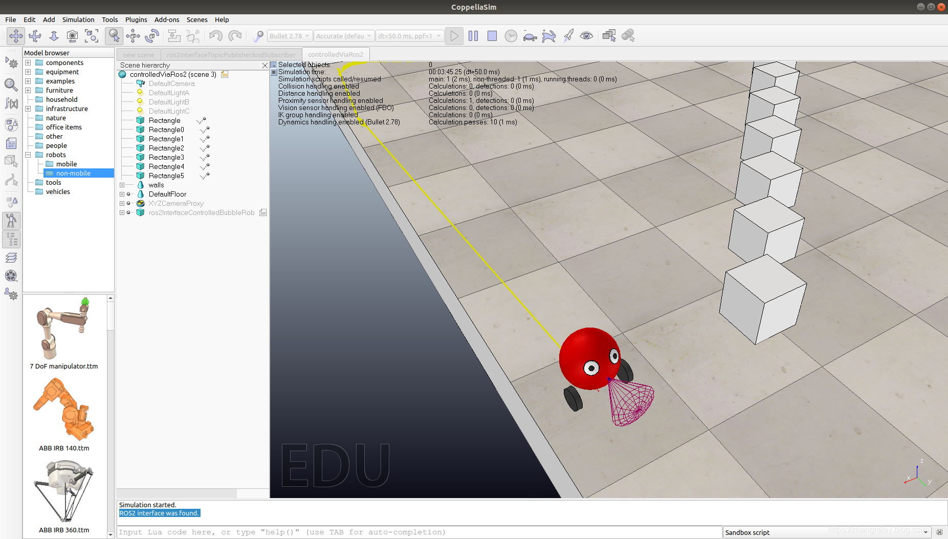

换一个案例(controlledViaRos2):

Now open a terminal, move to the CoppeliaSim installation folder and start CoppeliaSim. This is what you should have (or similar):
$ ./coppeliaSim.sh
Plugin 'ROS2Interface': loading...
Plugin 'ROS2Interface': load succeeded.

$ ros2 topic list
To see the message content, you can type:
Now load the demo scene ros2InterfaceTopicPublisherAndSubscriber.ttt, and run the simulation. The code in the child script attached to Vision_sensor will enable a publisher to stream the vision sensor's image, and also enable a subscriber to listen to that same stream. The subscriber applies the read data to the passive vision sensor, that is only used as a data container. So CoppeliaSim is streaming data, while listening to the same data! This is what is happening:
[Image publisher and image subscriber demo]

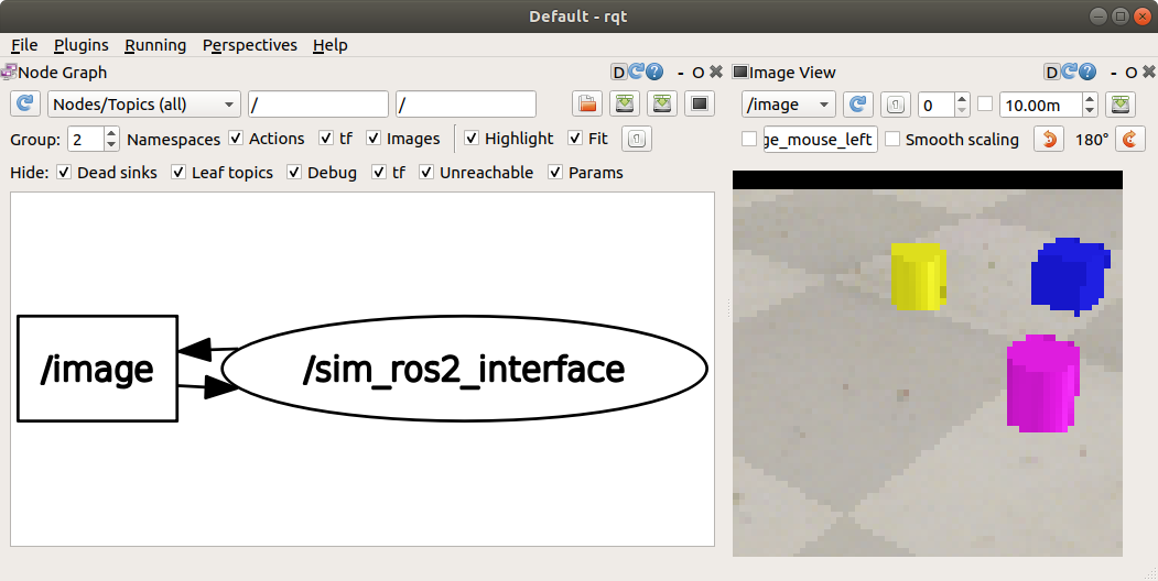

Try experimenting a little bit with the code. You can also visualize the image that CoppeliaSim streams with following command:
$ ros2 run image_view image_view image:=/visionSensorData
Had you been streaming simpler data, then you could also have visualized it with:
$ ros2 topic echo /visionSensorData
Now stop the simulation and load the demo scene controlTypeExamples/controlledViaRos2.ttt, and run the simulation. The robot is simplistic, and also behaving in a simplistic way for simplification purposes. It is controlled via the ROS2 Interface:
[External client application controlling the robot via ROS]
The child script attached to the robot, and running in a non-threaded fashion, is in charge of following:
  • determine some object handles (e.g. motor joint handles and proximity sensor handle)
  • verify if the ROS2 Interface is loaded
  • Launch motor speed subscribers
  • Launch a sensor publisher and a simulation time publisher
  • and finally launch a client application. The application is called with some topic names as arguments, so that it will know which topics to listen to and to subscribe. The client application (ros2BubbleRob) is then taking over the control of the robot via ROS 2.
While simulation is running, copy and paste a few times the robot. Notice that every copy is directly operational and independent. This is one of the many strengths of CoppeliaSim.

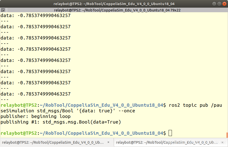

Have a look at the content of the customization script, that can be fully customized for various purposes. Try generating topic messages from the command line, for instance:
$ ros2 topic pub /startSimulation std_msgs/Bool '{data: true}' --once
$ ros2 topic pub /pauseSimulation std_msgs/Bool '{data: true}' --once
$ ros2 topic pub /stopSimulation std_msgs/Bool '{data: true}' --once
$ ros2 topic pub /enableSyncMode std_msgs/Bool '{data: true}' --once
$ ros2 topic pub /triggerNextStep std_msgs/Bool '{data: true}' --once
In order to display the current simulation time, you could type:
