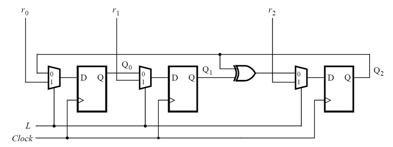

3 bit LFSR
Module Declaration
module top_module ( input [2:0] SW, // R input [1:0] KEY, // L and clk output [2:0] LEDR); // Q
下面对上面的电路进行设计:
首先,可以看出有三个类似的模块可以调用,那就描述出来这个子模块如下:
module sequential_com(
input clk,
input in1,
input in0,
input sel,
output q
wire in_sel;
assign in_sel = sel ? in1 : in0;
reg q_mid = 0;
always@(posedge clk) begin
q_mid <= in_sel;
end
assign q = q_mid;
endmodule
例化该子模块得到顶层设计:
module top_module (
sequential_com isnt0(
.clk(KEY[0]),
.in1(SW[0]),
.in0(LEDR[2]),
.sel(KEY[1]),
.q(LEDR[0])
sequential_com isnt1(
.clk(KEY[0]),
.in1(SW[1]),
.in0(LEDR[0]),
.sel(KEY[1]),
.q(LEDR[1])
sequential_com isnt2(
.clk(KEY[0]),
.in1(SW[2]),
.in0(LEDR[1]^LEDR[2]),
.sel(KEY[1]),
.q(LEDR[2])
endmodule
