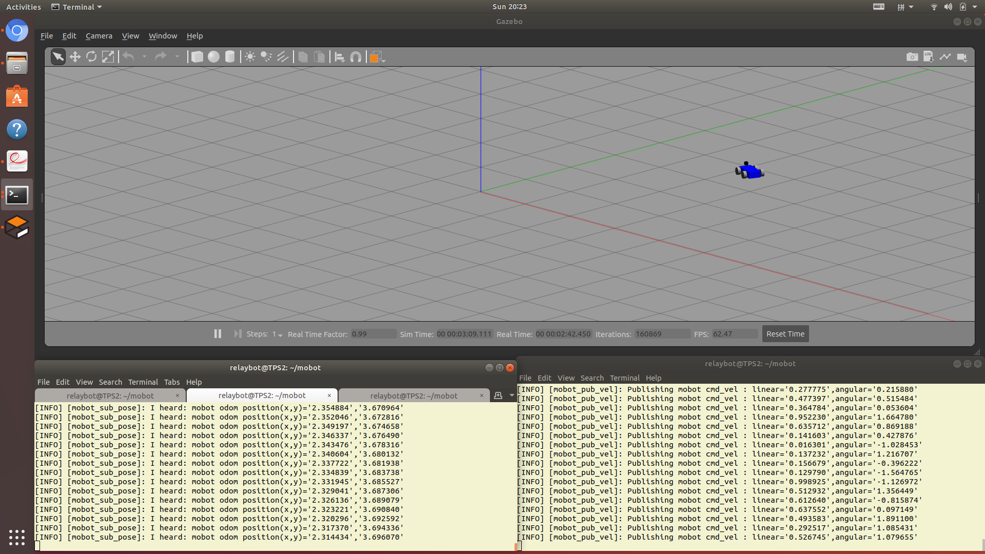

实现效果参考如下视频:
ROS2和Gazebo9中mobot速度发布和坐标订阅

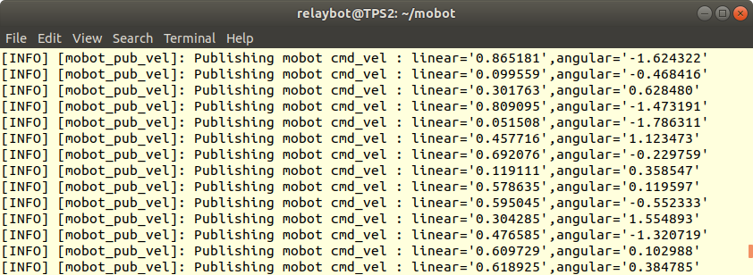

pubvel.cpp
#include <iostream>
#include <chrono>
#include "rclcpp/rclcpp.hpp"
#include "geometry_msgs/msg/twist.hpp"
using namespace std::chrono_literals;
int main(int argc, char * argv[])
rclcpp::init(argc, argv);
auto node = rclcpp::Node::make_shared("publish_velocity");
auto publisher = node->create_publisher<geometry_msgs::msg::Twist>("/turtle1/cmd_vel", 10);
geometry_msgs::msg::Twist message;
rclcpp::WallRate loop_rate(500ms);
while (rclcpp::ok()) {
message.linear.x = ((double)rand()/(RAND_MAX));
message.angular.z = 4.0*((double)rand()/(RAND_MAX))-2;
RCLCPP_INFO(node->get_logger(), "Publishing /turtle1/cmd_vel : linear='%f',angular='%f'", message.linear.x, message.angular.z);
publisher->publish(message);
rclcpp::spin_some(node);
loop_rate.sleep();
rclcpp::shutdown();
return 0;
这样等于速度发布直接给答案了……

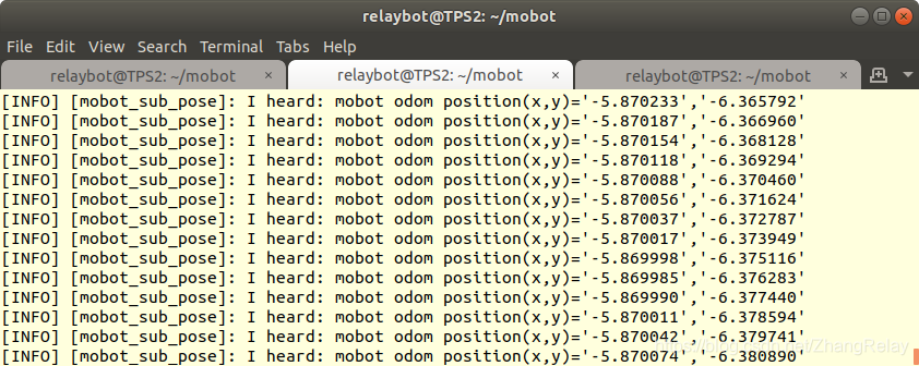

mobot实现此功能订阅里程计位置姿态信息,请参考提示。
然后需要修改一下CMakeLists.txt,在合适位置增加如下代码:
add_executable(pub_vel src/pub_vel.cpp)
ament_target_dependencies(pub_vel rclcpp geometry_msgs)
add_executable(sub_pose src/sub_pose.cpp)
ament_target_dependencies(sub_pose rclcpp nav_msgs)
install(TARGETS
pub_vel
sub_pose
DESTINATION lib/${PROJECT_NAME})
然后编译并运行如下命令即可,分别在不同的终端哦。
- ros2 launch mobot topic.launch.py
如何编写launch,参考之前章节。
- ros2 run mobot sub_pose
- ros2 run mobot pub_vel
当然也可以在launch中将pub_vel和sub_pose添加,这样就无需新开窗口了,如何实现?
