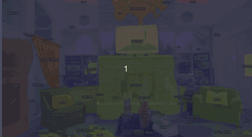

具体参考链接:https://discourse.ros.org/t/new-robust-pre-trained-semantic-segmentation-models-cvpr-20/15607

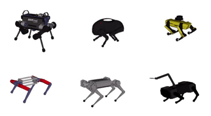

具体参考链接:https://discourse.ros.org/t/quadruped-robot-controller/15625

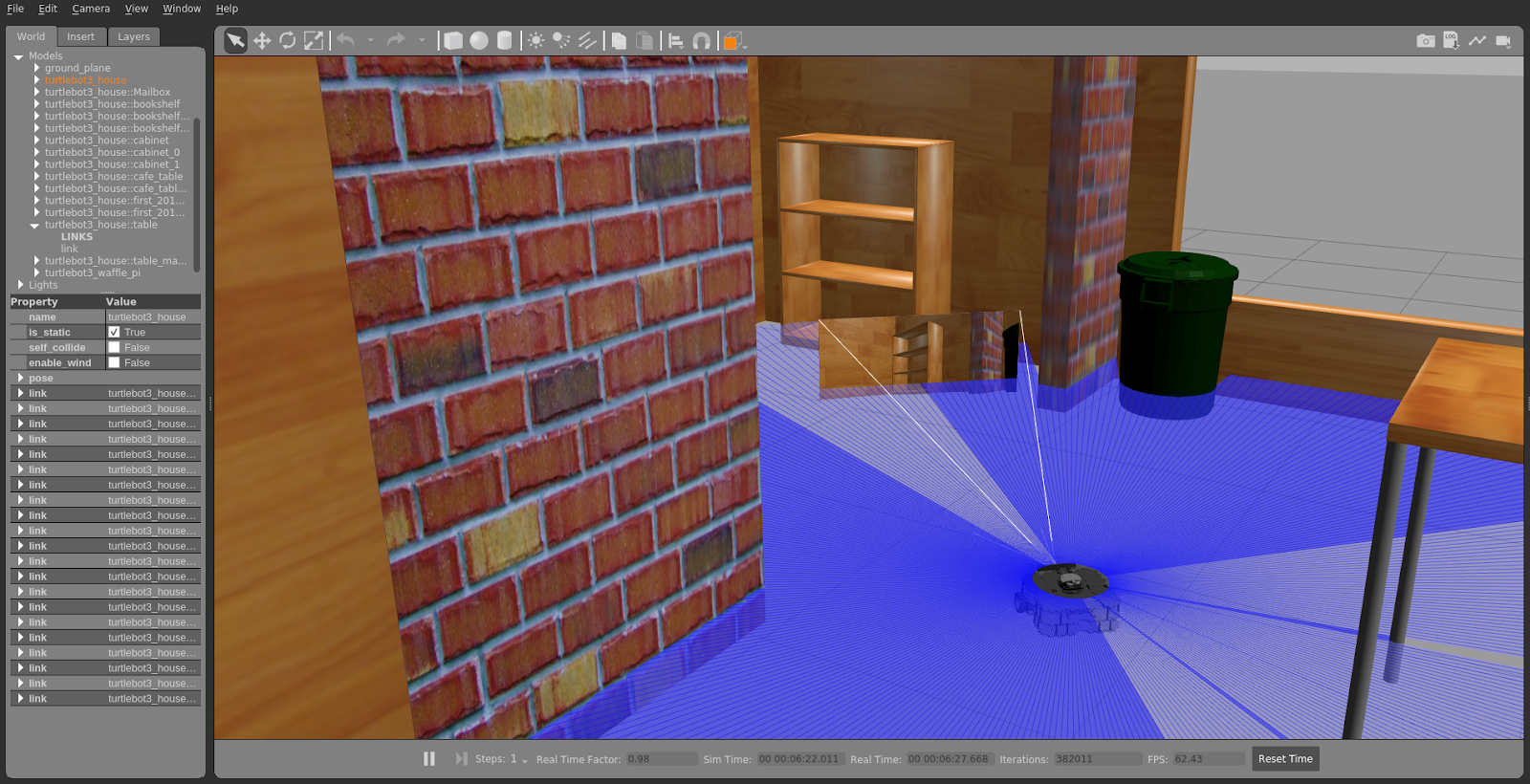

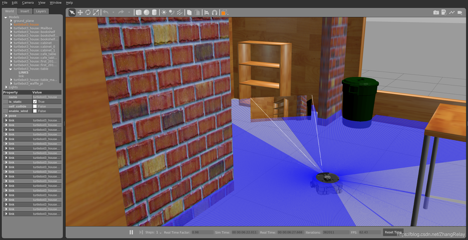

具体参考链接:https://ubuntu.com/blog/simulate-the-turtlebot3

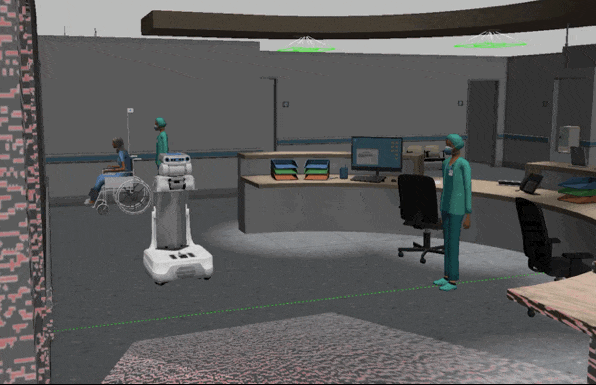

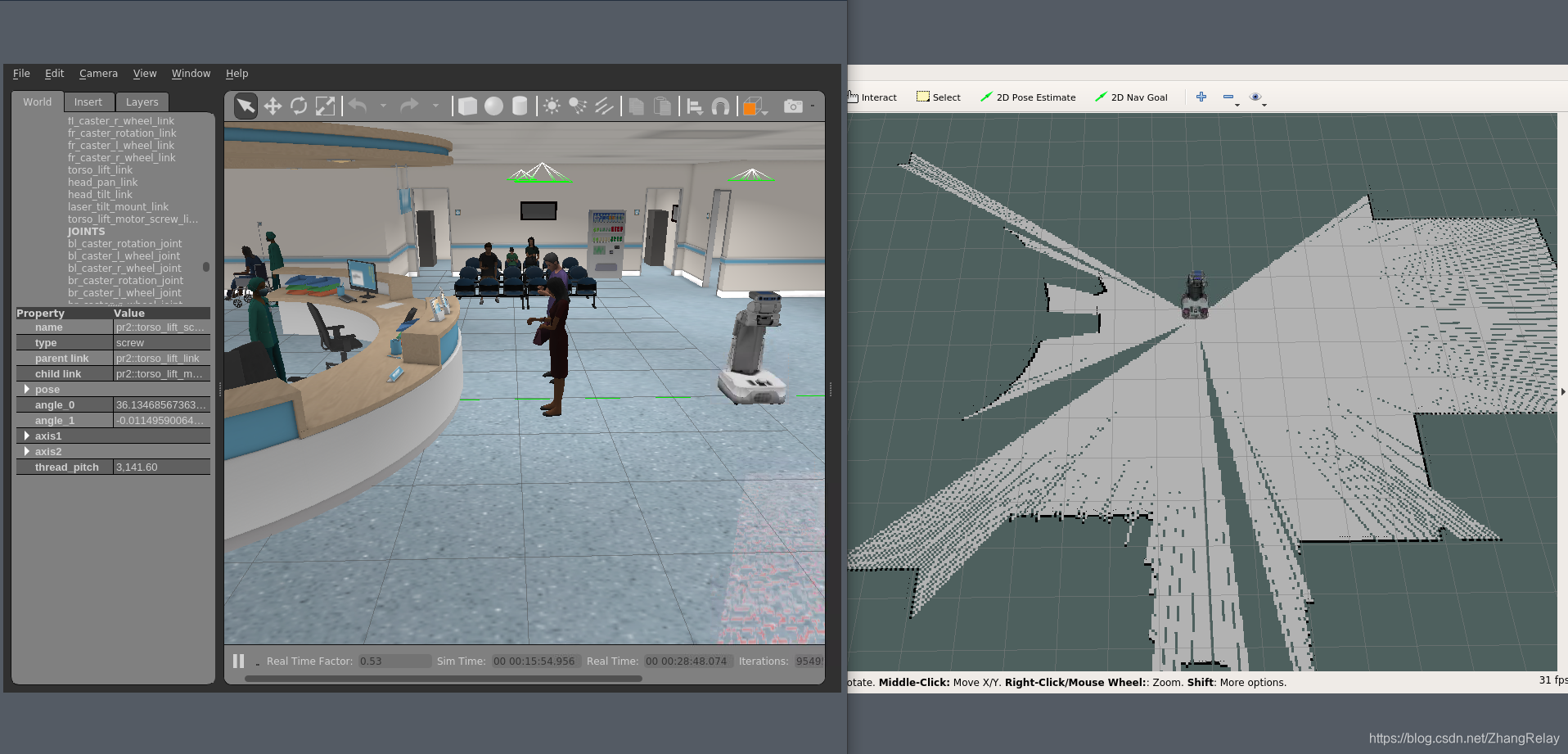

具体参考链接:https://github.com/aws-samples/aws-robomaker-sample-application-pr2-hospital
