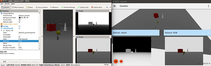

可以在https://github.com/ignitionrobotics/ros_ign中找到集成包。尝试例如:
      sudo apt install ros-foxy-ros-ign
      . /opt/ros/foxy/setup.sh
      ros2 launch ros_ign_gazebo_demos rgbd_camera_bridge.launch.py
