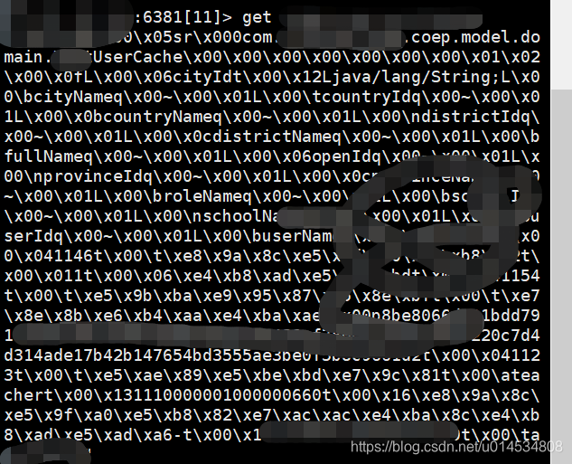

 private static RedisSerializer<Object> jdkRedisSerializer = new JdkSerializationRedisSerializer(); private static RedisSerializer<String> stringRedisSerializer = new StringRedisSerializer();
public boolean set(final String key, final Object obj, final long seconds) { // key的组织形式 namespace:id:parmeter strRedisTemplate.execute((RedisCallback<Serializable>) connection -> { final byte[] keyBytes = stringRedisSerializer.serialize(key); final byte[] name = jdkRedisSerializer.serialize(obj); connection.setEx(keyBytes, seconds, name); return null; }); return true; } @Override public Serializable get(final Serializable key) { return strRedisTemplate.execute((RedisCallback<Serializable>) connection -> { byte[] keyBytes = stringRedisSerializer.serialize( key); byte[] bytes = connection.get(keyBytes); return (Serializable) jdkRedisSerializer.deserialize(bytes); }); }
这里设置键值时,对key使用的是StringRedisSerializer进行序列化,对value使用的是JdkSerializationRedisSerializer进行序列化。序列化后的数据类型是二进制的字节码文件,可视性差。而且使用JdkSerializationRedisSerializer序列化性能比较差,所以不推荐使用。
