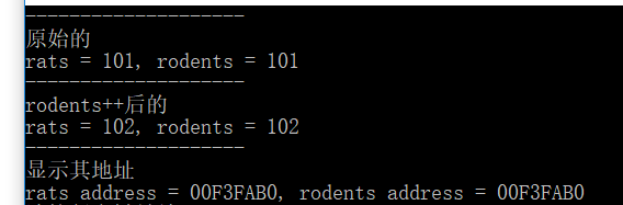

引用变量的程序示例
  1. //firstref.cpp -- defining and using a reference
  2. //引用
  3. #include<iostream>
  4. int main()
  5. {
  6. using namespace std;
  7. int rats = 101;
  8. int & rodents = rats;//rodents这里是rats的引用
  9. cout << "--------------------" << endl;
  10. cout << "原始的" << endl;
  11. cout << "rats = " << rats;
  12. cout << ", rodents = " << rodents << endl;
  13. cout << "--------------------" << endl;
  14. cout << "rodents++后的" << endl;
  15. rodents++;
  16. cout << "rats = " << rats;
  17. cout << ", rodents = " << rodents << endl;
  18. cout << "--------------------" << endl;
  19. cout << "显示其地址" << endl;
  20. cout << "rats address = " << &rats;
  21. cout << ", rodents address = " << &rodents << endl;
  22. return 0;
  23. }
程序运行结果

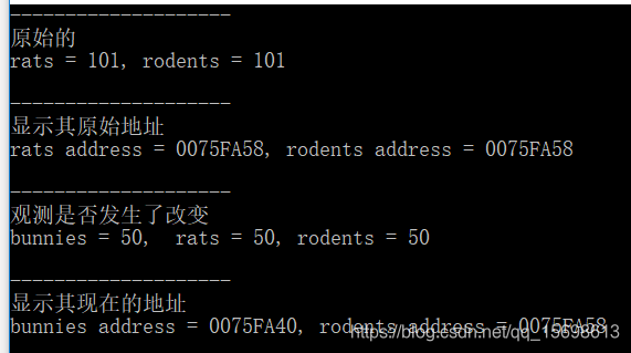

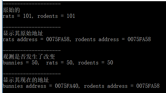

试图将变量的引用改变的程序示例
  1. // secref.cpp -- defining and using a reference
  2. #include<iostream>
  3. int main()
  4. {
  5. using namespace std;
  6. int rats = 101;
  7. int & rodents = rats; //引用
  9. cout << "原始的" << endl;
  10. cout << "rats = " << rats;
  11. cout << ", rodents = " << rodents << endl << endl;
  12. cout << "--------------------" << endl;
  13. cout << "显示其原始地址" << endl;
  14. cout << "rats address = " << &rats;
  15. cout << ", rodents address = " << &rodents << endl << endl;
  16. int bunnies = 50;
  17. rodents = bunnies;//这里可以改变引用吗?
  19. cout << "观测是否发生了改变" << endl;
  20. cout << "bunnies = " << bunnies;
  21. cout << ", rats = " << rats;
  22. cout << ", rodents = " << rodents << endl << endl;
  23. cout << "--------------------" << endl;
  24. cout << "显示其现在的地址" << endl;
  25. cout << "bunnies address = " << &bunnies;
  26. cout << ", rodents address = " << &rodents << endl << endl;
  27. return 0;
  28. }
咋一看,改变成功了,但是发现bunnies地址与rats和rodents的地址并不同,这是因为上述语句等效于:
rats = bunnies;
也就意味着可以通过初始化声明来设置引用,但不能通过赋值来设置。
