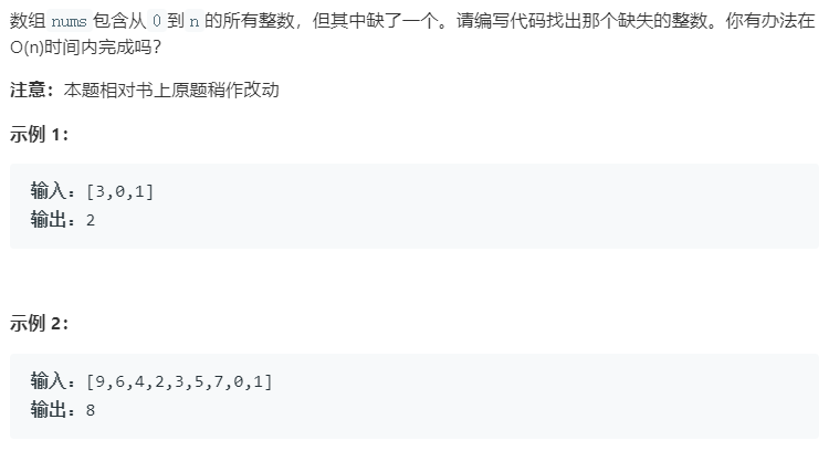

第2题:消失的数字
试题要求如下:
回答(C语言):
int missingNumber(int* nums, int numsSize){
int i=0;
int* data_buf=(int*)malloc(sizeof(int)*(numsSize+1));
memset(data_buf,0,sizeof(int)*(numsSize+1));
for(i=0;i<numsSize;i++){
data_buf[nums[i]]++;
if(data_buf[i]==0){
break;
data_buf[numsSize]='\0';
return i;
运行效率如下所示:

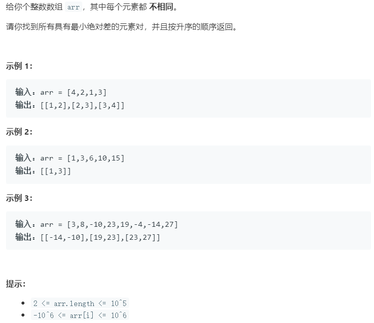

第3题:最小绝对差
试题要求如下:
回答(C语言):
* Return an array of arrays of size *returnSize.
* The sizes of the arrays are returned as *returnColumnSizes array.
* Note: Both returned array and *columnSizes array must be malloced, assume caller calls free().
int cmp(const void* num, const void* num2){
return *(int*)num - *(int*)num2;
int** minimumAbsDifference(int* arr, int arrSize, int* returnSize, int** returnColumnSizes){
qsort(arr,arrSize,sizeof(int),cmp);
int **returnarra = malloc(sizeof(int*)*arrSize), count = 0;
int *ColumnSizes = (int*)malloc(sizeof(int)* arrSize);
assert(returnarra!=NULL && ColumnSizes!=NULL);
int different, min = abs(arr[0]-arr[arrSize-1]);
for(int i = 1; i < arrSize;i++){
if((different = abs(arr[i] - arr[i-1])) < min){
min = different;
for(int i = 1; i < arrSize; i++){
different = abs(arr[i] - arr[i-1]);
if(different == min){
int *pair = malloc(sizeof(int) * 2);
pair[0] = arr[i-1];
pair[1] = arr[i];
returnarra[count] =pair;
ColumnSizes[count++] = 2;
*returnSize = count;
*returnColumnSizes = ColumnSizes;
return returnarra;
运行效率如下所示:

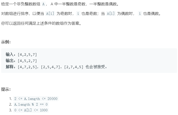

第4题:按奇偶排序数组II
试题要求如下:
回答(C语言):
* Note: The returned array must be malloced, assume caller calls free().
int* sortArrayByParityII(int* A, int ASize, int* returnSize){
//int* arr = (int*)malloc(sizeof(int) * ASize);
*returnSize = ASize;
int odd = 1;
for (int i = 0; i < ASize; i += 2) {
if (A[i] % 2 != 0) {
while (A[odd] % 2 == 1) {
odd += 2;
int tmp = A[odd];
A[odd] = A[i];
A[i] = tmp;
return A;
运行效率如下所示:

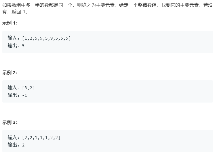

第5题:主要元素
试题要求如下:
回答(C语言):
int majorityElement(int* nums, int numsSize){
int cur;
int counter = 0;
for (int i = 0; i < numsSize; i++) {
if (counter == 0) {
counter = 1;
cur = nums[i];
} else if (cur != nums[i]) {
counter--;
} else {
counter++;
if(counter > 0)
return cur;
else
return -1;
运行效率如下所示:

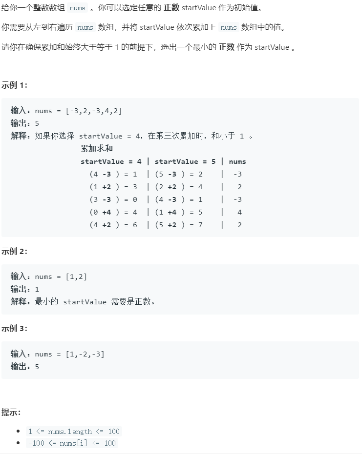

第6题:逐步求和得到正数的最小值
试题要求如下:
回答(C语言):
int minStartValue(int* nums, int numsSize)
int min = nums[0], count = 0;
for (int i = 0; i < numsSize; i ++)
count += nums[i];
min = min < count ? min : count;
min = 1 - min;
return min > 0 ? min : 1;
运行效率如下所示:

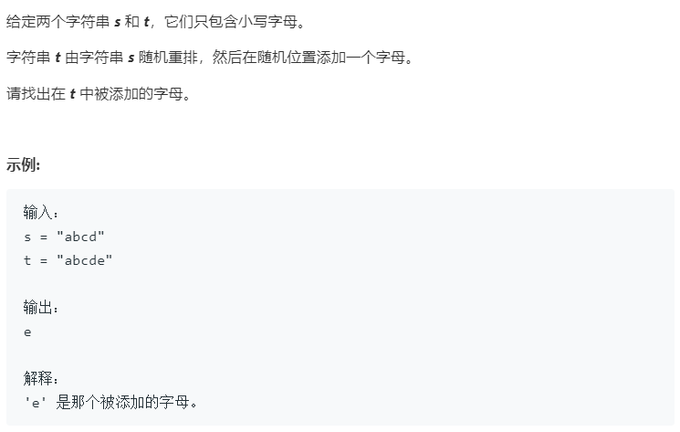

第7题:找不同
试题要求如下:
回答(C语言):
char findTheDifference(char * s, char * t){
int sum_s = 0,sum_t = 0;
for(int i = 0;i < strlen(t);i++){
if(i < strlen(t)-1){
sum_s +=s[i];
sum_t +=t[i];
return sum_t-sum_s;
运行效率如下所示:

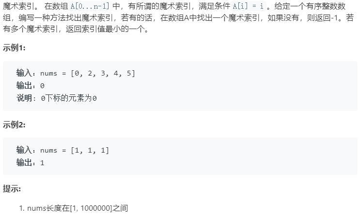

第8题:魔术索引
试题要求如下:
回答(C语言):
int findMagicIndex(int* nums, int numsSize){
for(int i = 0;i < numsSize;i++){
if(nums[i] == i){
return i;
return -1;
运行效率如下所示:

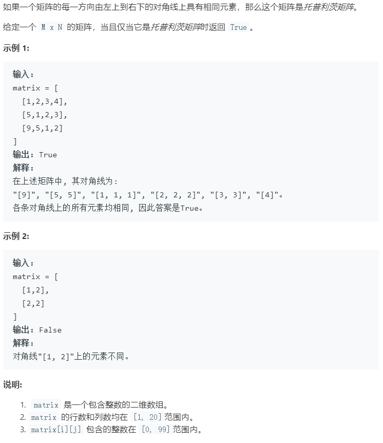

第9题:托普利茨矩阵
试题要求如下:
回答(C语言):
//(r1, c1) (r2, c2)满足对角线的特点 r1 - c1 == r2 - c2
bool isToeplitzMatrix(int** matrix, int matrixSize, int* matrixColSize){
for(int i = 1;i < matrixSize;++i)
for(int j = 1;j < matrixColSize[0];++j)
if(matrix[i-1][j-1] != matrix[i][j])
return false;
return true;
运行效率如下所示:

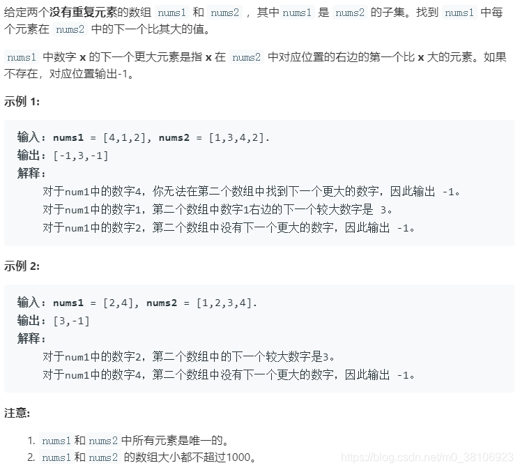

第10题:下一个更大元素1
试题要求如下:
回答(C语言):
int* nextGreaterElement(int* nums1, int nums1Size, int* nums2, int nums2Size, int* returnSize){
int* res = (int*)malloc(sizeof(int) * nums1Size);
int flag = 0;
int i,j;
for(i = 0; i < nums1Size; i++) {
for(j = 0; j < nums2Size; j++) {
if(nums1[i] == nums2[j]) {
flag = 1;
continue;
else if(nums1[i] < nums2[j] && flag == 1) {
res[i] = nums2[j];
break;
if(j == nums2Size) {
res[i] = -1;
flag = 0;
*returnSize = nums1Size;
return res;
运行效率如下所示:
