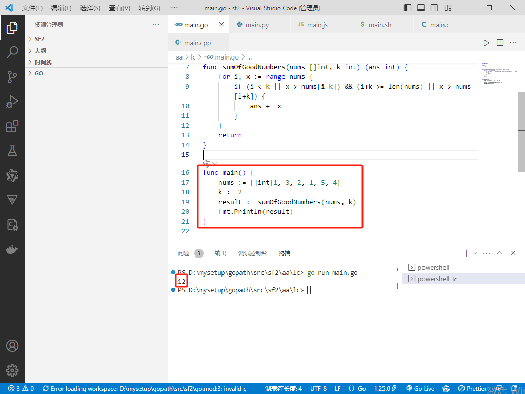

Go完整代码如下:
package main
import (
	"fmt"
func sumOfGoodNumbers(nums []int, k int) (ans int) {
	for i, x := range nums {
		if (i < k || x > nums[i-k]) && (i+k >= len(nums) || x > nums[i+k]) {
			ans += x
	return
func main() {
	nums := []int{1, 3, 2, 1, 5, 4}
	k := 2
	result := sumOfGoodNumbers(nums, k)
	fmt.Println(result)

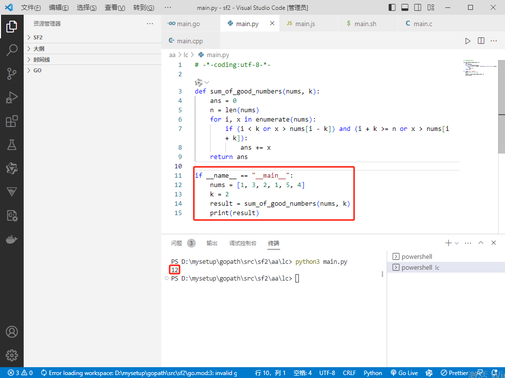

Python完整代码如下:
# -*-coding:utf-8-*-
def sum_of_good_numbers(nums, k):
    ans = 0
    n = len(nums)
    for i, x in enumerate(nums):
        if (i < k or x > nums[i - k]) and (i + k >= n or x > nums[i + k]):
            ans += x
    return ans
if __name__ == "__main__":
    nums = [1, 3, 2, 1, 5, 4]
    k = 2
    result = sum_of_good_numbers(nums, k)
    print(result)
