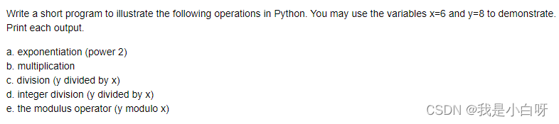

第二题
def basic_opp(x,y):
    # a. exponentiation (power 2)
    print(x**2)
    # b. multiplication
    print(x*y)
    # c. division (y divided by x)
    print(round(y/x,2)) # this rounds the resulting value to two decimal places
    # d. integer division (y divided by x)
    print(y//x)
    # e. the modulus operator (y modulo x)
    print(y%x)
# set some sample values
a=6
b=8
# run the program
basic_opp(a,b)

预期输出:
36
48
1.33
2

第二题 (答案)
def basic_opp(x,y):
    print(x**2)
    # b. multiplication
    print(x*y)
    print(y//x)
    print(y%x)
a=6
b=8
# run the program
basic_opp(a,b)
