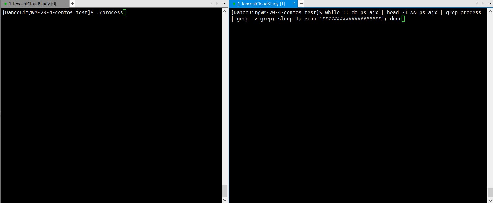

💨运行结果:
  监控脚本:while :; do ps ajx | head -1 && ps ajx | grep process | grep -v grep; sleep 1; echo "####################"; done
请添加图片描述

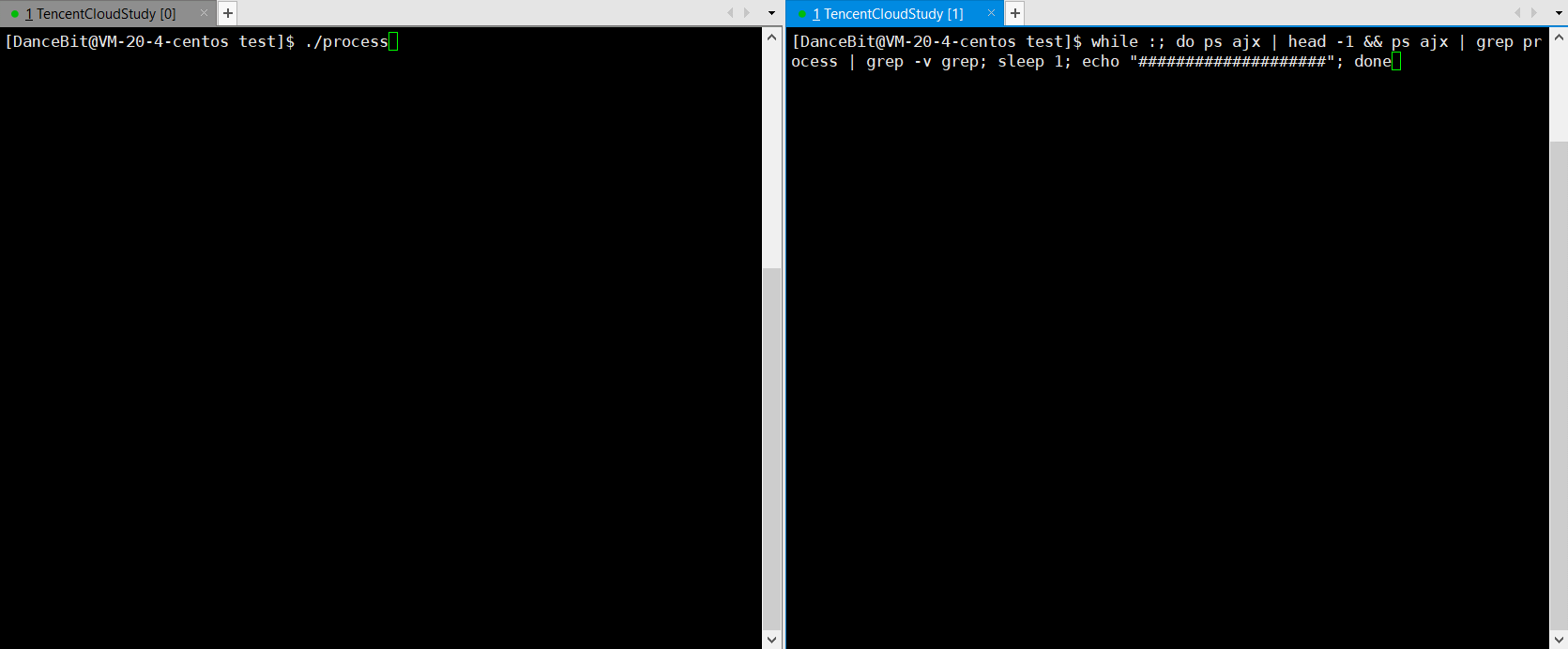

✔ 测试用例三:
fork 5 个子进程后,父进程依次等待,并回收僵尸进程。

    for(i = 0; i < 5; i++)
        printf("father is waiting...\n");
        sleep(10);
        pid_t ret = wait(NULL);
        printf("father is wait done, ret: %d\n", ret);
        sleep(3);
        printf("father quit...\n");
    return 0;
💨运行结果:
请添加图片描述
