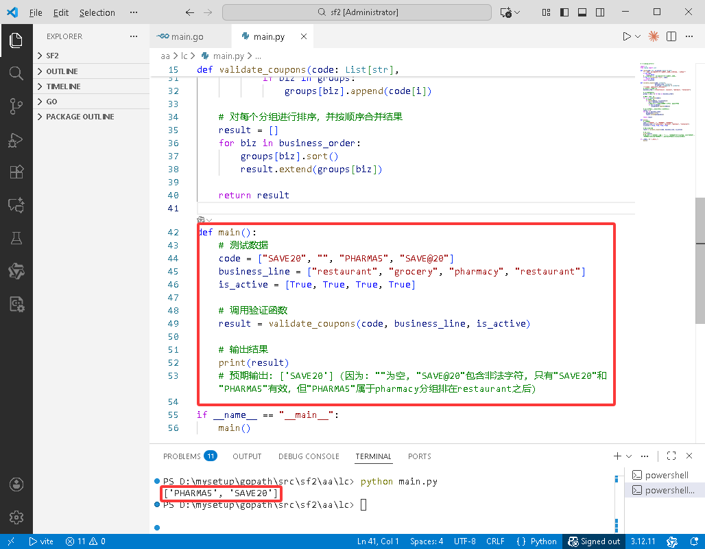

Python完整代码如下:
# -*-coding:utf-8-*-
import re
from typing import List
def check(code: str, is_active: bool) -> bool:
    """检查优惠码是否只包含字母、数字和下划线,并且处于激活状态"""
    if not code:
        return False
    # 使用正则表达式检查是否只包含字母、数字和下划线
    if not re.fullmatch(r'[\w]+', code):
        return False
    return is_active
def validate_coupons(code: List[str],
                     business_line: List[str],
                     is_active: List[bool]) -> List[str]:
    """验证优惠码并按业务线分类排序"""
    # 定义业务线分组顺序
    business_order = ["electronics", "grocery", "pharmacy", "restaurant"]
    # 初始化分组字典
    groups = {biz: [] for biz in business_order}
    # 遍历所有优惠码
    for i in range(len(code)):
        # 验证优惠码
        if check(code[i], is_active[i]):
            biz = business_line[i]
            # 如果业务线在预定义列表中,则添加到对应分组
            if biz in groups:
                groups[biz].append(code[i])
    # 对每个分组进行排序,并按顺序合并结果
    result = []
    for biz in business_order:
        groups[biz].sort()
        result.extend(groups[biz])
    return result
def main():
    # 测试数据
    code = ["SAVE20", "", "PHARMA5", "SAVE@20"]
    business_line = ["restaurant", "grocery", "pharmacy", "restaurant"]
    is_active = [True, True, True, True]
    # 调用验证函数
    result = validate_coupons(code, business_line, is_active)
    # 输出结果
    print(result)
    # 预期输出: ['SAVE20'] (因为: ""为空, "SAVE@20"包含非法字符, 只有"SAVE20"和"PHARMA5"有效,但"PHARMA5"属于pharmacy分组排在restaurant之后)
if __name__ == "__main__":
    main()

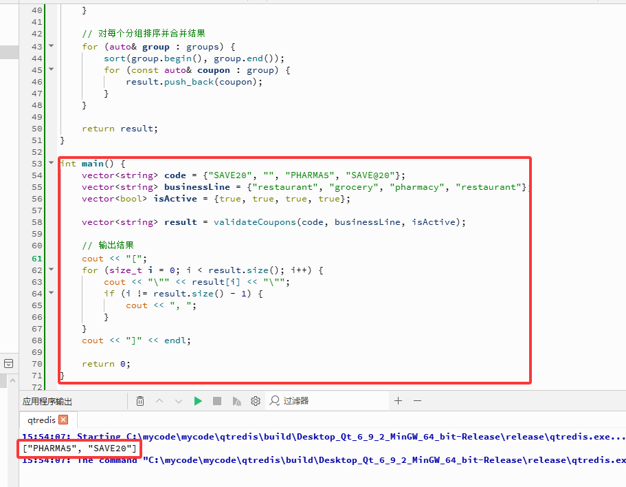

C++完整代码如下:
#include <iostream>
#include <vector>
#include <string>
#include <algorithm>
#include <cctype>
using namespace std;
bool check(const string& code, bool isActive) {
    // 检查优惠码是否只包含字母、数字和下划线
    for (char c : code) {
        if (c != '_' && !isalnum(c)) {
            return false;
    return isActive;
vector<string> validateCoupons(const vector<string>& code,
                               const vector<string>& businessLine,
                               const vector<bool>& isActive) {
    // 初始化4个分组,对应electronics, grocery, pharmacy, restaurant
    vector<vector<string>> groups(4);
    vector<string> result;
    for (size_t i = 0; i < code.size(); i++) {
        // 验证优惠码
        if (!code[i].empty() && check(code[i], isActive[i])) {
            // 根据业务线添加到对应分组
            if (businessLine[i] == "electronics") {
                groups[0].push_back(code[i]);
            } else if (businessLine[i] == "grocery") {
                groups[1].push_back(code[i]);
            } else if (businessLine[i] == "pharmacy") {
                groups[2].push_back(code[i]);
            } else if (businessLine[i] == "restaurant") {
                groups[3].push_back(code[i]);
    // 对每个分组排序并合并结果
    for (auto& group : groups) {
        sort(group.begin(), group.end());
        for (const auto& coupon : group) {
            result.push_back(coupon);
    return result;
int main() {
    vector<string> code = {"SAVE20", "", "PHARMA5", "SAVE@20"};
    vector<string> businessLine = {"restaurant", "grocery", "pharmacy", "restaurant"};
    vector<bool> isActive = {true, true, true, true};
    vector<string> result = validateCoupons(code, businessLine, isActive);
    // 输出结果
    cout << "[";
    for (size_t i = 0; i < result.size(); i++) {
        cout << "\"" << result[i] << "\"";
        if (i != result.size() - 1) {
            cout << ", ";
    cout << "]" << endl;
    return 0;
