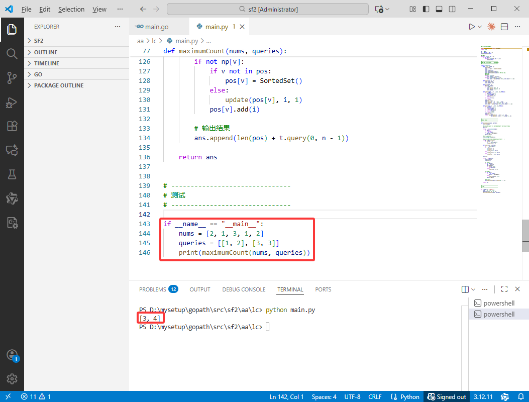

Python完整代码如下:
# -*-coding:utf-8-*-
from sortedcontainers import SortedSet
import math
mx = 10**5
np = [False] * (mx + 1)
np[0] = np[1] = True
# 质数筛
for i in range(2, mx + 1):
    if not np[i]:
        for j in range(i*i, mx + 1, i):
            np[j] = True
# 懒标记线段树:区间加 + 区间最大值
class LazySegTree:
    def __init__(self, a):
        n = len(a)
        size = 1 << (n - 1).bit_length()
        self.n = n
        self.size = size
        self.mx = [0] * (size * 2)
        self.todo = [0] * (size * 2)  # lazy tag
        # build
        # leaves
        for i in range(n):
            self.mx[size + i] = a[i]
        for i in range(size - 1, 0, -1):
            self.mx[i] = max(self.mx[i << 1], self.mx[i << 1 | 1])
    def apply(self, o, f):
        self.mx[o] += f
        self.todo[o] += f
    def push(self, o):
        f = self.todo[o]
        if f != 0:
            self.apply(o << 1, f)
            self.apply(o << 1 | 1, f)
            self.todo[o] = 0
    def update(self, l, r, f, o=1, L=0, R=None):
        if R is None:
            R = self.size - 1
        if l <= L and R <= r:
            self.apply(o, f)
            return
        if R < l or r < L:
            return
        self.push(o)
        mid = (L + R) // 2
        self.update(l, r, f, o << 1, L, mid)
        self.update(l, r, f, o << 1 | 1, mid + 1, R)
        self.mx[o] = max(self.mx[o << 1], self.mx[o << 1 | 1])
    def query(self, l, r, o=1, L=0, R=None):
        if R is None:
            R = self.size - 1
            return self.mx[o]
        if R < l or r < L:
            return -10**18
        self.push(o)
        mid = (L + R) // 2
        return max(self.query(l, r, o << 1, L, mid),
                   self.query(l, r, o << 1 | 1, mid + 1, R))
# main logic
def maximumCount(nums, queries):
    n = len(nums)
    # 每个质数值对应一个 SortedSet(模拟 red-black-tree)
    pos = {}
    for i, x in enumerate(nums):
        if np[x]:
            continue
        if x not in pos:
            pos[x] = SortedSet()
        pos[x].add(i)
    # 初始线段树,全 0
    t = LazySegTree([0] * n)
    # 对每个质数值,若出现两次以上,则区间加 1
    for ps in pos.values():
        if len(ps) > 1:
            l, r = ps[0], ps[-1]
            t.update(l, r, 1)
    def update(ps, i, delta):
        if l == r:
            L = min(l, i)
            R = max(r, i)
            t.update(L, R, delta)
        elif i < l:
            t.update(i, l - 1, delta)
        elif i > r:
            t.update(r + 1, i, delta)
    ans = []
    for i, v in queries:
        old = nums[i]
        nums[i] = v
        # 删除旧值
        if not np[old]:
            ps = pos[old]
            ps.remove(i)
            if len(ps) == 0:
                del pos[old]
            else:
                update(ps, i, -1)
        # 插入新值
        if not np[v]:
            if v not in pos:
                pos[v] = SortedSet()
            else:
                update(pos[v], i, 1)
            pos[v].add(i)
        # 输出结果
        ans.append(len(pos) + t.query(0, n - 1))
    return ans
# 测试
if __name__ == "__main__":
    nums = [2, 1, 3, 1, 2]
    queries = [[1, 2], [3, 3]]
    print(maximumCount(nums, queries))

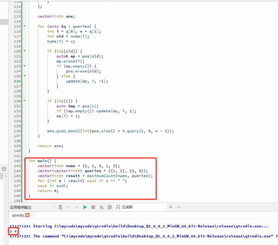

C++完整代码如下:
#include <bits/stdc++.h>
using namespace std;
const int MX = 100000;
bool np[MX + 1]; // 非质数标记
struct Node {
    int l, r;
    int mx;
    int todo;
struct LazySeg {
    vector<Node> t;
    int n;
    LazySeg(int n, int initVal) : n(n) {
        int size = 2 << (32 - __builtin_clz(n - 1));
        t.resize(size);
        vector<int> a(n, initVal);
        build(a, 1, 0, n - 1);
    void build(vector<int>& a, int o, int l, int r) {
        t[o].l = l; t[o].r = r;
        t[o].todo = 0;
        if (l == r) {
            t[o].mx = a[l];
            return;
        int m = (l + r) >> 1;
        build(a, o << 1, l, m);
        build(a, o << 1 | 1, m + 1, r);
        t[o].mx = max(t[o << 1].mx, t[o << 1 | 1].mx);
    void apply(int o, int f) {
        t[o].mx += f;
        t[o].todo += f;
    void spread(int o) {
        int f = t[o].todo;
        if (f == 0) return;
        apply(o << 1, f);
        apply(o << 1 | 1, f);
        t[o].todo = 0;
    void update(int o, int l, int r, int f) {
        if (l <= t[o].l && t[o].r <= r) {
            apply(o, f);
            return;
        spread(o);
        int m = (t[o].l + t[o].r) >> 1;
        if (l <= m) update(o << 1, l, r, f);
        if (m < r) update(o << 1 | 1, l, r, f);
    int query(int o, int l, int r) {
            return t[o].mx;
        spread(o);
        if (r <= m) return query(o << 1, l, r);
        if (l > m) return query(o << 1 | 1, l, r);
        return max(query(o << 1, l, r), query(o << 1 | 1, l, r));
vector<int> maximumCount(vector<int>& nums, vector<vector<int>>& queries) {
    int n = nums.size();
    unordered_map<int, map<int,int>> pos;
    for (int i = 0; i <= MX; i++) np[i] = false;
    np[0] = np[1] = true;
    for (int i = 2; i * i <= MX; i++)
        if (!np[i])
            for (int j = i * i; j <= MX; j += i)
                np[j] = true;
    for (int i = 0; i < n; i++) {
        int x = nums[i];
        if (!np[x]) pos[x][i] = 1;
    LazySeg t(n, 0);
    for (auto &p : pos) {

    vector<int> ans;
    for (auto &q : queries) {
        int i = q[0], v = q[1];
        int old = nums[i];
        nums[i] = v;
        if (!np[old]) {
            auto& mp = pos[old];
            mp.erase(i);
            if (mp.empty()) {
                pos.erase(old);
            } else {
                update(mp, i, -1);
        if (!np[v]) {
            auto &mp = pos[v];
            if (!mp.empty()) update(mp, i, 1);
            mp[i] = 1;
        ans.push_back((int)pos.size() + t.query(1, 0, n - 1));
    return ans;
int main() {
    vector<int> nums = {2, 1, 3, 1, 2};
    vector<vector<int>> queries = {{1, 2}, {3, 3}};
    vector<int> result = maximumCount(nums, queries);
    for (int x : result) cout << x << " ";
    cout << endl;
    return 0;
