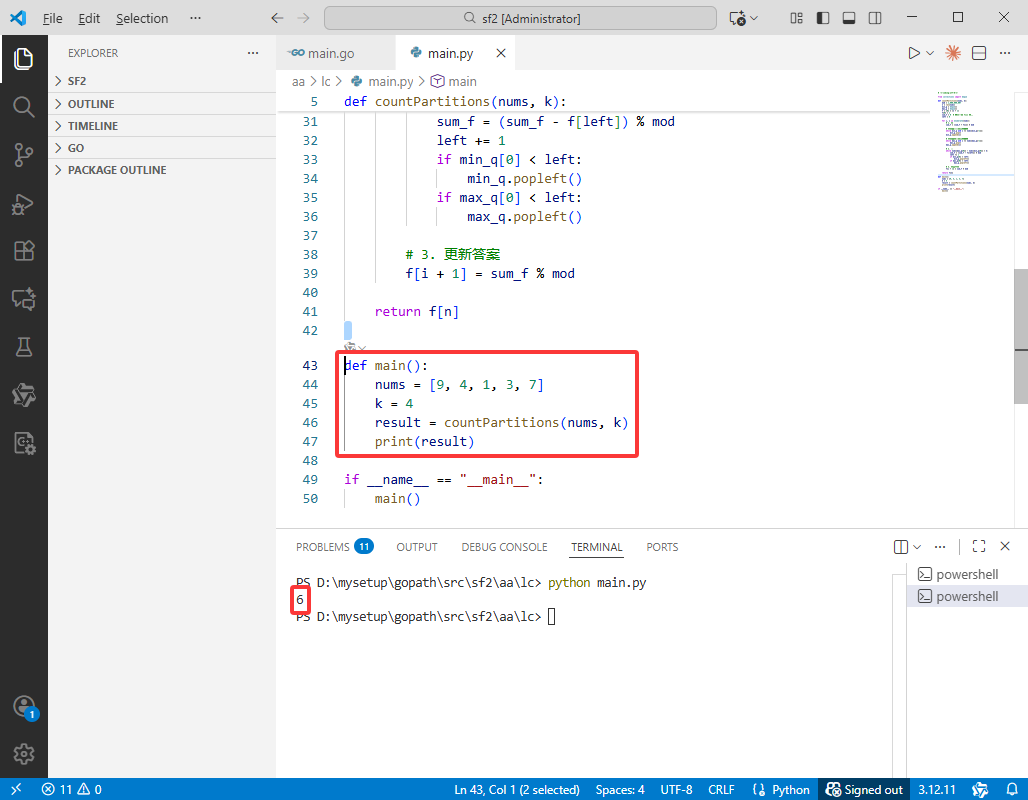

Python完整代码如下:
# -*-coding:utf-8-*-
from collections import deque
def countPartitions(nums, k):
    mod = 1_000_000_007
    n = len(nums)
    min_q = deque()
    max_q = deque()
    f = [0] * (n + 1)
    f[0] = 1
    sum_f = 0  # 窗口中的 f[i] 之和
    left = 0
    for i, x in enumerate(nums):
        # 1. 入
        sum_f = (sum_f + f[i]) % mod
        # 维护最小值的单调队列
        while min_q and x <= nums[min_q[-1]]:
            min_q.pop()
        min_q.append(i)
        # 维护最大值的单调队列
        while max_q and x >= nums[max_q[-1]]:
            max_q.pop()
        max_q.append(i)
        # 2. 出
        while nums[max_q[0]] - nums[min_q[0]] > k:
            sum_f = (sum_f - f[left]) % mod
            left += 1
            if min_q[0] < left:
                min_q.popleft()
            if max_q[0] < left:
                max_q.popleft()
        # 3. 更新答案
        f[i + 1] = sum_f % mod
    return f[n]
def main():
    nums = [9, 4, 1, 3, 7]
    k = 4
    result = countPartitions(nums, k)
    print(result)
if __name__ == "__main__":
    main()

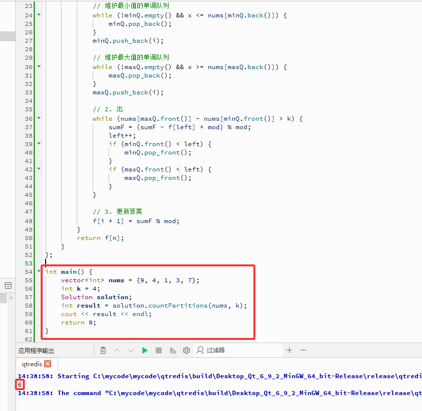

C++完整代码如下:
#include <iostream>
#include <vector>
#include <deque>
using namespace std;
class Solution {
public:
    int countPartitions(vector<int>& nums, int k) {
        const int mod = 1'000'000'007;
        int n = nums.size();
        deque<int> minQ, maxQ;
        vector<int> f(n + 1, 0);
        f[0] = 1;
        long long sumF = 0; // 窗口中的 f[i] 之和
        int left = 0;
        for (int i = 0; i < n; i++) {
            int x = nums[i];
            // 1. 入
            sumF = (sumF + f[i]) % mod;
            // 维护最小值的单调队列
            while (!minQ.empty() && x <= nums[minQ.back()]) {
                minQ.pop_back();
            minQ.push_back(i);
            // 维护最大值的单调队列
            while (!maxQ.empty() && x >= nums[maxQ.back()]) {
                maxQ.pop_back();
            maxQ.push_back(i);
            // 2. 出
            while (nums[maxQ.front()] - nums[minQ.front()] > k) {
                sumF = (sumF - f[left] + mod) % mod;
                left++;
                if (minQ.front() < left) {
                    minQ.pop_front();
                if (maxQ.front() < left) {
                    maxQ.pop_front();
            // 3. 更新答案
            f[i + 1] = sumF % mod;
        return f[n];
int main() {
    vector<int> nums = {9, 4, 1, 3, 7};
    int k = 4;
    Solution solution;
    int result = solution.countPartitions(nums, k);
    cout << result << endl;
    return 0;
