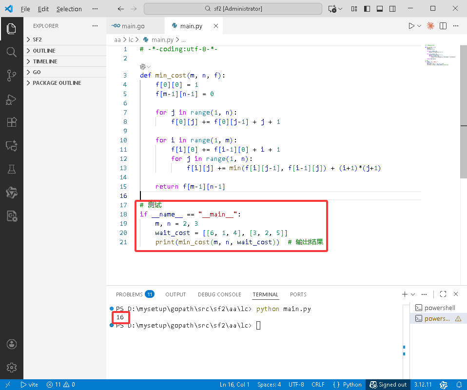

Python完整代码如下:
# -*-coding:utf-8-*-
def min_cost(m, n, f):
    f[0][0] = 1
    f[m-1][n-1] = 0
    for j in range(1, n):
        f[0][j] += f[0][j-1] + j + 1
    for i in range(1, m):
        f[i][0] += f[i-1][0] + i + 1
            f[i][j] += min(f[i][j-1], f[i-1][j]) + (i+1)*(j+1)
    return f[m-1][n-1]
# 测试
if __name__ == "__main__":
    m, n = 2, 3
    wait_cost = [[6, 1, 4], [3, 2, 5]]
    print(min_cost(m, n, wait_cost))  # 输出结果

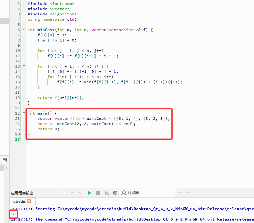

C++完整代码如下:
#include <iostream>
#include <vector>
#include <algorithm>
using namespace std;
int minCost(int m, int n, vector<vector<int>>& f) {
    f[0][0] = 1;
    f[m-1][n-1] = 0;
    for (int j = 1; j < n; j++)
        f[0][j] += f[0][j-1] + j + 1;
    for (int i = 1; i < m; i++) {
        f[i][0] += f[i-1][0] + i + 1;
            f[i][j] += min(f[i][j-1], f[i-1][j]) + (i+1)*(j+1);
    return f[m-1][n-1];
int main() {
    vector<vector<int>> waitCost = {{6, 1, 4}, {3, 2, 5}};
    cout << minCost(2, 3, waitCost) << endl;
    return 0;
