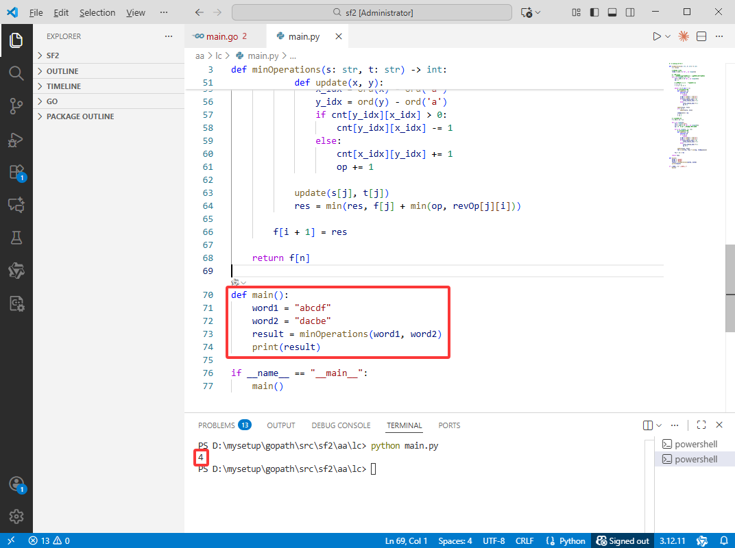

Python完整代码如下:
# -*-coding:utf-8-*-
def minOperations(s: str, t: str) -> int:
    n = len(s)
    # 预处理 revOp
    revOp = [[0] * n for _ in range(n)]
    # 中心扩展法
    # i 为偶数表示奇长度子串,i 为奇数表示偶长度子串
    for i in range(2 * n - 1):
        cnt = [[0] * 26 for _ in range(26)]
        op = 1
        # 从闭区间 [l,r] 开始向左右扩展
        l = i // 2
        r = (i + 1) // 2
        while l >= 0 and r < n:
            # 定义update函数
            def update(x, y):
                nonlocal op
                if x == y:
                    return
                x_idx = ord(x) - ord('a')
                y_idx = ord(y) - ord('a')
                if cnt[y_idx][x_idx] > 0:
                    cnt[y_idx][x_idx] -= 1
                else:
                    cnt[x_idx][y_idx] += 1
                    op += 1
            update(s[l], t[r])
            if l != r:
                update(s[r], t[l])
            revOp[l][r] = op
            l -= 1
            r += 1
    # 动态规划部分
    f = [0] * (n + 1)
    for i in range(n):
        res = float('inf')
        op = 0  # 不反转时的最小操作次数
        for j in range(i, -1, -1):
            # 定义update函数
            def update(x, y):
                nonlocal op
                if x == y:
                    return
                else:
                    op += 1
            update(s[j], t[j])
            res = min(res, f[j] + min(op, revOp[j][i]))
        f[i + 1] = res
    return f[n]
def main():
    word1 = "abcdf"
    word2 = "dacbe"
    result = minOperations(word1, word2)
    print(result)
if __name__ == "__main__":
    main()

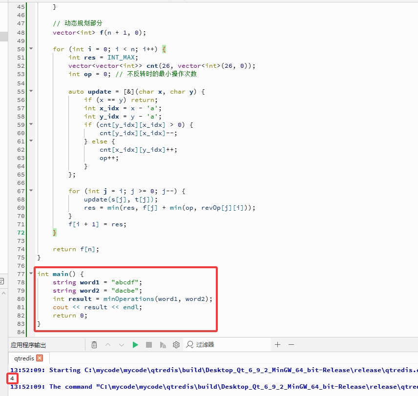

C++完整代码如下:
#include <iostream>
#include <vector>
#include <string>
#include <climits>
#include <algorithm>
using namespace std;
int minOperations(string s, string t) {
    int n = s.length();
    // 预处理 revOp
    vector<vector<int>> revOp(n, vector<int>(n, 0));
    // 中心扩展法
    for (int i = 0; i < 2 * n - 1; i++) {
        vector<vector<int>> cnt(26, vector<int>(26, 0));
        int op = 1;
        // 从闭区间 [l,r] 开始向左右扩展
        int l = i / 2;
        int r = (i + 1) / 2;
        auto update = [&](char x, char y) {
            if (x == y) return;
            int x_idx = x - 'a';
            int y_idx = y - 'a';
            if (cnt[y_idx][x_idx] > 0) {
                cnt[y_idx][x_idx]--;
            } else {
                cnt[x_idx][y_idx]++;
                op++;
        while (l >= 0 && r < n) {
            update(s[l], t[r]);
            if (l != r) {
                update(s[r], t[l]);
            revOp[l][r] = op;
            l--;
            r++;
    // 动态规划部分
    vector<int> f(n + 1, 0);
    for (int i = 0; i < n; i++) {
        int res = INT_MAX;
        int op = 0; // 不反转时的最小操作次数
            if (x == y) return;
            } else {
                op++;
        for (int j = i; j >= 0; j--) {
            update(s[j], t[j]);
            res = min(res, f[j] + min(op, revOp[j][i]));
        f[i + 1] = res;
    return f[n];
int main() {
    string word1 = "abcdf";
    string word2 = "dacbe";
    int result = minOperations(word1, word2);
    cout << result << endl;
    return 0;
