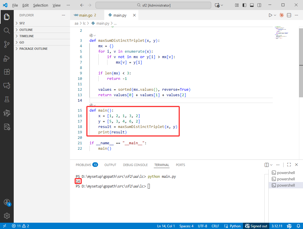

	x := []int{1, 2, 1, 3, 2}
	y := []int{5, 3, 4, 6, 2}
	result := maxSumDistinctTriplet(x, y)
	fmt.Println(result)
Python完整代码如下:
# -*-coding:utf-8-*-
def maxSumDistinctTriplet(x, y):
    mx = {}
    for i, v in enumerate(x):
        if v not in mx or y[i] > mx[v]:
            mx[v] = y[i]
    if len(mx) < 3:
        return -1
    values = sorted(mx.values(), reverse=True)
    return values[0] + values[1] + values[2]
def main():
    x = [1, 2, 1, 3, 2]
    y = [5, 3, 4, 6, 2]
    result = maxSumDistinctTriplet(x, y)
    print(result)
if __name__ == "__main__":
    main()
