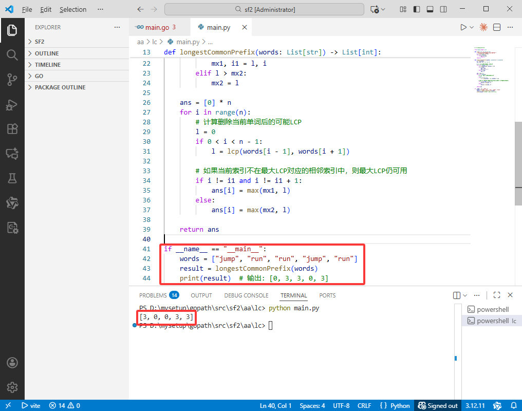

Python完整代码如下:
# -*-coding:utf-8-*-
from typing import List
def lcp(s: str, t: str) -> int:
    """返回两个字符串的最长公共前缀长度"""
    n = min(len(s), len(t))
    for i in range(n):
        if s[i] != t[i]:
            return i
    return n
def longestCommonPrefix(words: List[str]) -> List[int]:
    n = len(words)
    mx1, mx2, i1 = -1, -1, -2
    # 找出相邻单词间的最大和次大LCP
    for i in range(n - 1):
        l = lcp(words[i], words[i + 1])
        if l > mx1:
            mx2 = mx1
            mx1, i1 = l, i
        elif l > mx2:
            mx2 = l
    ans = [0] * n
    for i in range(n):
        # 计算删除当前单词后的可能LCP
        l = 0
        if 0 < i < n - 1:
            l = lcp(words[i - 1], words[i + 1])
        # 如果当前索引不在最大LCP对应的相邻索引中,则最大LCP仍可用
        if i != i1 and i != i1 + 1:
            ans[i] = max(mx1, l)
        else:
            ans[i] = max(mx2, l)
    return ans
if __name__ == "__main__":
    words = ["jump", "run", "run", "jump", "run"]
    result = longestCommonPrefix(words)
    print(result)  # 输出: [0, 3, 3, 0, 3]

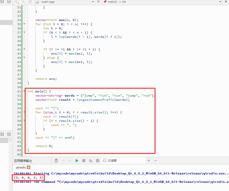

C++完整代码如下:
#include <iostream>
#include <vector>
#include <string>
#include <algorithm>
using namespace std;
int lcp(const string& s, const string& t) {
    int n = min(s.length(), t.length());
    for (int i = 0; i < n; i++) {
        if (s[i] != t[i]) {
            return i;
    return n;
vector<int> longestCommonPrefix(const vector<string>& words) {
    int n = words.size();
    int mx1 = -1, mx2 = -1, i1 = -2;
    // 找出相邻单词间的最大和次大LCP
    for (int i = 0; i < n - 1; i++) {
        int l = lcp(words[i], words[i + 1]);
        if (l > mx1) {
            mx2 = mx1;
            mx1 = l;
            i1 = i;
        } else if (l > mx2) {
            mx2 = l;
    vector<int> ans(n, 0);
        int l = 0;
        if (0 < i && i < n - 1) {
            l = lcp(words[i - 1], words[i + 1]);
        if (i != i1 && i != i1 + 1) {
            ans[i] = max(mx1, l);
        } else {
            ans[i] = max(mx2, l);
    return ans;
int main() {
    vector<string> words = {"jump", "run", "run", "jump", "run"};
    vector<int> result = longestCommonPrefix(words);
    cout << "[";
    for (size_t i = 0; i < result.size(); i++) {
        cout << result[i];
        if (i < result.size() - 1) {
            cout << ", ";
    cout << "]" << endl;
    return 0;
