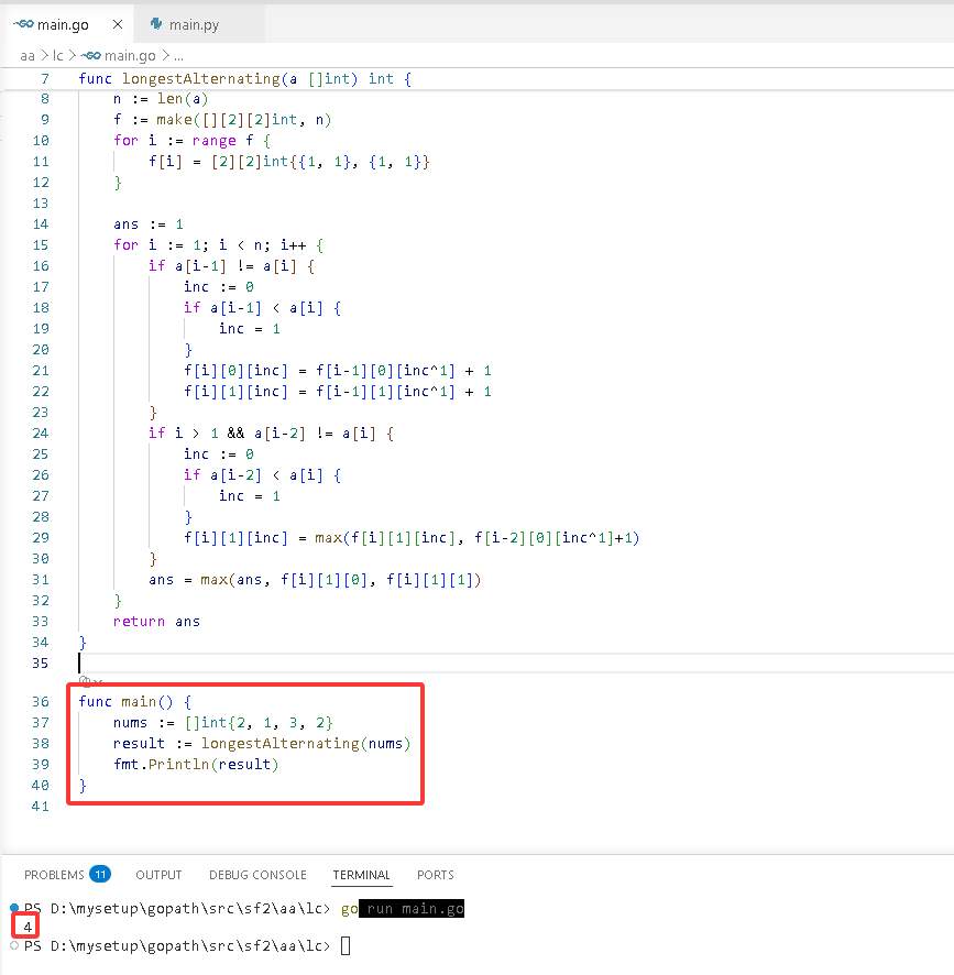

Go完整代码如下:
package main
import (
	"fmt"
func longestAlternating(a []int) int {
	n := len(a)
	f := make([][2][2]int, n)
	for i := range f {
		f[i] = [2][2]int{{1, 1}, {1, 1}}
	ans := 1
	for i := 1; i < n; i++ {
		if a[i-1] != a[i] {
			inc := 0
			if a[i-1] < a[i] {
				inc = 1
			f[i][0][inc] = f[i-1][0][inc^1] + 1
			f[i][1][inc] = f[i-1][1][inc^1] + 1
		if i > 1 && a[i-2] != a[i] {
			inc := 0
			if a[i-2] < a[i] {
				inc = 1
			f[i][1][inc] = max(f[i][1][inc], f[i-2][0][inc^1]+1)
		ans = max(ans, f[i][1][0], f[i][1][1])
	return ans
func main() {
	nums := []int{2, 1, 3, 2}
	result := longestAlternating(nums)
	fmt.Println(result)

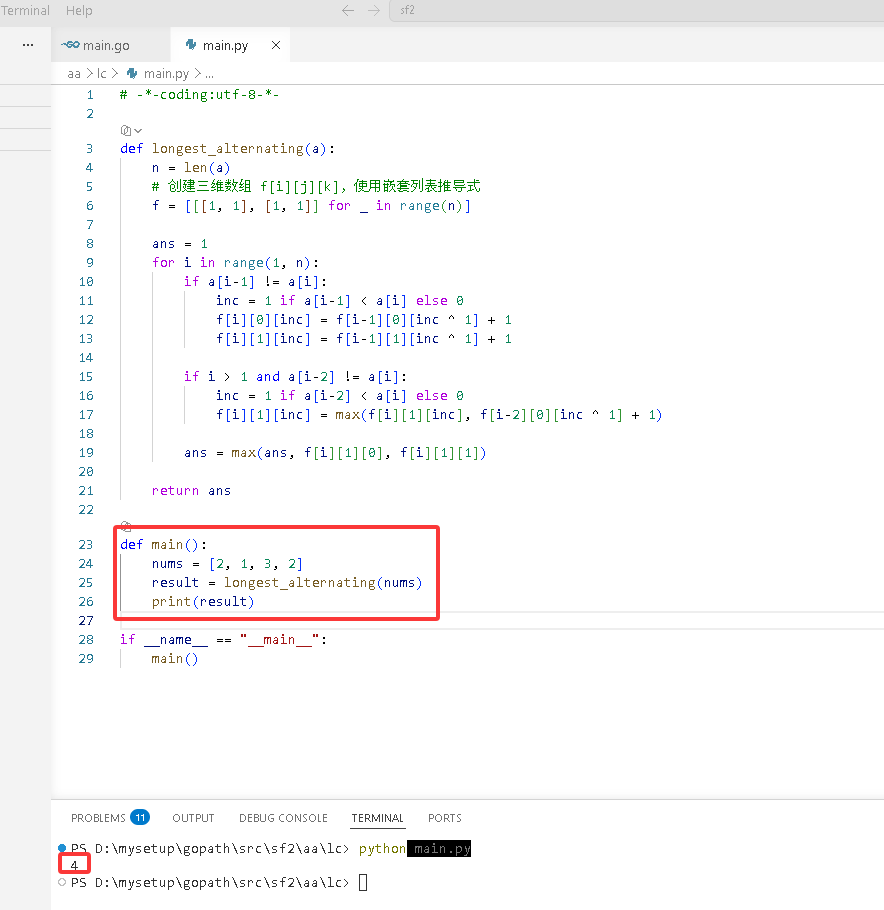

Python完整代码如下:
# -*-coding:utf-8-*-
def longest_alternating(a):
    n = len(a)
    # 创建三维数组 f[i][j][k],使用嵌套列表推导式
    f = [[[1, 1], [1, 1]] for _ in range(n)]
    ans = 1
    for i in range(1, n):
        if a[i-1] != a[i]:
            inc = 1 if a[i-1] < a[i] else 0
            f[i][0][inc] = f[i-1][0][inc ^ 1] + 1
            f[i][1][inc] = f[i-1][1][inc ^ 1] + 1
        if i > 1 and a[i-2] != a[i]:
            inc = 1 if a[i-2] < a[i] else 0
            f[i][1][inc] = max(f[i][1][inc], f[i-2][0][inc ^ 1] + 1)
    return ans
def main():
    nums = [2, 1, 3, 2]
    result = longest_alternating(nums)
    print(result)
if __name__ == "__main__":
    main()

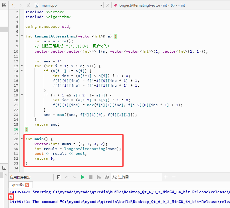

C++完整代码如下:
#include <iostream>
#include <vector>
#include <algorithm>
using namespace std;
int longestAlternating(vector<int>& a) {
    int n = a.size();
    // 创建三维数组 f[i][j][k],初始化为1
    vector<vector<vector<int>>> f(n, vector<vector<int>>(2, vector<int>(2, 1)));
    int ans = 1;
    for (int i = 1; i < n; i++) {
        if (a[i-1] != a[i]) {
            int inc = (a[i-1] < a[i]) ? 1 : 0;
            f[i][0][inc] = f[i-1][0][inc ^ 1] + 1;
            f[i][1][inc] = f[i-1][1][inc ^ 1] + 1;
        if (i > 1 && a[i-2] != a[i]) {
            int inc = (a[i-2] < a[i]) ? 1 : 0;
            f[i][1][inc] = max(f[i][1][inc], f[i-2][0][inc ^ 1] + 1);
        ans = max({ans, f[i][1][0], f[i][1][1]});
    return ans;
int main() {
    vector<int> nums = {2, 1, 3, 2};
    int result = longestAlternating(nums);
    cout << result << endl;
    return 0;
