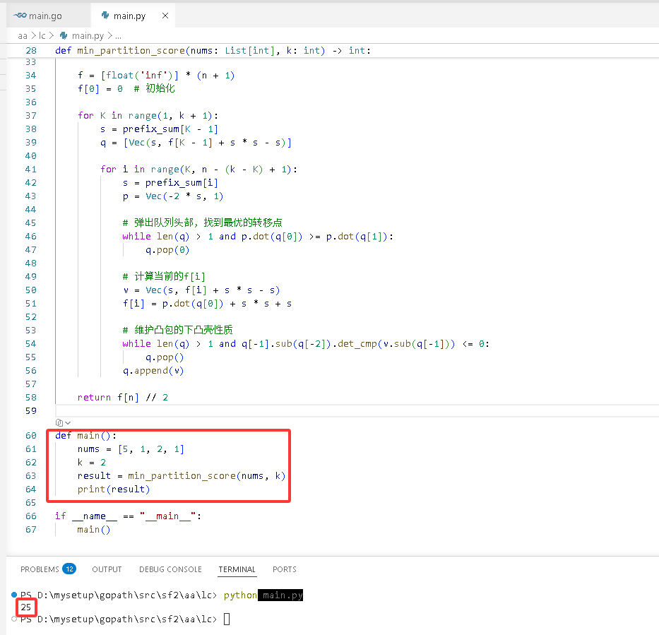

def min_partition_score(nums: List[int], k: int) -> int:
    n = len(nums)
    prefix_sum = [0] * (n + 1)
    for i, x in enumerate(nums):
        prefix_sum[i + 1] = prefix_sum[i] + x
    f = [float('inf')] * (n + 1)
    f[0] = 0  # 初始化
    for K in range(1, k + 1):
        s = prefix_sum[K - 1]
        q = [Vec(s, f[K - 1] + s * s - s)]
        for i in range(K, n - (k - K) + 1):
            s = prefix_sum[i]
            p = Vec(-2 * s, 1)
            # 弹出队列头部,找到最优的转移点
            while len(q) > 1 and p.dot(q[0]) >= p.dot(q[1]):
                q.pop(0)
            # 计算当前的f[i]
            v = Vec(s, f[i] + s * s - s)
            f[i] = p.dot(q[0]) + s * s + s
            # 维护凸包的下凸壳性质
            while len(q) > 1 and q[-1].sub(q[-2]).det_cmp(v.sub(q[-1])) <= 0:
                q.pop()
            q.append(v)
    return f[n] // 2
def main():
    nums = [5, 1, 2, 1]
    k = 2
    result = min_partition_score(nums, k)
    print(result)
if __name__ == "__main__":
    main()

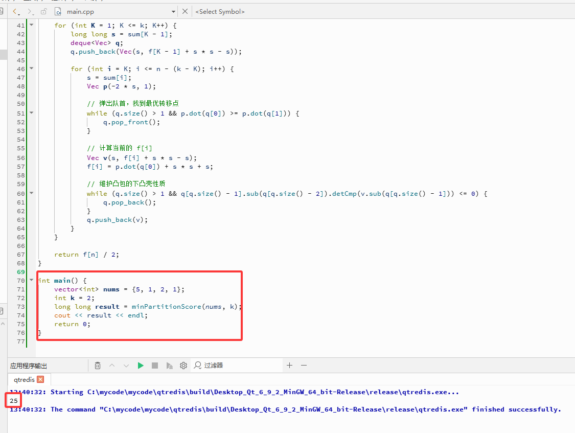

C++完整代码如下:
#include <iostream>
#include <vector>
#include <deque>
#include <climits>
#include <algorithm>
using namespace std;
struct Vec {
    long long x, y;
    Vec(long long x = 0, long long y = 0) : x(x), y(y) {}
    Vec sub(const Vec& other) const {
        return Vec(x - other.x, y - other.y);
    long long dot(const Vec& other) const {
        return x * other.x + y * other.y;
    // 使用 __int128 避免溢出
    int detCmp(const Vec& other) const {
        __int128 v = (__int128)x * other.y;
        __int128 w = (__int128)y * other.x;
        if (v > w) return 1;
        if (v < w) return -1;
        return 0;
long long minPartitionScore(vector<int>& nums, int k) {
    int n = nums.size();
    vector<long long> sum(n + 1, 0);
    for (int i = 0; i < n; i++) {
        sum[i + 1] = sum[i] + nums[i];
    vector<long long> f(n + 1, LLONG_MAX / 2);
    f[0] = 0;
    for (int K = 1; K <= k; K++) {
        long long s = sum[K - 1];
        deque<Vec> q;
        q.push_back(Vec(s, f[K - 1] + s * s - s));
        for (int i = K; i <= n - (k - K); i++) {
            s = sum[i];
            Vec p(-2 * s, 1);
            // 弹出队首,找到最优转移点
            while (q.size() > 1 && p.dot(q[0]) >= p.dot(q[1])) {
                q.pop_front();
            // 计算当前的 f[i]
            Vec v(s, f[i] + s * s - s);
            f[i] = p.dot(q[0]) + s * s + s;
            // 维护凸包的下凸壳性质
            while (q.size() > 1 && q[q.size() - 1].sub(q[q.size() - 2]).detCmp(v.sub(q[q.size() - 1])) <= 0) {
                q.pop_back();
            q.push_back(v);
    return f[n] / 2;
int main() {
    vector<int> nums = {5, 1, 2, 1};
    int k = 2;
    long long result = minPartitionScore(nums, k);
    cout << result << endl;
    return 0;
