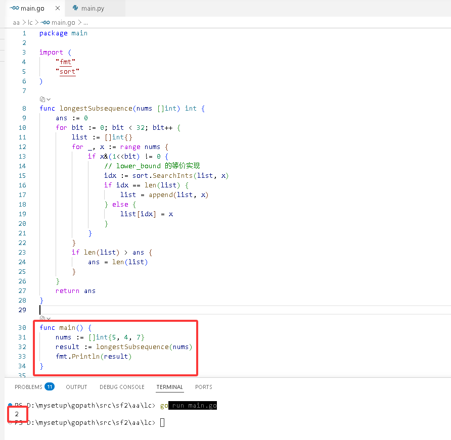

Go完整代码如下:
package main
import (
	"fmt"
	"sort"
func longestSubsequence(nums []int) int {
	ans := 0
	for bit := 0; bit < 32; bit++ {
		list := []int{}
		for _, x := range nums {
			if x&(1<<bit) != 0 {
				// lower_bound 的等价实现
				idx := sort.SearchInts(list, x)
				if idx == len(list) {
					list = append(list, x)
				} else {
					list[idx] = x
		if len(list) > ans {
			ans = len(list)
	return ans
func main() {
	nums := []int{5, 4, 7}
	result := longestSubsequence(nums)
	fmt.Println(result)

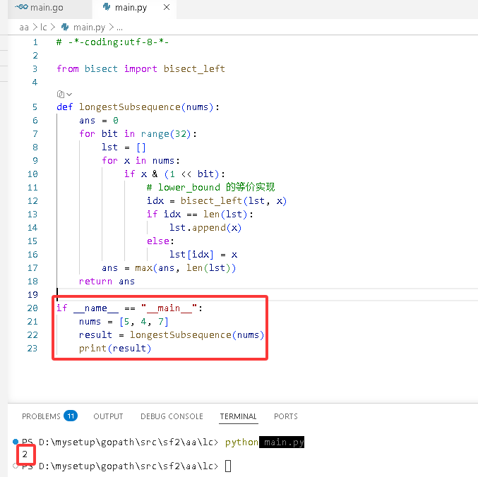

Python完整代码如下:
# -*-coding:utf-8-*-
from bisect import bisect_left
def longestSubsequence(nums):
    ans = 0
    for bit in range(32):
        lst = []
        for x in nums:
            if x & (1 << bit):
                # lower_bound 的等价实现
                idx = bisect_left(lst, x)
                if idx == len(lst):
                    lst.append(x)
                else:
                    lst[idx] = x
        ans = max(ans, len(lst))
    return ans
if __name__ == "__main__":
    nums = [5, 4, 7]
    result = longestSubsequence(nums)
    print(result)

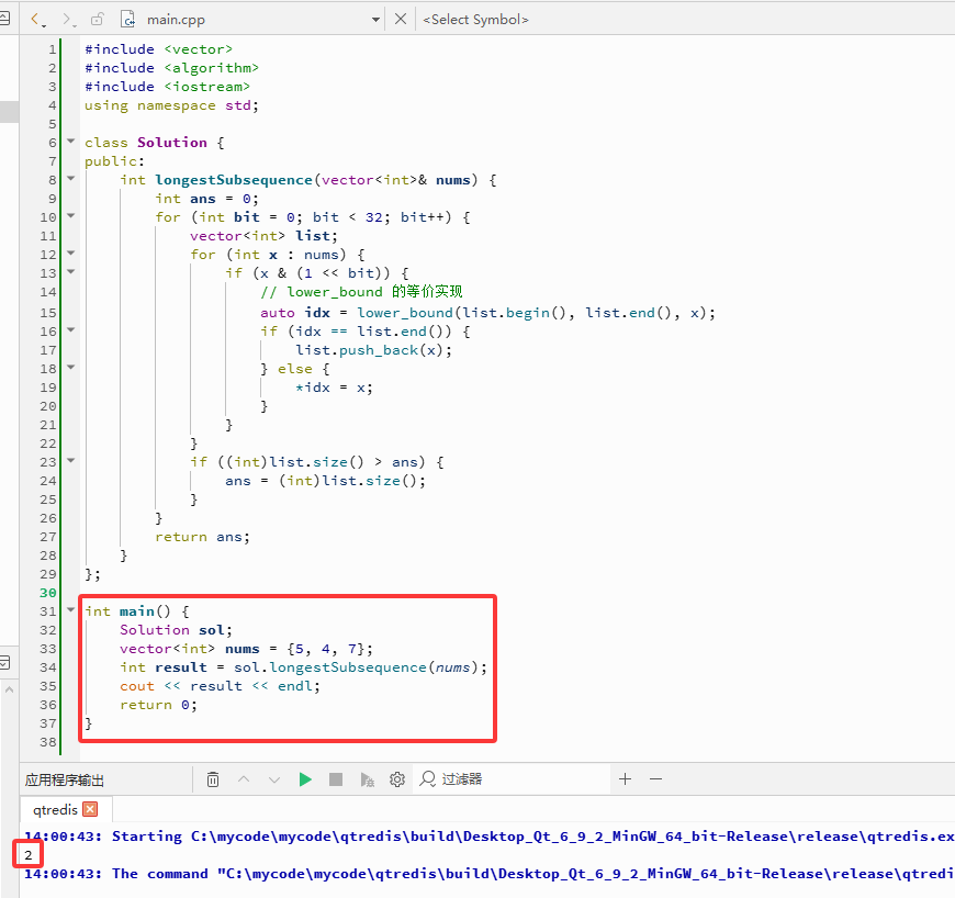

C++完整代码如下:
#include <vector>
#include <algorithm>
#include <iostream>
using namespace std;
class Solution {
public:
    int longestSubsequence(vector<int>& nums) {
        int ans = 0;
        for (int bit = 0; bit < 32; bit++) {
            vector<int> list;
            for (int x : nums) {
                if (x & (1 << bit)) {
                    auto idx = lower_bound(list.begin(), list.end(), x);
                    if (idx == list.end()) {
                        list.push_back(x);
                    } else {
                        *idx = x;
            if ((int)list.size() > ans) {
                ans = (int)list.size();
        return ans;
int main() {
    Solution sol;
    vector<int> nums = {5, 4, 7};
    int result = sol.longestSubsequence(nums);
    cout << result << endl;
    return 0;
