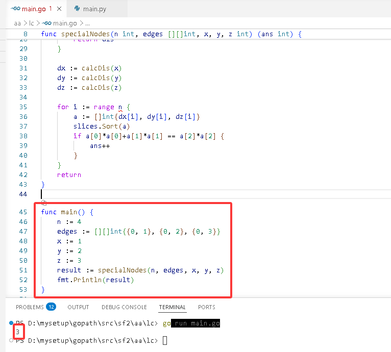

Go完整代码如下:
package main
import (
	"fmt"
	"slices"
func specialNodes(n int, edges [][]int, x, y, z int) (ans int) {
	g := make([][]int, n)
	for _, e := range edges {
		v, w := e[0], e[1]
		g[v] = append(g[v], w)
		g[w] = append(g[w], v)
	calcDis := func(start int) []int {
		dis := make([]int, n)
		var dfs func(int, int)
		dfs = func(v, fa int) {
			for _, w := range g[v] {
				if w != fa {
					dis[w] = dis[v] + 1
					dfs(w, v)
		dfs(start, -1)
		return dis
	dx := calcDis(x)
	dy := calcDis(y)
	dz := calcDis(z)
	for i := range n {
		a := []int{dx[i], dy[i], dz[i]}
		slices.Sort(a)
		if a[0]*a[0]+a[1]*a[1] == a[2]*a[2] {
			ans++
	return
func main() {
	n := 4
	edges := [][]int{{0, 1}, {0, 2}, {0, 3}}
	x := 1
	y := 2
	z := 3
	result := specialNodes(n, edges, x, y, z)
	fmt.Println(result)

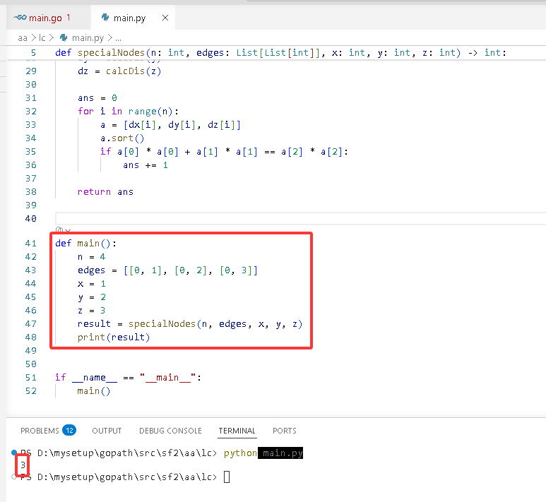

Python完整代码如下:
# -*-coding:utf-8-*-
from typing import List
def specialNodes(n: int, edges: List[List[int]], x: int, y: int, z: int) -> int:
    # 构建邻接表
    g = [[] for _ in range(n)]
    for v, w in edges:
        g[v].append(w)
        g[w].append(v)
    # 计算从 start 出发到所有节点的距离
    def calcDis(start: int) -> List[int]:
        dis = [0] * n
        visited = [False] * n
        def dfs(v: int):
            visited[v] = True
            for w in g[v]:
                if not visited[w]:
                    dis[w] = dis[v] + 1
                    dfs(w)
        dfs(start)
        return dis
    dx = calcDis(x)
    dy = calcDis(y)
    dz = calcDis(z)
    ans = 0
    for i in range(n):
        a = [dx[i], dy[i], dz[i]]
        a.sort()
        if a[0] * a[0] + a[1] * a[1] == a[2] * a[2]:
            ans += 1
    return ans
def main():
    n = 4
    edges = [[0, 1], [0, 2], [0, 3]]
    x = 1
    y = 2
    z = 3
    result = specialNodes(n, edges, x, y, z)
    print(result)
if __name__ == "__main__":
    main()

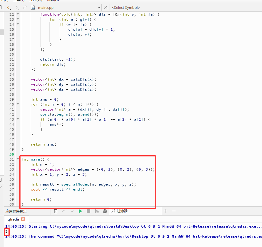

C++完整代码如下:
#include <iostream>
#include <vector>
#include <algorithm>
#include <functional>
using namespace std;
int specialNodes(int n, vector<vector<int>>& edges, int x, int y, int z) {
    // 构建邻接表
    vector<vector<int>> g(n);
    for (auto& e : edges) {
        int v = e[0], w = e[1];
        g[v].push_back(w);
        g[w].push_back(v);
    // 计算从 start 出发到所有节点的距离
    auto calcDis = [&](int start) -> vector<int> {
        vector<int> dis(n, 0);
        // DFS 函数声明
        function<void(int, int)> dfs = [&](int v, int fa) {
            for (int w : g[v]) {
                if (w != fa) {
                    dis[w] = dis[v] + 1;
                    dfs(w, v);
        dfs(start, -1);
        return dis;
    vector<int> dx = calcDis(x);
    vector<int> dy = calcDis(y);
    vector<int> dz = calcDis(z);
    int ans = 0;
    for (int i = 0; i < n; i++) {
        vector<int> a = {dx[i], dy[i], dz[i]};
        sort(a.begin(), a.end());
        if (a[0] * a[0] + a[1] * a[1] == a[2] * a[2]) {
            ans++;
    return ans;
int main() {
    int n = 4;
    vector<vector<int>> edges = {{0, 1}, {0, 2}, {0, 3}};
    int x = 1, y = 2, z = 3;
    int result = specialNodes(n, edges, x, y, z);
    cout << result << endl;
    return 0;
