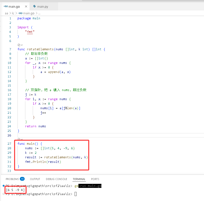

Go完整代码如下:
package main
import (
	"fmt"
func rotateElements(nums []int, k int) []int {
	// 取出非负数
	a := []int{}
	for _, x := range nums {
		if x >= 0 {
			a = append(a, x)
	// 双指针,把 a 填入 nums,跳过负数
	j := k
	for i, x := range nums {
		if x >= 0 {
			nums[i] = a[j%len(a)]
			j++
	return nums
func main() {
	nums := []int{5, 4, -9, 6}
	k := 2
	result := rotateElements(nums, k)
	fmt.Println(result)

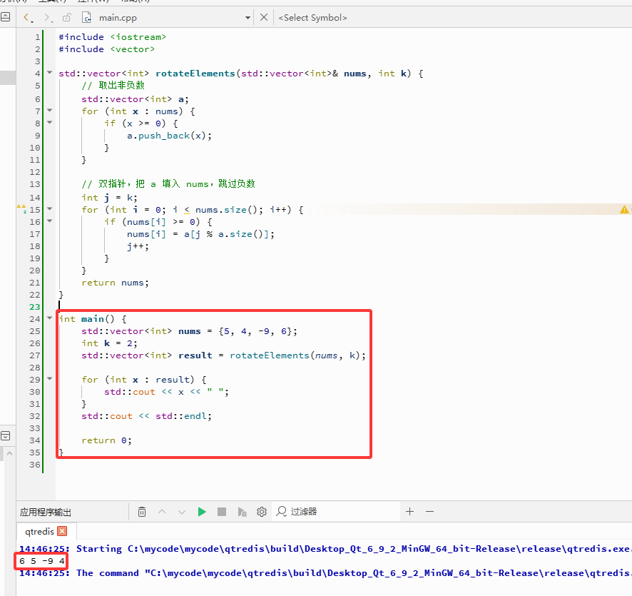

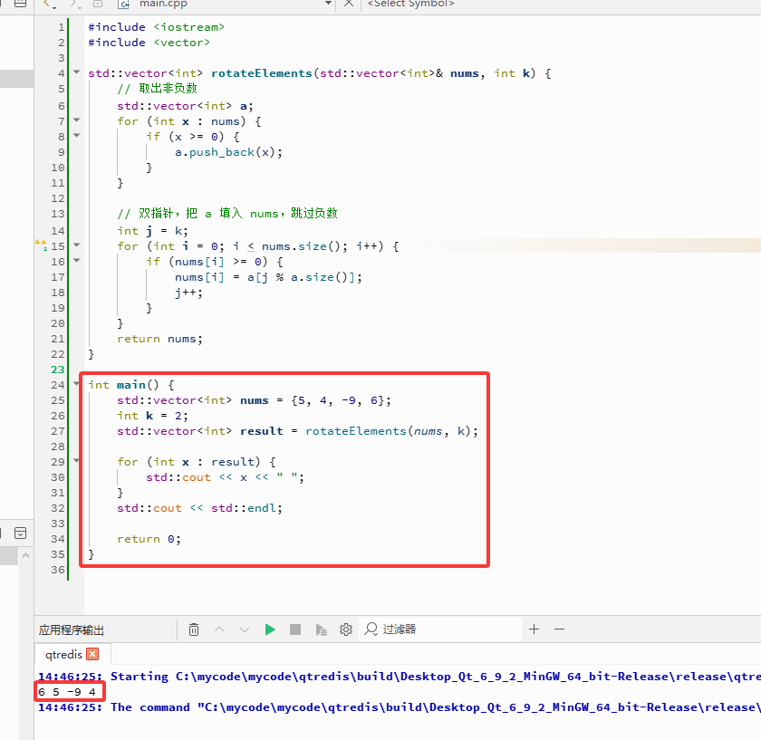

C++完整代码如下:
#include <iostream>
#include <vector>
std::vector<int> rotateElements(std::vector<int>& nums, int k) {
    // 取出非负数
    std::vector<int> a;
    for (int x : nums) {
        if (x >= 0) {
            a.push_back(x);
    int j = k;
    for (int i = 0; i < nums.size(); i++) {
        if (nums[i] >= 0) {
            nums[i] = a[j % a.size()];
            j++;
    return nums;
int main() {
    std::vector<int> nums = {5, 4, -9, 6};
    int k = 2;
    std::vector<int> result = rotateElements(nums, k);
    for (int x : result) {
        std::cout << x << " ";
    std::cout << std::endl;
    return 0;
