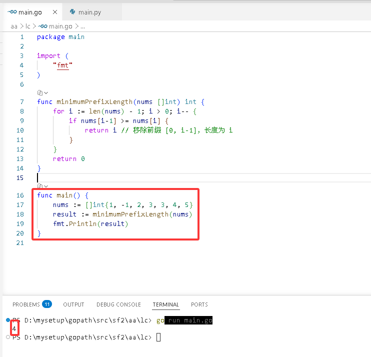

Go完整代码如下:
package main
import (
	"fmt"
func minimumPrefixLength(nums []int) int {
	for i := len(nums) - 1; i > 0; i-- {
		if nums[i-1] >= nums[i] {
			return i // 移除前缀 [0, i-1],长度为 i
	return 0
func main() {
	nums := []int{1, -1, 2, 3, 3, 4, 5}
	result := minimumPrefixLength(nums)
	fmt.Println(result)

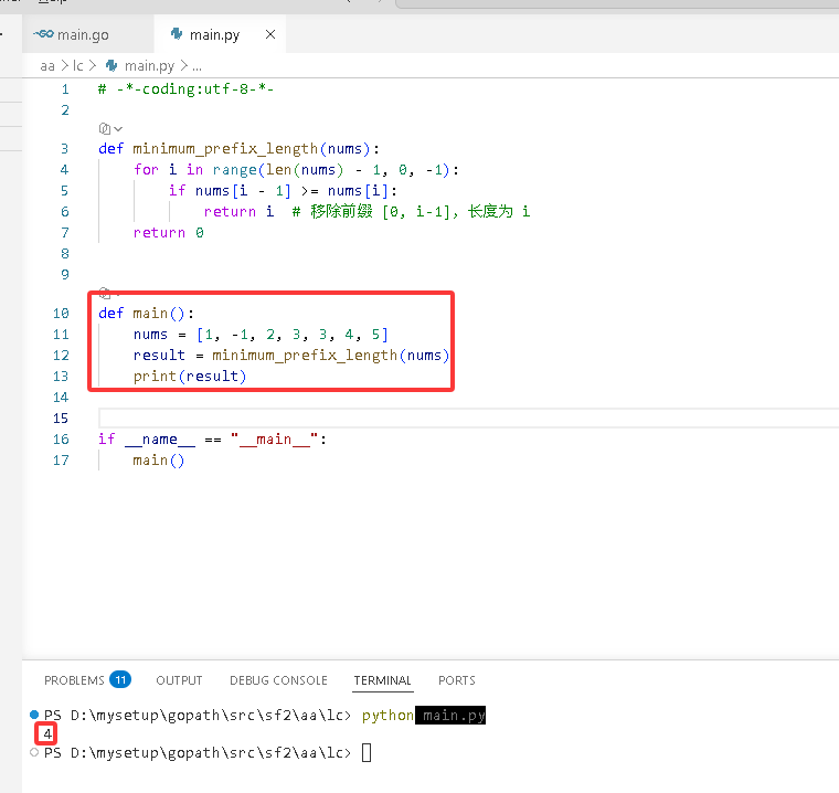

Python完整代码如下:
# -*-coding:utf-8-*-
def minimum_prefix_length(nums):
    for i in range(len(nums) - 1, 0, -1):
        if nums[i - 1] >= nums[i]:
            return i  # 移除前缀 [0, i-1],长度为 i
    return 0
def main():
    nums = [1, -1, 2, 3, 3, 4, 5]
    result = minimum_prefix_length(nums)
    print(result)
if __name__ == "__main__":
    main()

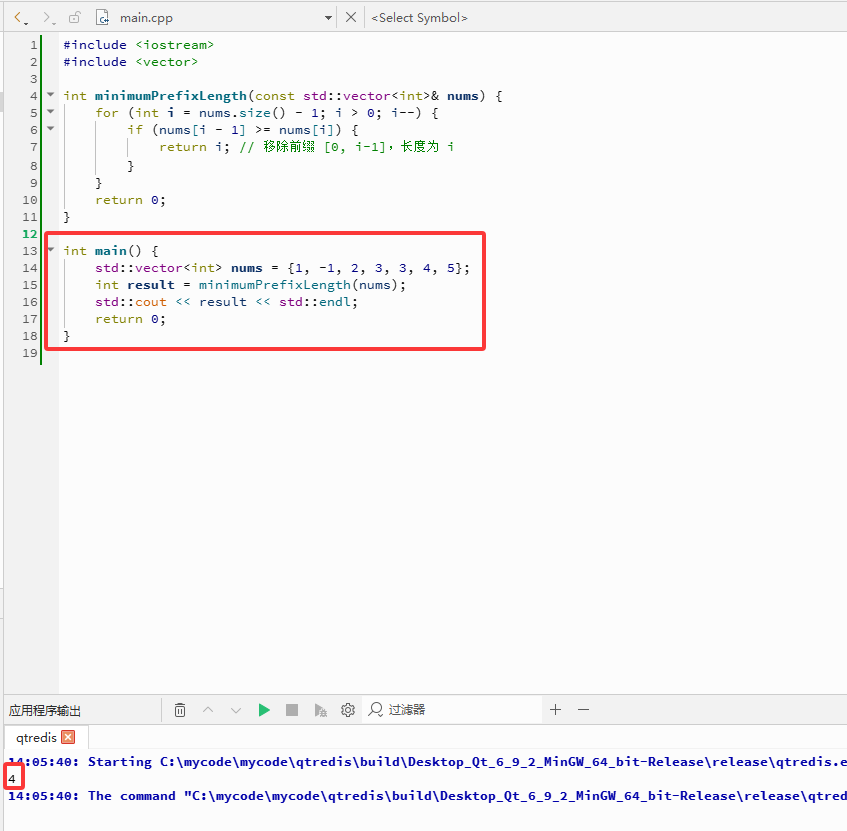

C++完整代码如下:
#include <iostream>
#include <vector>
int minimumPrefixLength(const std::vector<int>& nums) {
    for (int i = nums.size() - 1; i > 0; i--) {
        if (nums[i - 1] >= nums[i]) {
            return i; // 移除前缀 [0, i-1],长度为 i
    return 0;
int main() {
    std::vector<int> nums = {1, -1, 2, 3, 3, 4, 5};
    int result = minimumPrefixLength(nums);
    std::cout << result << std::endl;
    return 0;
