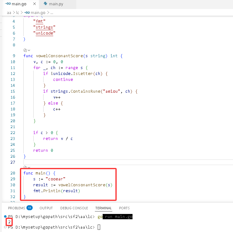

Go完整代码如下:
package main
import (
	"fmt"
	"strings"
	"unicode"
func vowelConsonantScore(s string) int {
	v, c := 0, 0
	for _, ch := range s {
		if !unicode.IsLetter(ch) {
			continue
		if strings.ContainsRune("aeiou", ch) {
			v++
		} else {
			c++
	if c > 0 {
		return v / c
	return 0
func main() {
	s := "cooear"
	result := vowelConsonantScore(s)
	fmt.Println(result)

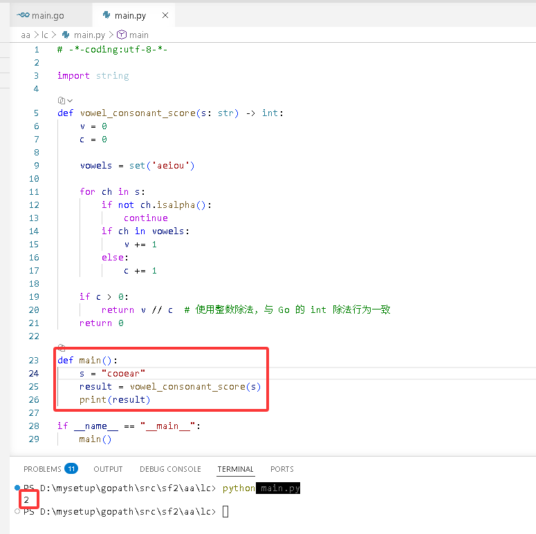

Python完整代码如下:
# -*-coding:utf-8-*-
import string
def vowel_consonant_score(s: str) -> int:
    v = 0
    c = 0
    vowels = set('aeiou')
    for ch in s:
        if not ch.isalpha():
            continue
        if ch in vowels:
            v += 1
        else:
            c += 1
    if c > 0:
        return v // c  # 使用整数除法,与 Go 的 int 除法行为一致
    return 0
def main():
    s = "cooear"
    result = vowel_consonant_score(s)
    print(result)
if __name__ == "__main__":
    main()

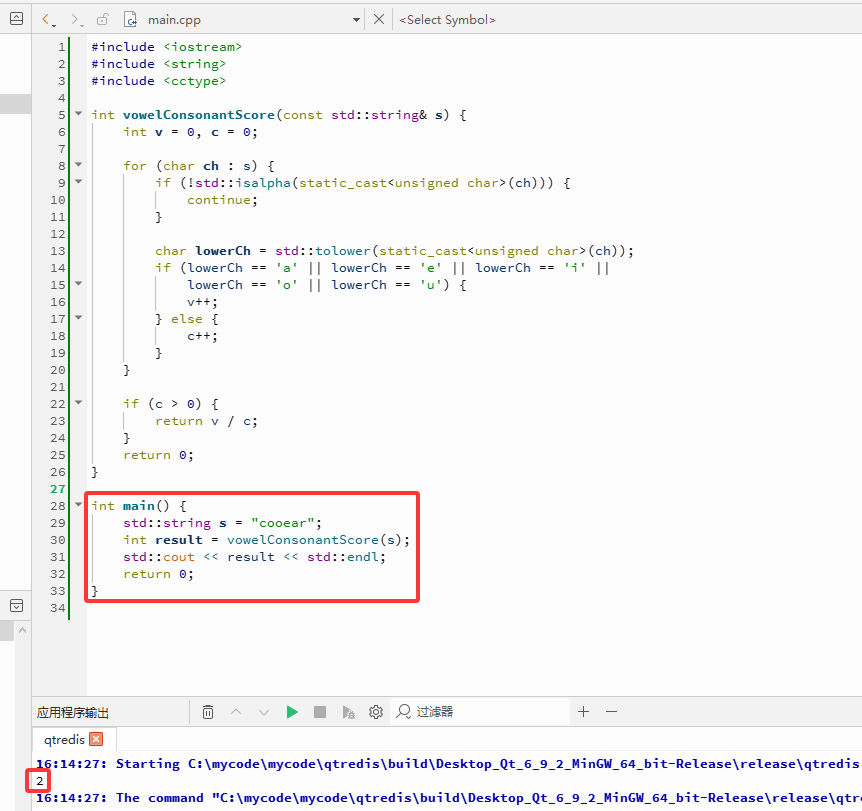

C++完整代码如下:
#include <iostream>
#include <string>
#include <cctype>
int vowelConsonantScore(const std::string& s) {
    int v = 0, c = 0;
    for (char ch : s) {
        if (!std::isalpha(static_cast<unsigned char>(ch))) {
            continue;
        char lowerCh = std::tolower(static_cast<unsigned char>(ch));
        if (lowerCh == 'a' || lowerCh == 'e' || lowerCh == 'i' ||
            lowerCh == 'o' || lowerCh == 'u') {
            v++;
        } else {
            c++;
    if (c > 0) {
        return v / c;
    return 0;
int main() {
    std::string s = "cooear";
    int result = vowelConsonantScore(s);
    std::cout << result << std::endl;
    return 0;
