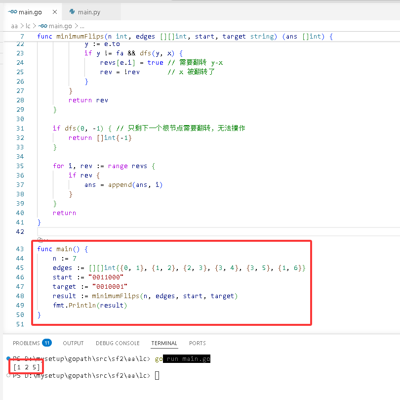

Go完整代码如下:
package main
import (
	"fmt"
func minimumFlips(n int, edges [][]int, start, target string) (ans []int) {
	type edge struct{ to, i int }
	g := make([][]edge, n)
	for i, e := range edges {
		x, y := e[0], e[1]
		g[x] = append(g[x], edge{y, i})
		g[y] = append(g[y], edge{x, i})
	revs := make([]bool, n-1)
	// 返回是否需要翻转 x-fa 这条边
	var dfs func(int, int) bool
	dfs = func(x, fa int) bool {
		rev := start[x] != target[x] // x-fa 是否要翻转
		for _, e := range g[x] {
			y := e.to
			if y != fa && dfs(y, x) {
				revs[e.i] = true // 需要翻转 y-x
				rev = !rev       // x 被翻转了
		return rev
	if dfs(0, -1) { // 只剩下一个根节点需要翻转,无法操作
		return []int{-1}
	for i, rev := range revs {
		if rev {
			ans = append(ans, i)
	return
func main() {
	n := 7
	edges := [][]int{{0, 1}, {1, 2}, {2, 3}, {3, 4}, {3, 5}, {1, 6}}
	start := "0011000"
	target := "0010001"
	result := minimumFlips(n, edges, start, target)
	fmt.Println(result)

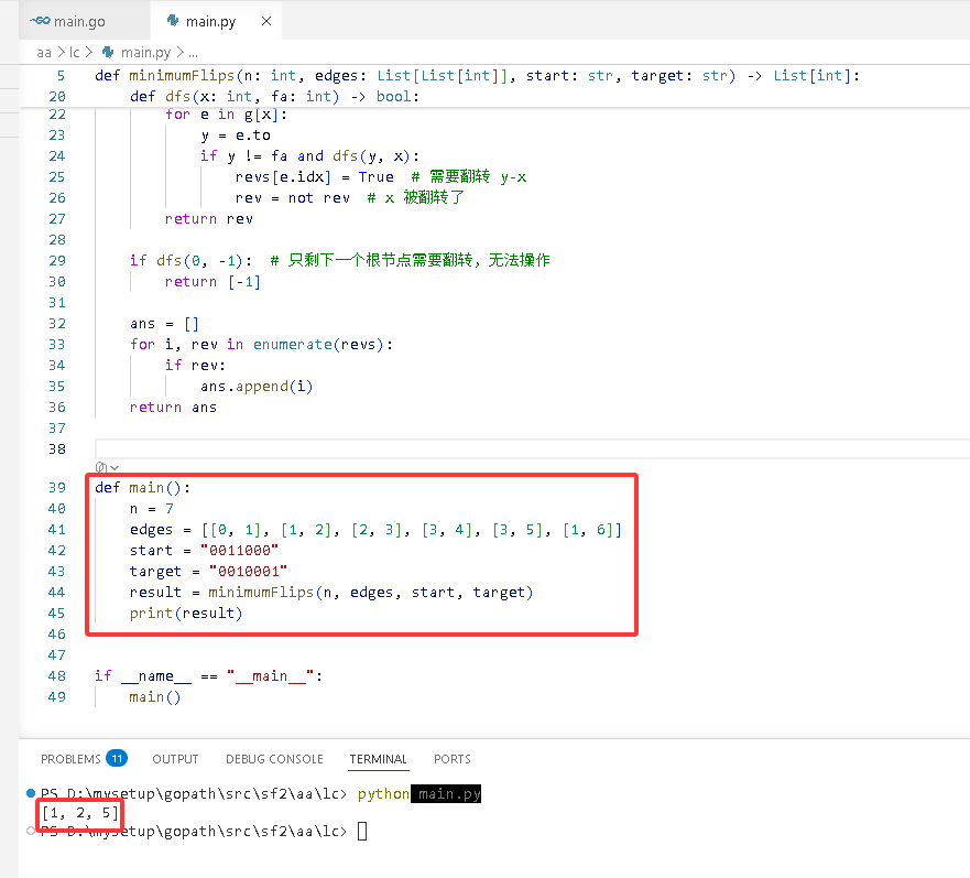

Python完整代码如下:
# -*-coding:utf-8-*-
from typing import List
def minimumFlips(n: int, edges: List[List[int]], start: str, target: str) -> List[int]:
    class Edge:
        def __init__(self, to: int, idx: int):
            self.to = to
            self.idx = idx
    g = [[] for _ in range(n)]
    for i, e in enumerate(edges):
        x, y = e[0], e[1]
        g[x].append(Edge(y, i))
        g[y].append(Edge(x, i))
    revs = [False] * (n - 1)
    # 返回是否需要翻转 x-fa 这条边
    def dfs(x: int, fa: int) -> bool:
        rev = start[x] != target[x]  # x-fa 是否要翻转
        for e in g[x]:
            y = e.to
            if y != fa and dfs(y, x):
                revs[e.idx] = True  # 需要翻转 y-x
                rev = not rev  # x 被翻转了
        return rev
    if dfs(0, -1):  # 只剩下一个根节点需要翻转,无法操作
        return [-1]
    ans = []
    for i, rev in enumerate(revs):
        if rev:
            ans.append(i)
    return ans
def main():
    n = 7
    edges = [[0, 1], [1, 2], [2, 3], [3, 4], [3, 5], [1, 6]]
    start = "0011000"
    target = "0010001"
    result = minimumFlips(n, edges, start, target)
    print(result)
if __name__ == "__main__":
    main()

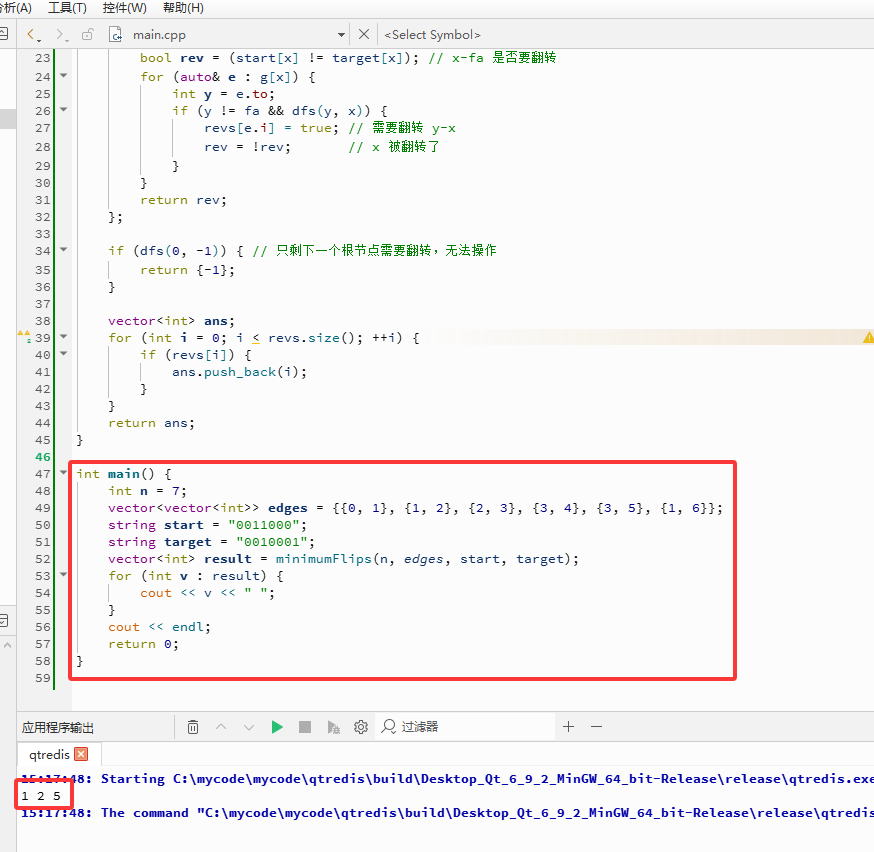

C++完整代码如下:
#include <iostream>
#include <vector>
#include <string>
#include <functional>
using namespace std;
vector<int> minimumFlips(int n, vector<vector<int>>& edges, string start, string target) {
    struct Edge {
        int to, i;
    vector<vector<Edge>> g(n);
    for (int i = 0; i < edges.size(); ++i) {
        int x = edges[i][0], y = edges[i][1];
        g[x].push_back({y, i});
        g[y].push_back({x, i});
    vector<bool> revs(edges.size(), false);
    function<bool(int, int)> dfs = [&](int x, int fa) -> bool {
        bool rev = (start[x] != target[x]); // x-fa 是否要翻转
        for (auto& e : g[x]) {
            int y = e.to;
            if (y != fa && dfs(y, x)) {
                revs[e.i] = true; // 需要翻转 y-x
                rev = !rev;       // x 被翻转了
        return rev;
    if (dfs(0, -1)) { // 只剩下一个根节点需要翻转,无法操作
        return {-1};
    vector<int> ans;
    for (int i = 0; i < revs.size(); ++i) {
        if (revs[i]) {
            ans.push_back(i);
    return ans;
int main() {
    int n = 7;
    vector<vector<int>> edges = {{0, 1}, {1, 2}, {2, 3}, {3, 4}, {3, 5}, {1, 6}};
    string start = "0011000";
    string target = "0010001";
    vector<int> result = minimumFlips(n, edges, start, target);
    for (int v : result) {
        cout << v << " ";
    cout << endl;
    return 0;
