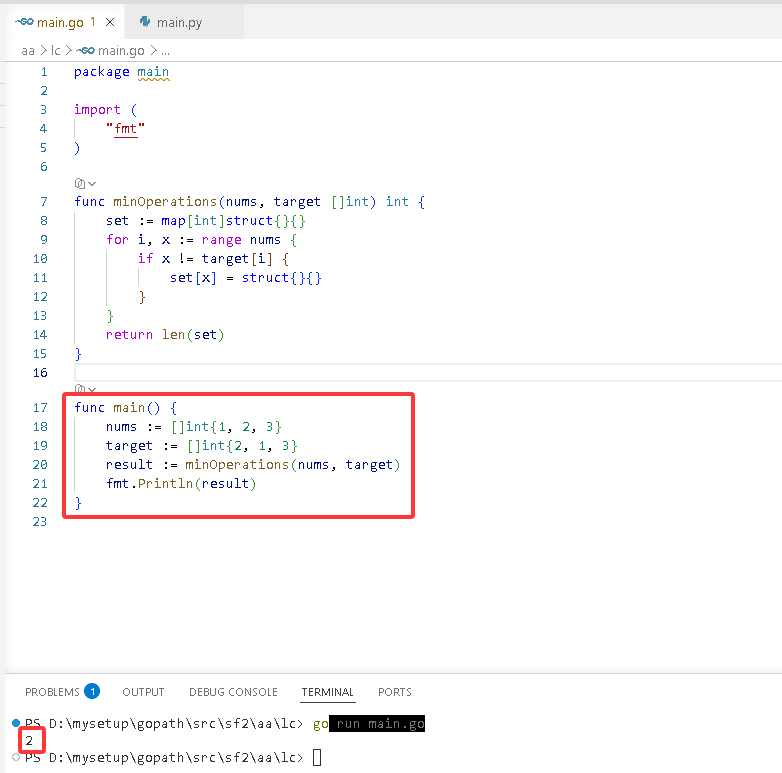

Go完整代码如下:
package main
import (
	"fmt"
func minOperations(nums, target []int) int {
	set := map[int]struct{}{}
	for i, x := range nums {
		if x != target[i] {
			set[x] = struct{}{}
	return len(set)
func main() {
	nums := []int{1, 2, 3}
	target := []int{2, 1, 3}
	result := minOperations(nums, target)
	fmt.Println(result)

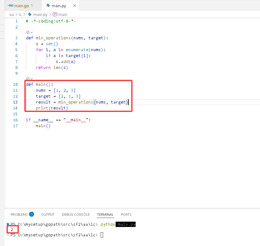

Python完整代码如下:
	fmt.Println(result)

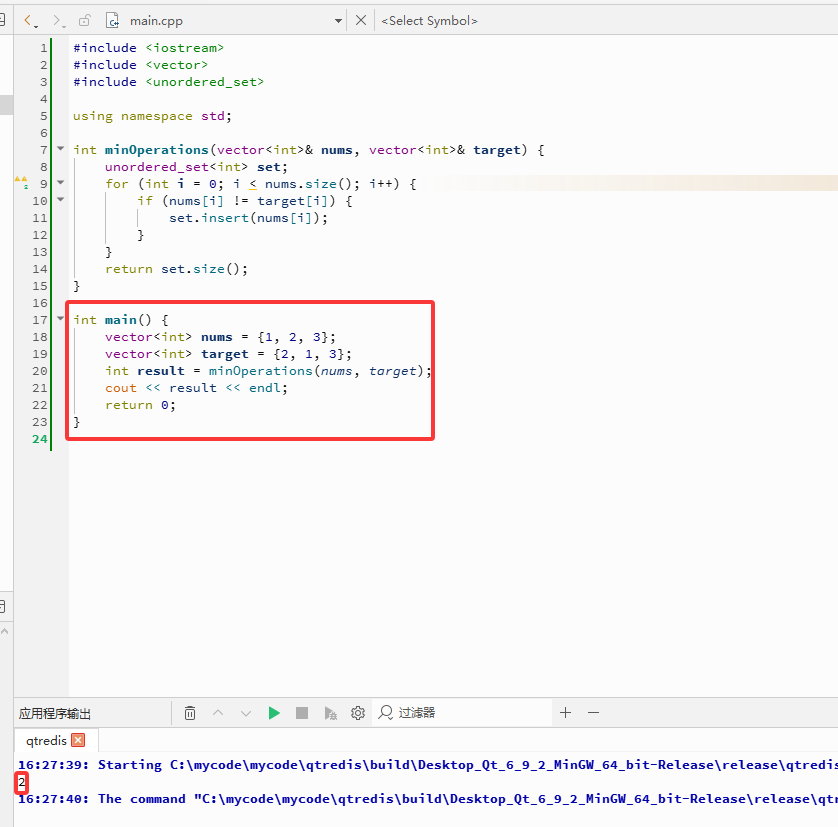

C++完整代码如下:
#include <iostream>
#include <vector>
#include <unordered_set>
using namespace std;
int minOperations(vector<int>& nums, vector<int>& target) {
    unordered_set<int> set;
    for (int i = 0; i < nums.size(); i++) {
        if (nums[i] != target[i]) {
            set.insert(nums[i]);
    return set.size();
int main() {
    vector<int> nums = {1, 2, 3};
    vector<int> target = {2, 1, 3};
    int result = minOperations(nums, target);
    cout << result << endl;
    return 0;
