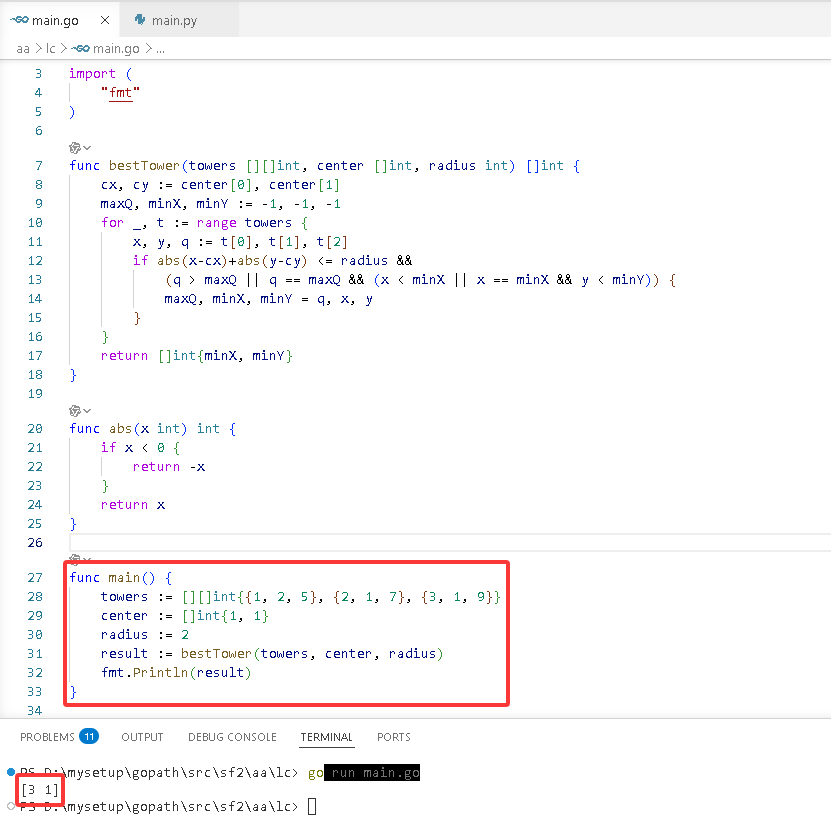

Go完整代码如下:
package main
import (
	"fmt"
func bestTower(towers [][]int, center []int, radius int) []int {
	cx, cy := center[0], center[1]
	maxQ, minX, minY := -1, -1, -1
	for _, t := range towers {
		x, y, q := t[0], t[1], t[2]
		if abs(x-cx)+abs(y-cy) <= radius &&
			(q > maxQ || q == maxQ && (x < minX || x == minX && y < minY)) {
			maxQ, minX, minY = q, x, y
	return []int{minX, minY}
func abs(x int) int {
	if x < 0 {
		return -x
	return x
func main() {
	towers := [][]int{{1, 2, 5}, {2, 1, 7}, {3, 1, 9}}
	center := []int{1, 1}
	radius := 2
	result := bestTower(towers, center, radius)
	fmt.Println(result)

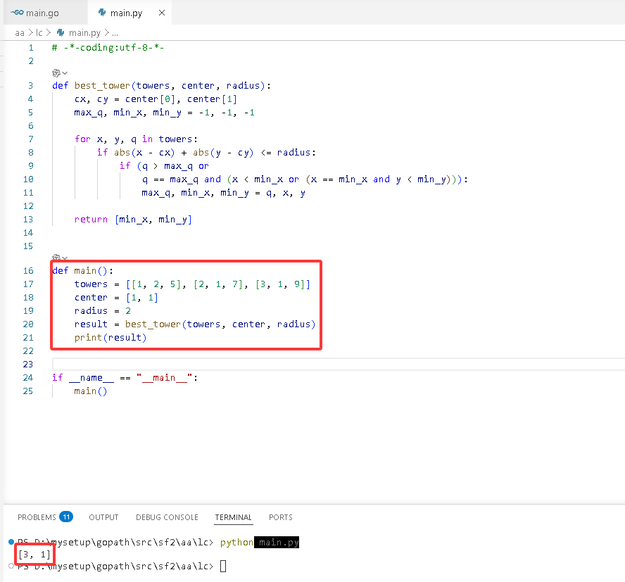

Python完整代码如下:
# -*-coding:utf-8-*-
def best_tower(towers, center, radius):
    cx, cy = center[0], center[1]
    max_q, min_x, min_y = -1, -1, -1
    for x, y, q in towers:
        if abs(x - cx) + abs(y - cy) <= radius:
            if (q > max_q or
                q == max_q and (x < min_x or (x == min_x and y < min_y))):
                max_q, min_x, min_y = q, x, y
    return [min_x, min_y]
def main():
    towers = [[1, 2, 5], [2, 1, 7], [3, 1, 9]]
    center = [1, 1]
    radius = 2
    result = best_tower(towers, center, radius)
    print(result)
if __name__ == "__main__":
    main()

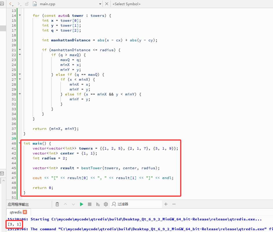

C++完整代码如下:
#include <iostream>
#include <vector>
#include <cmath>
using namespace std;
vector<int> bestTower(vector<vector<int>>& towers, vector<int>& center, int radius) {
    int cx = center[0];
    int cy = center[1];
    int maxQ = -1;
    int minX = -1;
    int minY = -1;
    for (const auto& tower : towers) {
        int x = tower[0];
        int y = tower[1];
        int q = tower[2];
        int manhattanDistance = abs(x - cx) + abs(y - cy);
        if (manhattanDistance <= radius) {
            if (q > maxQ) {
                maxQ = q;
                minX = x;
                minY = y;
            } else if (q == maxQ) {
                if (x < minX) {
                    minX = x;
                    minY = y;
                } else if (x == minX && y < minY) {
                    minY = y;
    return {minX, minY};
int main() {
    vector<vector<int>> towers = {{1, 2, 5}, {2, 1, 7}, {3, 1, 9}};
    vector<int> center = {1, 1};
    int radius = 2;
    vector<int> result = bestTower(towers, center, radius);
    cout << "[" << result[0] << ", " << result[1] << "]" << endl;
    return 0;
