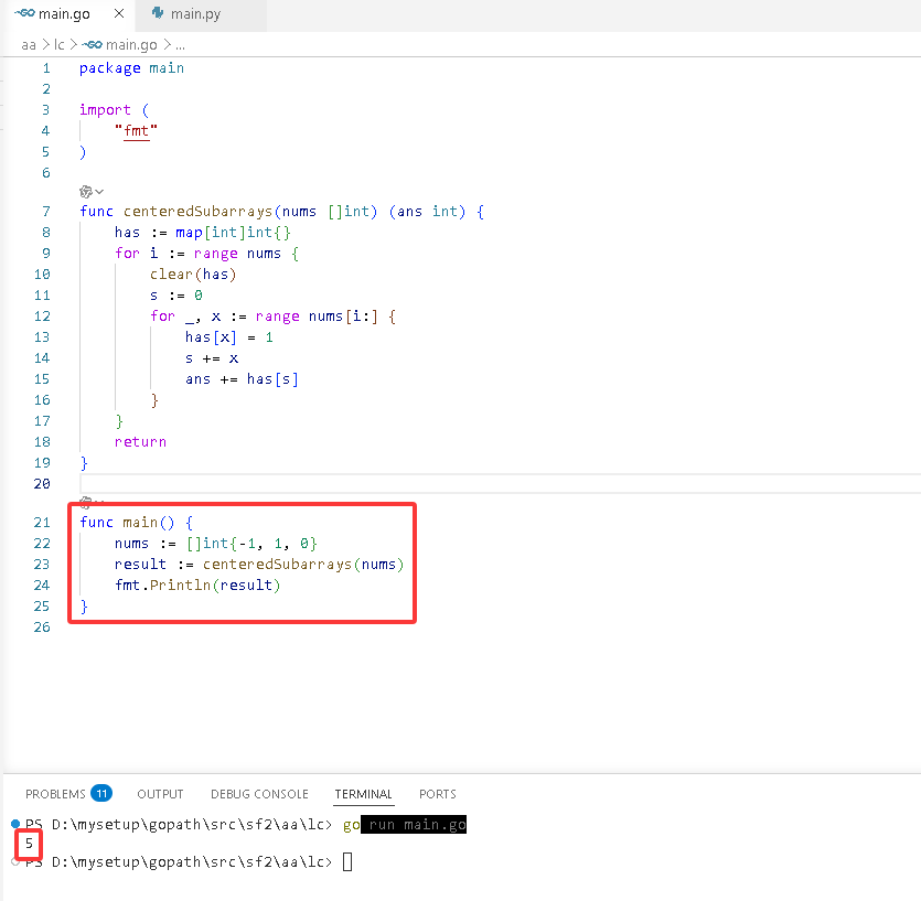

Go完整代码如下:
package main
import (
	"fmt"
func centeredSubarrays(nums []int) (ans int) {
	has := map[int]int{}
	for i := range nums {
		clear(has)
		s := 0
		for _, x := range nums[i:] {
			has[x] = 1
			s += x
			ans += has[s]
	return
func main() {
	nums := []int{-1, 1, 0}
	result := centeredSubarrays(nums)
	fmt.Println(result)

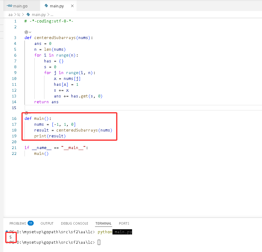

Python完整代码如下:
# -*-coding:utf-8-*-
def centeredSubarrays(nums):
    ans = 0
    n = len(nums)
    for i in range(n):
        has = {}
        s = 0
        for j in range(i, n):
            x = nums[j]
            has[x] = 1
            s += x
            ans += has.get(s, 0)
    return ans
def main():
    nums = [-1, 1, 0]
    result = centeredSubarrays(nums)
    print(result)
if __name__ == "__main__":
    main()

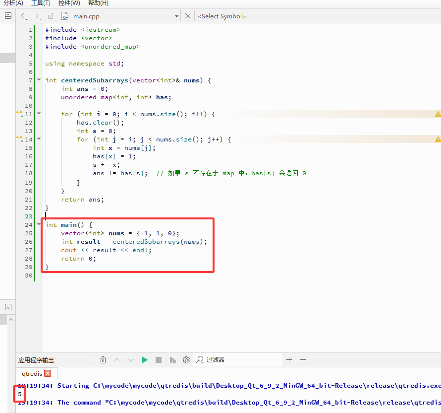

C++完整代码如下:
#include <iostream>
#include <vector>
#include <unordered_map>
using namespace std;
int centeredSubarrays(vector<int>& nums) {
    int ans = 0;
    unordered_map<int, int> has;
    for (int i = 0; i < nums.size(); i++) {
        has.clear();
        int s = 0;
        for (int j = i; j < nums.size(); j++) {
            int x = nums[j];
            has[x] = 1;
            s += x;
            ans += has[s];  // 如果 s 不存在于 map 中,has[s] 会返回 0
    return ans;
int main() {
    vector<int> nums = {-1, 1, 0};
    int result = centeredSubarrays(nums);
    cout << result << endl;
    return 0;
