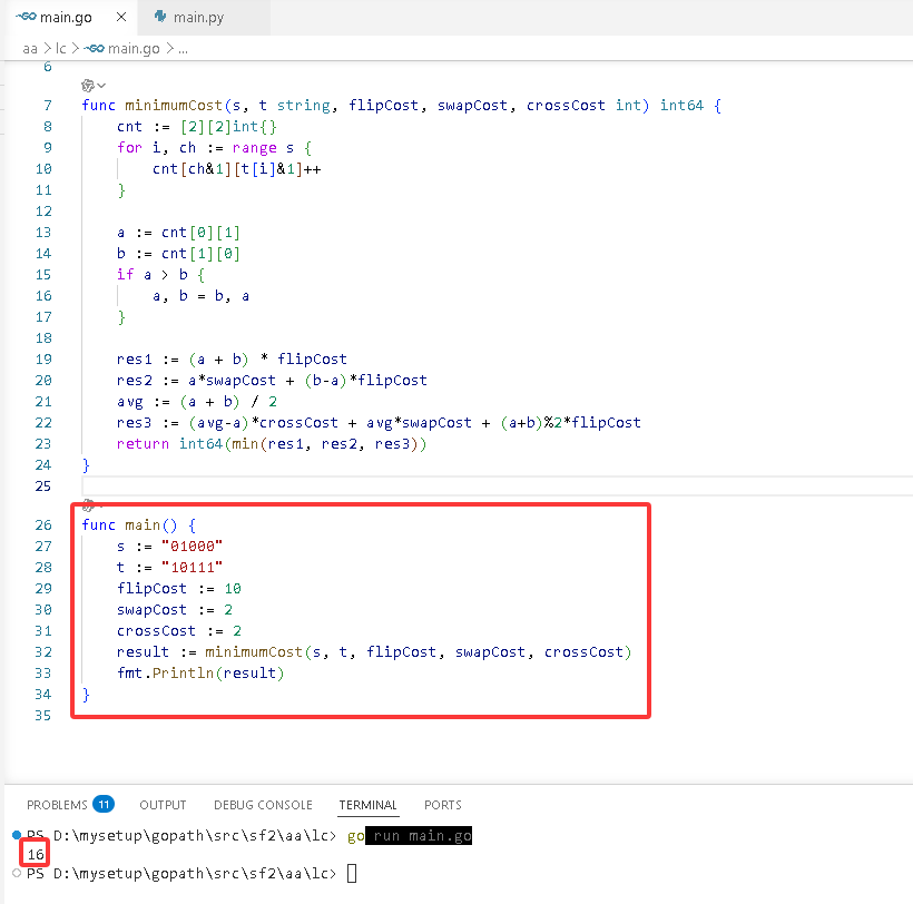

Go完整代码如下:
package main
import (
	"fmt"
func minimumCost(s, t string, flipCost, swapCost, crossCost int) int64 {
	cnt := [2][2]int{}
	for i, ch := range s {
		cnt[ch&1][t[i]&1]++
	a := cnt[0][1]
	b := cnt[1][0]
	if a > b {
		a, b = b, a
	res1 := (a + b) * flipCost
	res2 := a*swapCost + (b-a)*flipCost
	avg := (a + b) / 2
	res3 := (avg-a)*crossCost + avg*swapCost + (a+b)%2*flipCost
	return int64(min(res1, res2, res3))
func main() {
	s := "01000"
	t := "10111"
	flipCost := 10
	swapCost := 2
	crossCost := 2
	result := minimumCost(s, t, flipCost, swapCost, crossCost)
	fmt.Println(result)

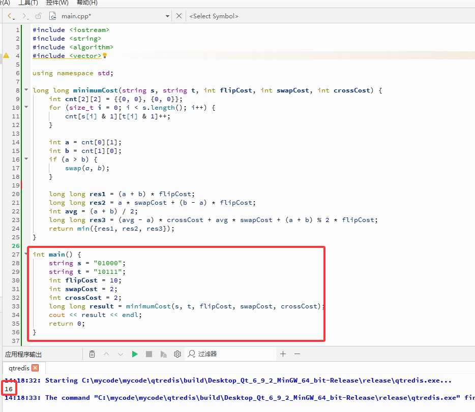

C++完整代码如下:
#include <iostream>
#include <string>
#include <algorithm>
#include <vector>
using namespace std;
long long minimumCost(string s, string t, int flipCost, int swapCost, int crossCost) {
    int cnt[2][2] = {{0, 0}, {0, 0}};
    for (size_t i = 0; i < s.length(); i++) {
        cnt[s[i] & 1][t[i] & 1]++;
    int a = cnt[0][1];
    int b = cnt[1][0];
    if (a > b) {
        swap(a, b);
    long long res1 = (a + b) * flipCost;
    long long res2 = a * swapCost + (b - a) * flipCost;
    int avg = (a + b) / 2;
    long long res3 = (avg - a) * crossCost + avg * swapCost + (a + b) % 2 * flipCost;
    return min({res1, res2, res3});
int main() {
    string s = "01000";
    string t = "10111";
    int flipCost = 10;
    int swapCost = 2;
    int crossCost = 2;
    long long result = minimumCost(s, t, flipCost, swapCost, crossCost);
    cout << result << endl;
    return 0;
