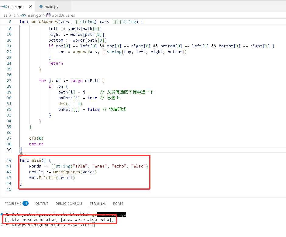

Go完整代码如下:
package main
import (
	"fmt"
	"slices"
func wordSquares(words []string) (ans [][]string) {
	slices.Sort(words) // 保证答案有序
	path := [4]int{}
	onPath := make([]bool, len(words))
	var dfs func(int)
	dfs = func(i int) {
		if i == 4 {
			top := words[path[0]]
			left := words[path[1]]
			right := words[path[2]]
			bottom := words[path[3]]
			if top[0] == left[0] && top[3] == right[0] && bottom[0] == left[3] && bottom[3] == right[3] {
				ans = append(ans, []string{top, left, right, bottom})
			return
		for j, on := range onPath {
			if !on {
				path[i] = j      // 从没有选的下标中选一个
				onPath[j] = true // 已选上
				dfs(i + 1)
				onPath[j] = false // 恢复现场
	dfs(0)
	return
func main() {
	words := []string{"able", "area", "echo", "also"}
	result := wordSquares(words)
	fmt.Println(result)

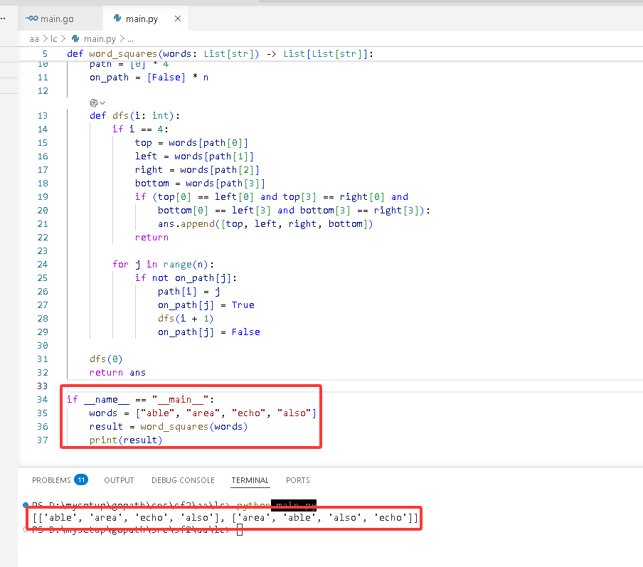

Python完整代码如下:
# -*-coding:utf-8-*-
from typing import List
def word_squares(words: List[str]) -> List[List[str]]:
    words.sort()  # 保证答案有序
    ans = []
    n = len(words)
    path = [0] * 4
    on_path = [False] * n
    def dfs(i: int):
        if i == 4:
            top = words[path[0]]
            left = words[path[1]]
            right = words[path[2]]
            bottom = words[path[3]]
            if (top[0] == left[0] and top[3] == right[0] and
                bottom[0] == left[3] and bottom[3] == right[3]):
                ans.append([top, left, right, bottom])
            return
        for j in range(n):
            if not on_path[j]:
                path[i] = j
                on_path[j] = True
                dfs(i + 1)
                on_path[j] = False
    dfs(0)
    return ans
if __name__ == "__main__":
    words = ["able", "area", "echo", "also"]
    result = word_squares(words)
    print(result)

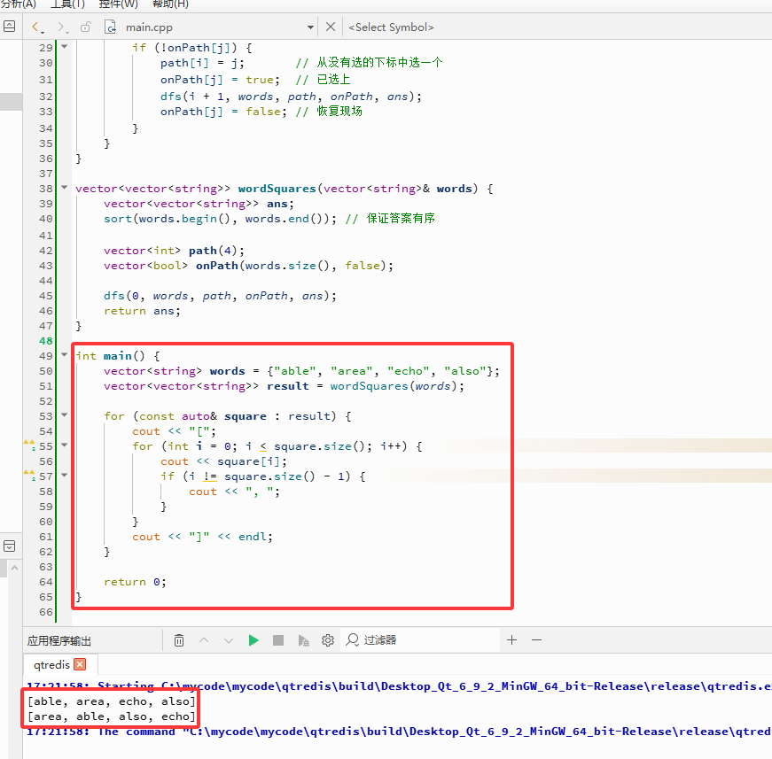

C++完整代码如下:
#include <iostream>
#include <vector>
#include <string>
#include <algorithm>
using namespace std;
void dfs(int i,
         vector<string>& words,
         vector<int>& path,
         vector<bool>& onPath,
         vector<vector<string>>& ans) {
    if (i == 4) {
        string top = words[path[0]];
        string left = words[path[1]];
        string right = words[path[2]];
        string bottom = words[path[3]];
        if (top[0] == left[0] &&
            bottom[3] == right[3]) {
            ans.push_back({top, left, right, bottom});
        return;
    for (int j = 0; j < words.size(); j++) {
        if (!onPath[j]) {
            path[i] = j;       // 从没有选的下标中选一个
            onPath[j] = true;  // 已选上
            dfs(i + 1, words, path, onPath, ans);
            onPath[j] = false; // 恢复现场
vector<vector<string>> wordSquares(vector<string>& words) {
    vector<vector<string>> ans;
    sort(words.begin(), words.end()); // 保证答案有序
    vector<int> path(4);
    vector<bool> onPath(words.size(), false);
    dfs(0, words, path, onPath, ans);
    return ans;
int main() {
    vector<string> words = {"able", "area", "echo", "also"};
    vector<vector<string>> result = wordSquares(words);
    for (const auto& square : result) {
        cout << "[";
        for (int i = 0; i < square.size(); i++) {
            cout << square[i];
            if (i != square.size() - 1) {
                cout << ", ";
        cout << "]" << endl;
    return 0;
