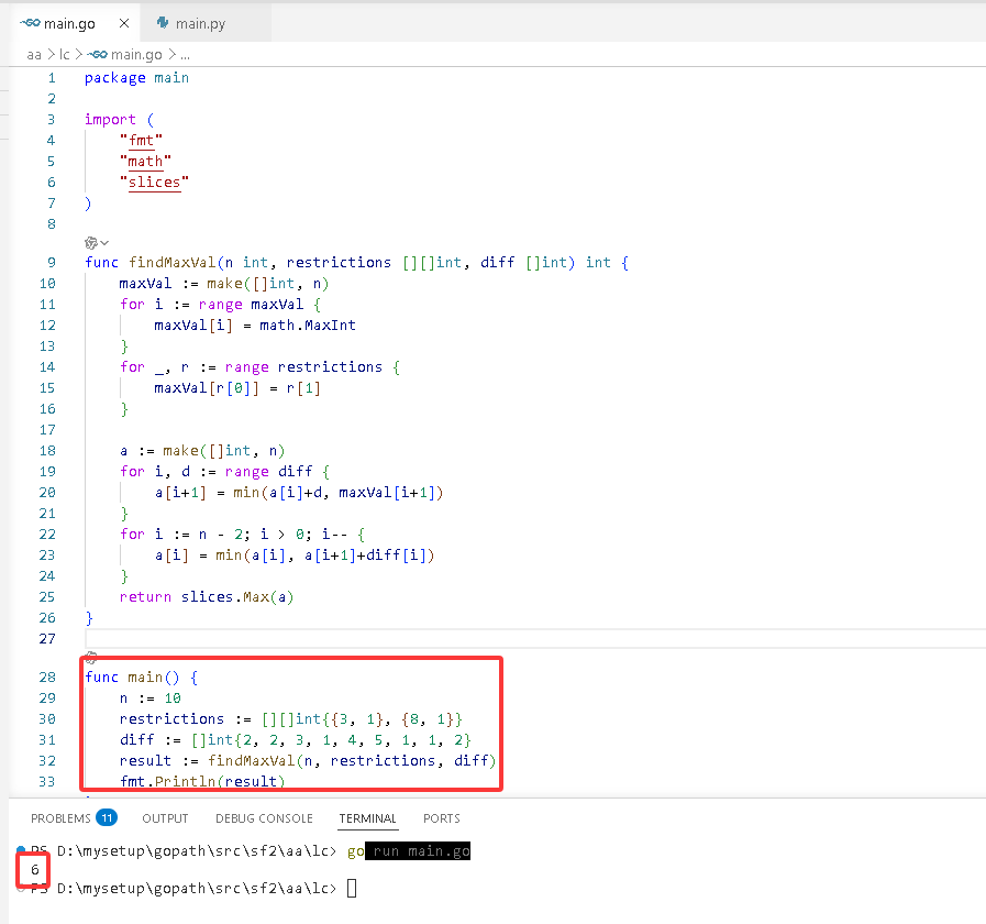

Go完整代码如下:
package main
import (
	"fmt"
	"math"
	"slices"
func findMaxVal(n int, restrictions [][]int, diff []int) int {
	maxVal := make([]int, n)
	for i := range maxVal {
		maxVal[i] = math.MaxInt
	for _, r := range restrictions {
		maxVal[r[0]] = r[1]
	a := make([]int, n)
	for i, d := range diff {
		a[i+1] = min(a[i]+d, maxVal[i+1])
	for i := n - 2; i > 0; i-- {
		a[i] = min(a[i], a[i+1]+diff[i])
	return slices.Max(a)
func main() {
	n := 10
	restrictions := [][]int{{3, 1}, {8, 1}}
	diff := []int{2, 2, 3, 1, 4, 5, 1, 1, 2}
	result := findMaxVal(n, restrictions, diff)
	fmt.Println(result)

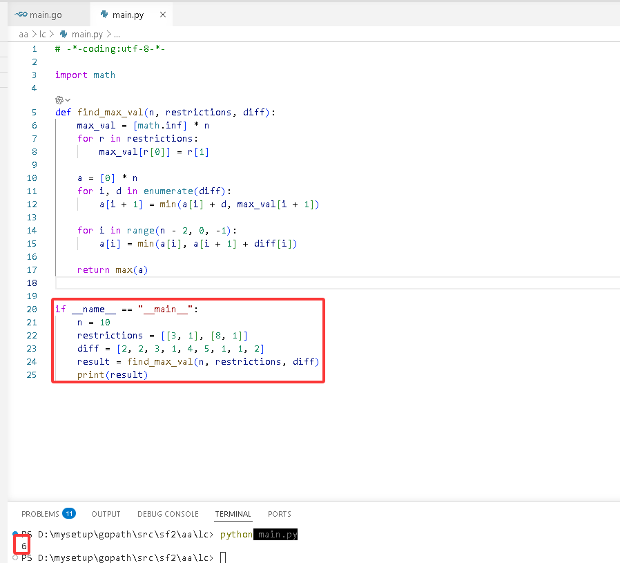

Python完整代码如下:
# -*-coding:utf-8-*-
import math
def find_max_val(n, restrictions, diff):
    max_val = [math.inf] * n
    for r in restrictions:
        max_val[r[0]] = r[1]
    a = [0] * n
    for i, d in enumerate(diff):
        a[i + 1] = min(a[i] + d, max_val[i + 1])
    for i in range(n - 2, 0, -1):
        a[i] = min(a[i], a[i + 1] + diff[i])
    return max(a)
if __name__ == "__main__":
    n = 10
    restrictions = [[3, 1], [8, 1]]
    diff = [2, 2, 3, 1, 4, 5, 1, 1, 2]
    result = find_max_val(n, restrictions, diff)
    print(result)

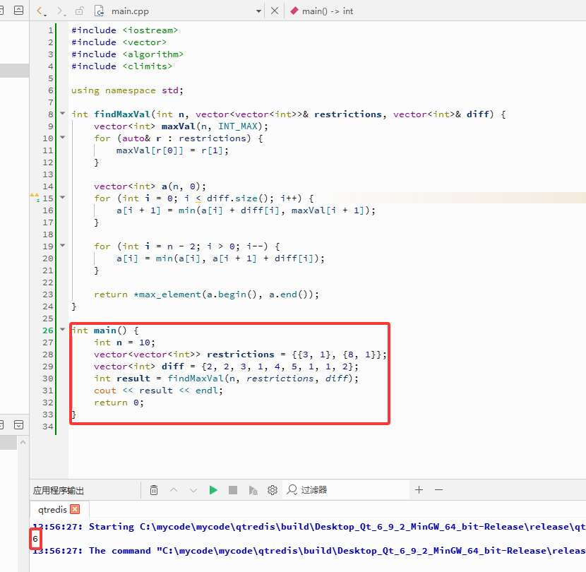

C++完整代码如下:
#include <iostream>
#include <vector>
#include <algorithm>
#include <climits>
using namespace std;
int findMaxVal(int n, vector<vector<int>>& restrictions, vector<int>& diff) {
    vector<int> maxVal(n, INT_MAX);
    for (auto& r : restrictions) {
        maxVal[r[0]] = r[1];
    vector<int> a(n, 0);
    for (int i = 0; i < diff.size(); i++) {
        a[i + 1] = min(a[i] + diff[i], maxVal[i + 1]);
    for (int i = n - 2; i > 0; i--) {
        a[i] = min(a[i], a[i + 1] + diff[i]);
    return *max_element(a.begin(), a.end());
int main() {
    int n = 10;
    vector<vector<int>> restrictions = {{3, 1}, {8, 1}};
    vector<int> diff = {2, 2, 3, 1, 4, 5, 1, 1, 2};
    int result = findMaxVal(n, restrictions, diff);
    cout << result << endl;
    return 0;
