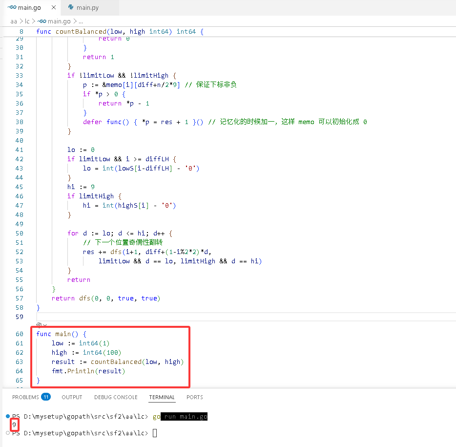

Go完整代码如下:
package main
import (
	"fmt"
	"strconv"
func countBalanced(low, high int64) int64 {
	// 最小的满足要求的数是 11
	if high < 11 {
		return 0
	low = max(low, 11)
	lowS := strconv.FormatInt(low, 10)
	highS := strconv.FormatInt(high, 10)
	n := len(highS)
	diffLH := n - len(lowS)
	memo := make([][]int64, n)
	for i := range memo {
		// diff 至少 floor(n/2) * 9,至多 ceil(n/2) * 9,值域大小 n * 9
		memo[i] = make([]int64, n*9+1)
	var dfs func(int, int, bool, bool) int64
	dfs = func(i, diff int, limitLow, limitHigh bool) (res int64) {
		if i == n {
			if diff != 0 { // 不合法
				return 0
			return 1
		if !limitLow && !limitHigh {
			p := &memo[i][diff+n/2*9] // 保证下标非负
			if *p > 0 {
				return *p - 1
			defer func() { *p = res + 1 }() // 记忆化的时候加一,这样 memo 可以初始化成 0
		lo := 0
		if limitLow && i >= diffLH {
			lo = int(lowS[i-diffLH] - '0')
		hi := 9
		if limitHigh {
			hi = int(highS[i] - '0')
		for d := lo; d <= hi; d++ {
			// 下一个位置奇偶性翻转
			res += dfs(i+1, diff+(1-i%2*2)*d,
				limitLow && d == lo, limitHigh && d == hi)
		return
	return dfs(0, 0, true, true)
func main() {
	low := int64(1)
	high := int64(100)
	result := countBalanced(low, high)
	fmt.Println(result)

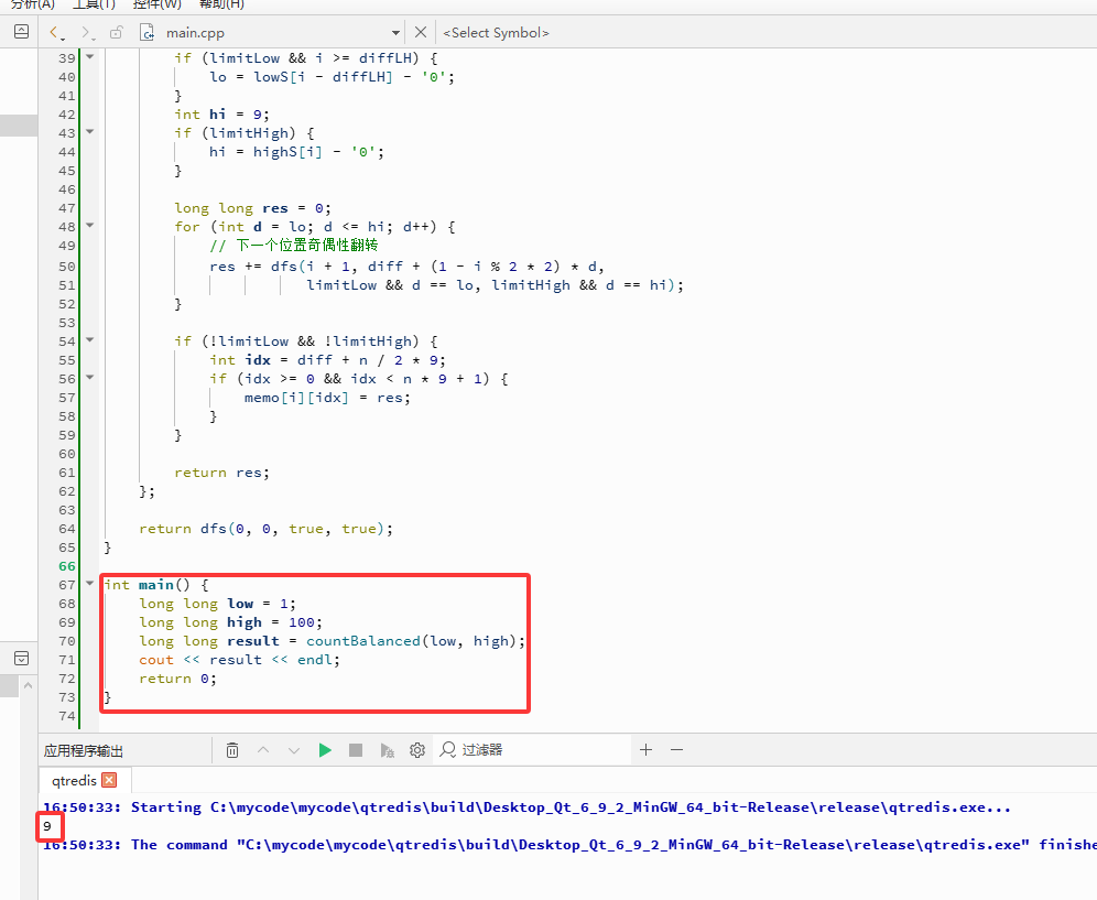

C++完整代码如下:
#include <iostream>
#include <string>
#include <vector>
#include <functional>
#include <algorithm>
#include <cstring>
using namespace std;
long long countBalanced(long long low, long long high) {
    // 最小的满足要求的数是 11
    if (high < 11) {
        return 0;
    low = max(low, 11LL);
    string lowS = to_string(low);
    string highS = to_string(high);
    int n = highS.length();
    int diffLH = n - lowS.length();
    // 初始化记忆化数组,使用 -1 表示未计算
    vector<vector<long long>> memo(n, vector<long long>(n * 9 + 1, -1));
    // 使用函数对象实现递归
    function<long long(int, int, bool, bool)> dfs = [&](int i, int diff, bool limitLow, bool limitHigh) -> long long {
        if (i == n) {
            return diff == 0 ? 1 : 0;
        if (!limitLow && !limitHigh) {
            int idx = diff + n / 2 * 9;
            if (idx >= 0 && idx < n * 9 + 1 && memo[i][idx] != -1) {
                return memo[i][idx];
        int lo = 0;
        if (limitLow && i >= diffLH) {
            lo = lowS[i - diffLH] - '0';
        int hi = 9;
        if (limitHigh) {
            hi = highS[i] - '0';
        long long res = 0;
        for (int d = lo; d <= hi; d++) {
            // 下一个位置奇偶性翻转
            res += dfs(i + 1, diff + (1 - i % 2 * 2) * d,
                       limitLow && d == lo, limitHigh && d == hi);
            if (idx >= 0 && idx < n * 9 + 1) {
                memo[i][idx] = res;
        return res;
    return dfs(0, 0, true, true);
int main() {
    long long low = 1;
    long long high = 100;
    long long result = countBalanced(low, high);
    cout << result << endl;
    return 0;
