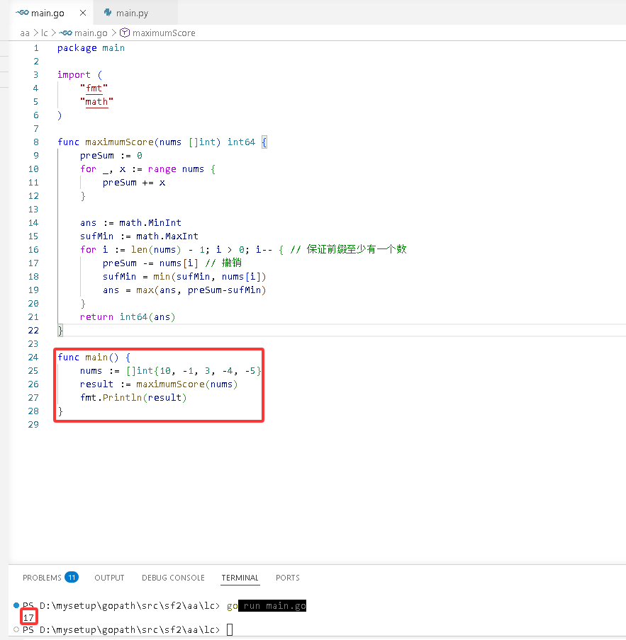

Go完整代码如下:
package main
import (
	"fmt"
	"math"
func maximumScore(nums []int) int64 {
	preSum := 0
	for _, x := range nums {
		preSum += x
	ans := math.MinInt
	sufMin := math.MaxInt
	for i := len(nums) - 1; i > 0; i-- { // 保证前缀至少有一个数
		preSum -= nums[i] // 撤销
		sufMin = min(sufMin, nums[i])
		ans = max(ans, preSum-sufMin)
	return int64(ans)
func main() {
	nums := []int{10, -1, 3, -4, -5}
	result := maximumScore(nums)
	fmt.Println(result)

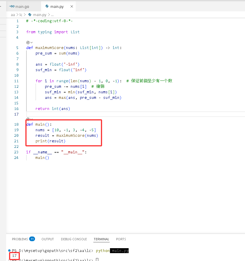

Python完整代码如下:
# -*-coding:utf-8-*-
from typing import List
def maximumScore(nums: List[int]) -> int:
    pre_sum = sum(nums)
    ans = float('-inf')
    suf_min = float('inf')
    for i in range(len(nums) - 1, 0, -1):  # 保证前缀至少有一个数
        pre_sum -= nums[i]  # 撤销
        suf_min = min(suf_min, nums[i])
        ans = max(ans, pre_sum - suf_min)
    return int(ans)
def main():
    nums = [10, -1, 3, -4, -5]
    result = maximumScore(nums)
    print(result)
if __name__ == "__main__":
    main()

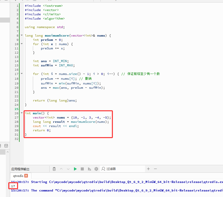

C++完整代码如下:
#include <iostream>
#include <vector>
#include <climits>
#include <algorithm>
using namespace std;
long long maximumScore(vector<int>& nums) {
    int preSum = 0;
    for (int x : nums) {
        preSum += x;
    int ans = INT_MIN;
    int sufMin = INT_MAX;
    for (int i = nums.size() - 1; i > 0; i--) { // 保证前缀至少有一个数
        preSum -= nums[i]; // 撤销
        sufMin = min(sufMin, nums[i]);
        ans = max(ans, preSum - sufMin);
    return (long long)ans;
int main() {
    vector<int> nums = {10, -1, 3, -4, -5};
    long long result = maximumScore(nums);
    cout << result << endl;
    return 0;
