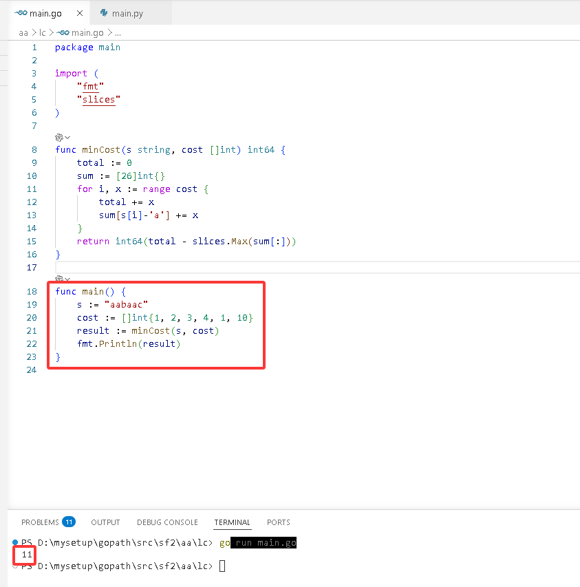

Go完整代码如下:
package main
import (
	"fmt"
	"slices"
func minCost(s string, cost []int) int64 {
	total := 0
	sum := [26]int{}
	for i, x := range cost {
		total += x
		sum[s[i]-'a'] += x
	return int64(total - slices.Max(sum[:]))
func main() {
	s := "aabaac"
	cost := []int{1, 2, 3, 4, 1, 10}
	result := minCost(s, cost)
	fmt.Println(result)

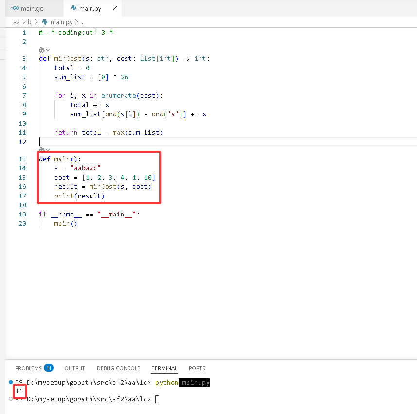

Python完整代码如下:
# -*-coding:utf-8-*-
def minCost(s: str, cost: list[int]) -> int:
    total = 0
    sum_list = [0] * 26
    for i, x in enumerate(cost):
        total += x
        sum_list[ord(s[i]) - ord('a')] += x
    return total - max(sum_list)
def main():
    s = "aabaac"
    cost = [1, 2, 3, 4, 1, 10]
    result = minCost(s, cost)
    print(result)
if __name__ == "__main__":
    main()

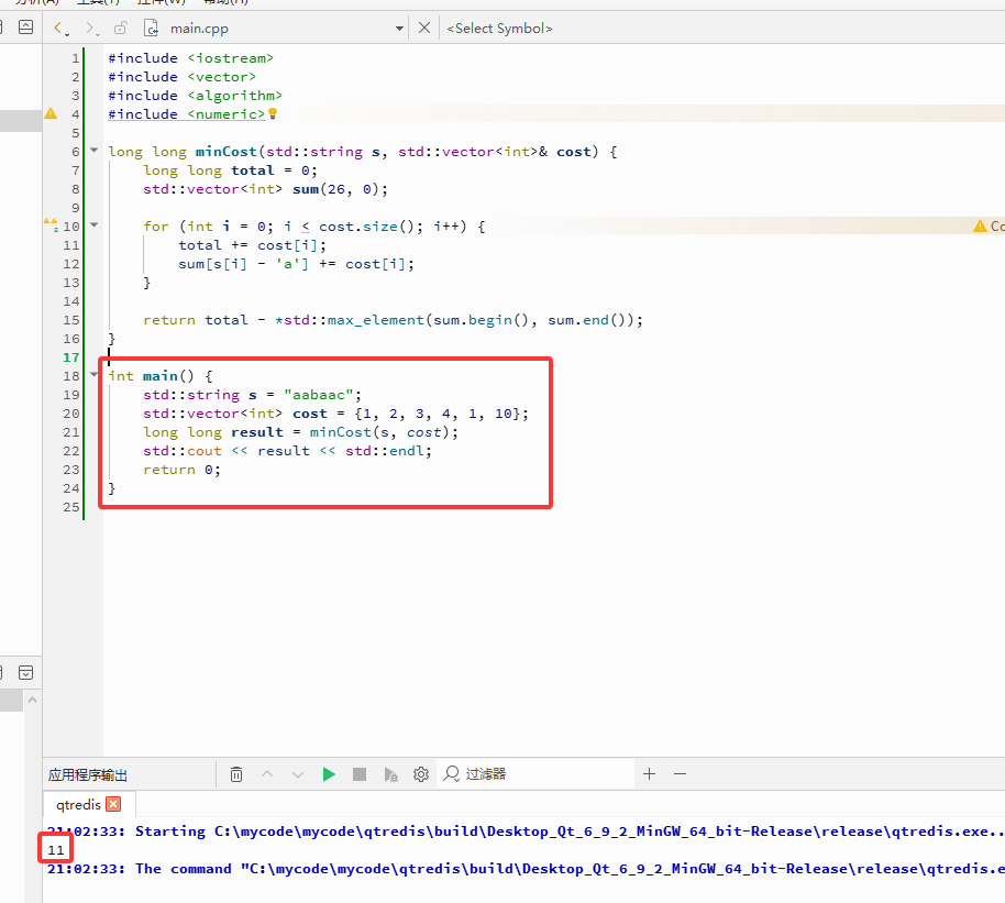

C++完整代码如下:
#include <iostream>
#include <vector>
#include <algorithm>
#include <numeric>
long long minCost(std::string s, std::vector<int>& cost) {
    long long total = 0;
    std::vector<int> sum(26, 0);
    for (int i = 0; i < cost.size(); i++) {
        total += cost[i];
        sum[s[i] - 'a'] += cost[i];
    return total - *std::max_element(sum.begin(), sum.end());
int main() {
    std::string s = "aabaac";
    std::vector<int> cost = {1, 2, 3, 4, 1, 10};
    long long result = minCost(s, cost);
    std::cout << result << std::endl;
    return 0;
