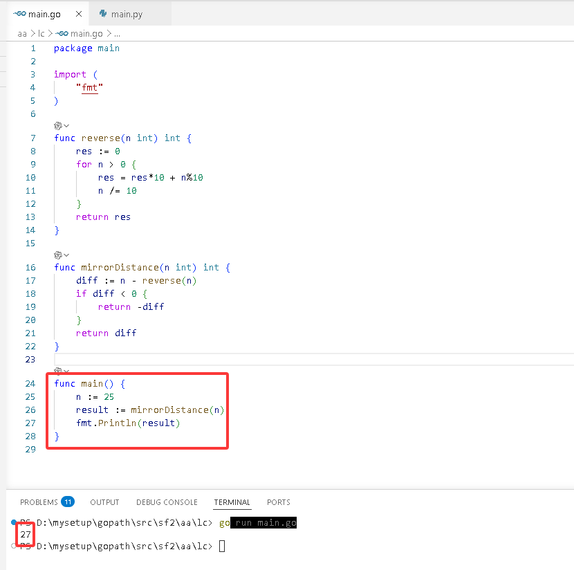

Go完整代码如下:
package main
import (
	"fmt"
func reverse(n int) int {
	res := 0
	for n > 0 {
		res = res*10 + n%10
		n /= 10
	return res
func mirrorDistance(n int) int {
	diff := n - reverse(n)
	if diff < 0 {
		return -diff
	return diff
func main() {
	n := 25
	result := mirrorDistance(n)
	fmt.Println(result)

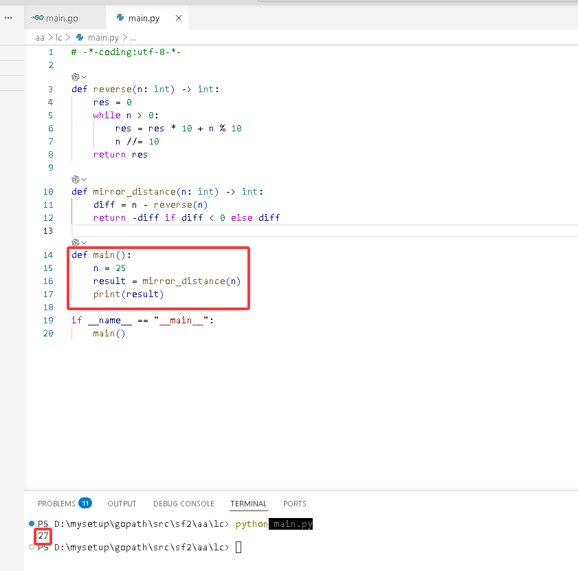

Python完整代码如下:
# -*-coding:utf-8-*-
def reverse(n: int) -> int:
    res = 0
    while n > 0:
        res = res * 10 + n % 10
        n //= 10
    return res
def mirror_distance(n: int) -> int:
    diff = n - reverse(n)
    return -diff if diff < 0 else diff
def main():
    n = 25
    result = mirror_distance(n)
    print(result)
if __name__ == "__main__":
    main()

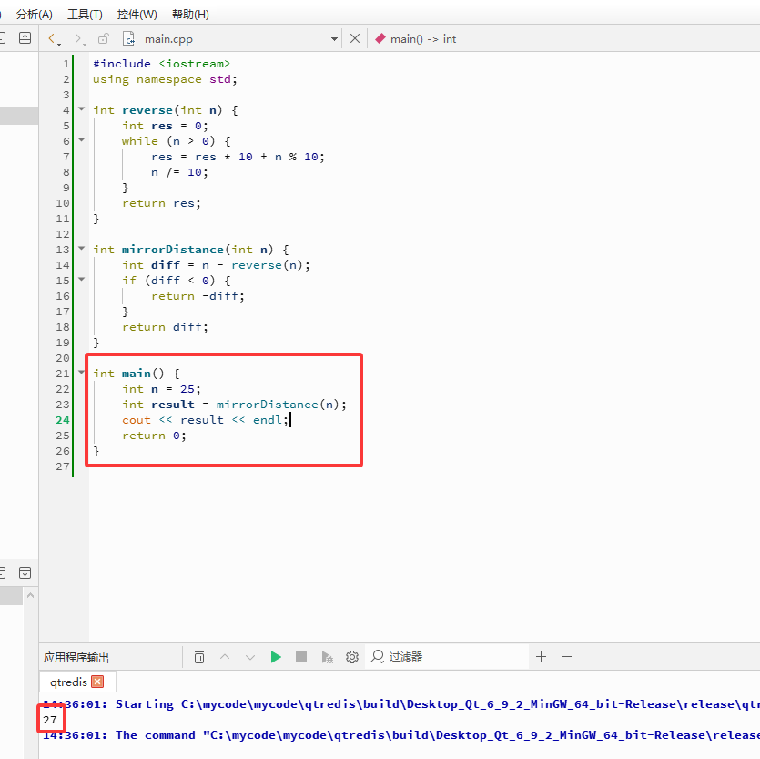

C++完整代码如下:
#include <iostream>
using namespace std;
int reverse(int n) {
    int res = 0;
    while (n > 0) {
        res = res * 10 + n % 10;
        n /= 10;
    return res;
int mirrorDistance(int n) {
    int diff = n - reverse(n);
    if (diff < 0) {
        return -diff;
    return diff;
int main() {
    int n = 25;
    int result = mirrorDistance(n);
    cout << result << endl;
    return 0;
