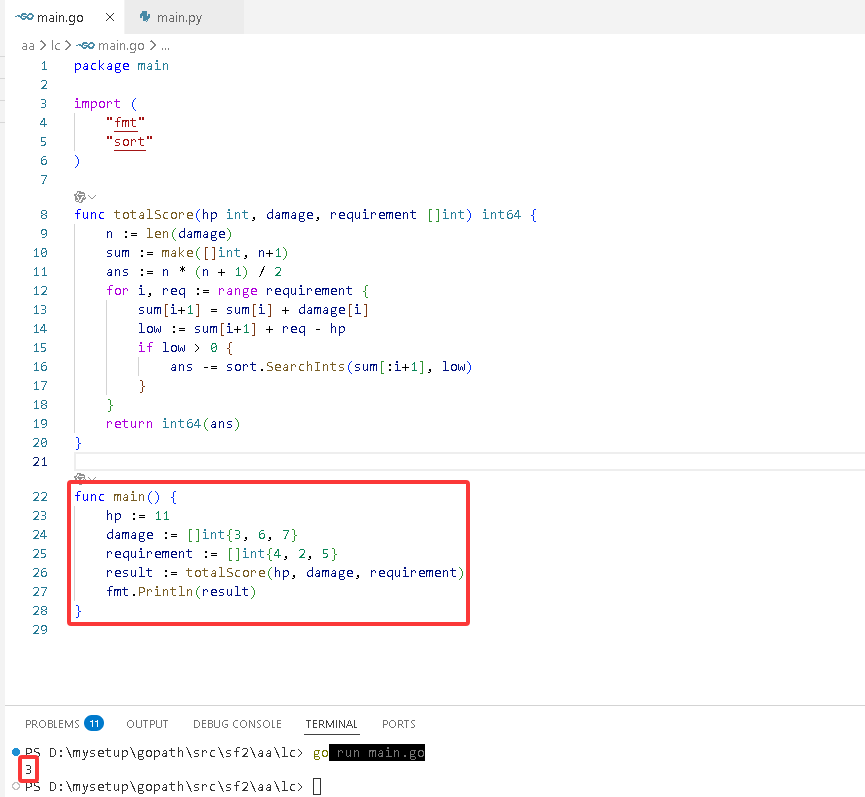

Go完整代码如下:
package main
import (
	"fmt"
	"sort"
func totalScore(hp int, damage, requirement []int) int64 {
	n := len(damage)
	sum := make([]int, n+1)
	ans := n * (n + 1) / 2
	for i, req := range requirement {
		sum[i+1] = sum[i] + damage[i]
		low := sum[i+1] + req - hp
		if low > 0 {
			ans -= sort.SearchInts(sum[:i+1], low)
	return int64(ans)
func main() {
	hp := 11
	damage := []int{3, 6, 7}
	requirement := []int{4, 2, 5}
	result := totalScore(hp, damage, requirement)
	fmt.Println(result)

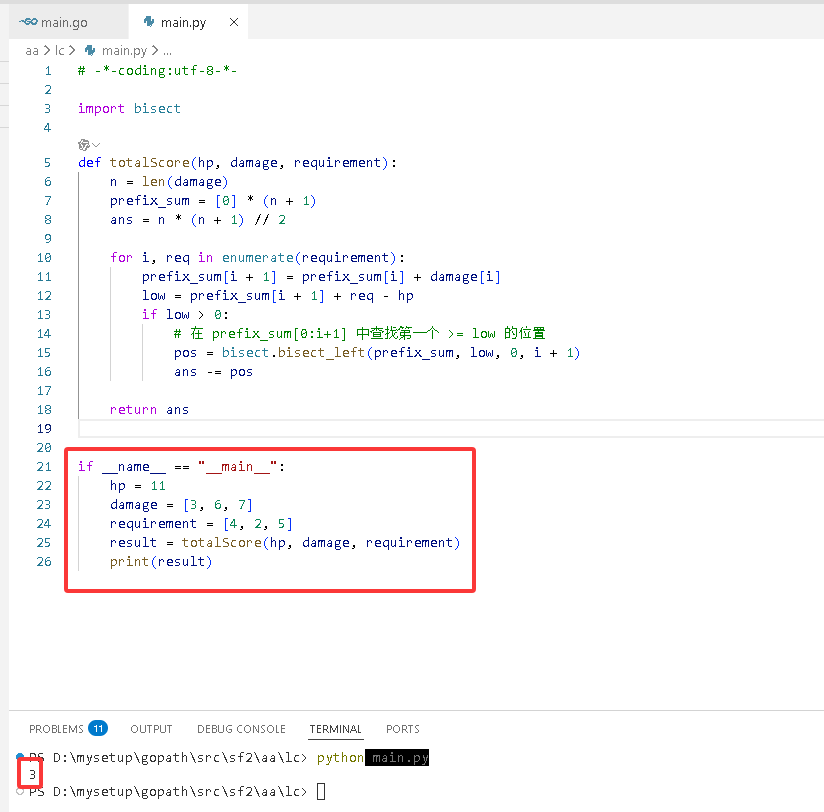

Python完整代码如下:
# -*-coding:utf-8-*-
import bisect
def totalScore(hp, damage, requirement):
    n = len(damage)
    prefix_sum = [0] * (n + 1)
    ans = n * (n + 1) // 2
    for i, req in enumerate(requirement):
        prefix_sum[i + 1] = prefix_sum[i] + damage[i]
        low = prefix_sum[i + 1] + req - hp
        if low > 0:
            # 在 prefix_sum[0:i+1] 中查找第一个 >= low 的位置
            pos = bisect.bisect_left(prefix_sum, low, 0, i + 1)
            ans -= pos
    return ans
if __name__ == "__main__":
    hp = 11
    damage = [3, 6, 7]
    requirement = [4, 2, 5]
    result = totalScore(hp, damage, requirement)
    print(result)

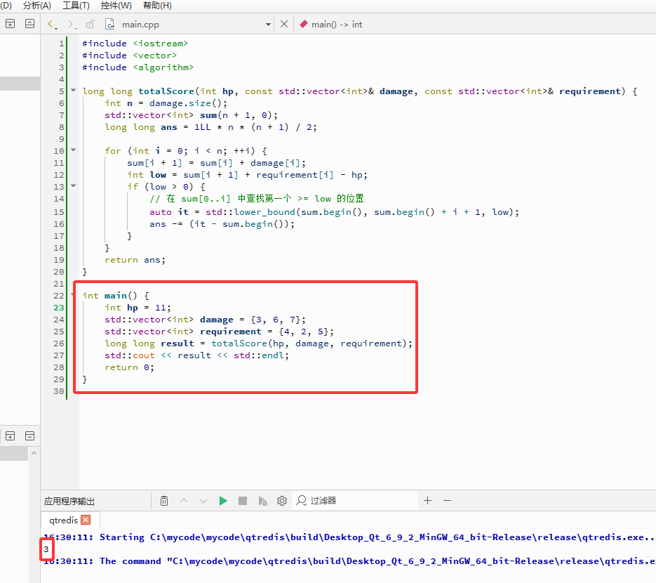

C++完整代码如下:
#include <iostream>
#include <vector>
#include <algorithm>
long long totalScore(int hp, const std::vector<int>& damage, const std::vector<int>& requirement) {
    int n = damage.size();
    std::vector<int> sum(n + 1, 0);
    long long ans = 1LL * n * (n + 1) / 2;
    for (int i = 0; i < n; ++i) {
        sum[i + 1] = sum[i] + damage[i];
        int low = sum[i + 1] + requirement[i] - hp;
        if (low > 0) {
            // 在 sum[0..i] 中查找第一个 >= low 的位置
            auto it = std::lower_bound(sum.begin(), sum.begin() + i + 1, low);
            ans -= (it - sum.begin());
    return ans;
int main() {
    int hp = 11;
    std::vector<int> damage = {3, 6, 7};
    std::vector<int> requirement = {4, 2, 5};
    long long result = totalScore(hp, damage, requirement);
    std::cout << result << std::endl;
    return 0;
