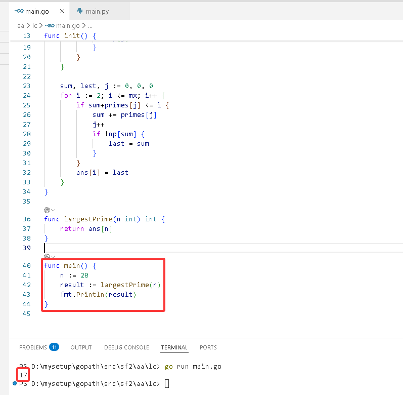

Go完整代码如下:
package main
import (
	"fmt"
const mx = 500_000
var primes []int
var np [mx + 1]bool
var ans [mx + 1]int
func init() {
	for i := 2; i <= mx; i++ {
		if !np[i] {
			primes = append(primes, i)
			for j := i * i; j <= mx; j += i {
				np[j] = true
	sum, last, j := 0, 0, 0
		if sum+primes[j] <= i {
			sum += primes[j]
			j++
			if !np[sum] {
				last = sum
		ans[i] = last
func largestPrime(n int) int {
	return ans[n]
func main() {
	n := 20
	result := largestPrime(n)
	fmt.Println(result)

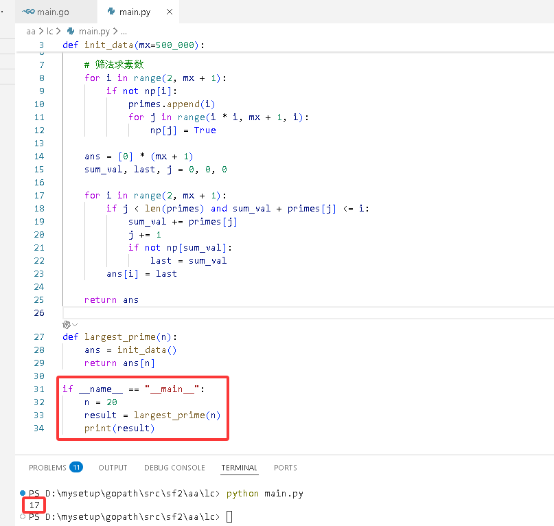

Python完整代码如下:
# -*-coding:utf-8-*-
def init_data(mx=500_000):
    primes = []
    np = [False] * (mx + 1)
    # 筛法求素数
    for i in range(2, mx + 1):
        if not np[i]:
            primes.append(i)
            for j in range(i * i, mx + 1, i):
                np[j] = True
    ans = [0] * (mx + 1)
    sum_val, last, j = 0, 0, 0
        if j < len(primes) and sum_val + primes[j] <= i:
            sum_val += primes[j]
            j += 1
            if not np[sum_val]:
                last = sum_val
        ans[i] = last
    return ans
def largest_prime(n):
    ans = init_data()
    return ans[n]
if __name__ == "__main__":
    n = 20
    result = largest_prime(n)
    print(result)

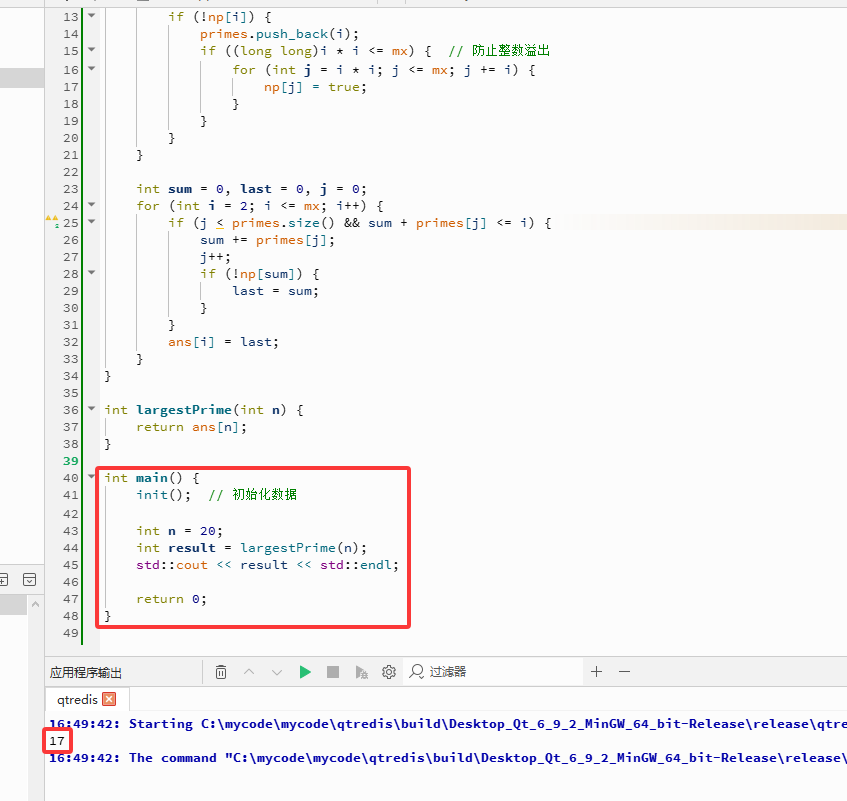

C++完整代码如下:
#include <iostream>
#include <vector>
const int mx = 500000;
std::vector<int> primes;
std::vector<bool> np(mx + 1, false);
std::vector<int> ans(mx + 1, 0);
void init() {
    // 筛法求素数
    for (int i = 2; i <= mx; i++) {
        if (!np[i]) {
            primes.push_back(i);
            if ((long long)i * i <= mx) {  // 防止整数溢出
                for (int j = i * i; j <= mx; j += i) {
                    np[j] = true;
    int sum = 0, last = 0, j = 0;
        if (j < primes.size() && sum + primes[j] <= i) {
            sum += primes[j];
            j++;
            if (!np[sum]) {
                last = sum;
        ans[i] = last;
int largestPrime(int n) {
    return ans[n];
int main() {
    init();  // 初始化数据
    int n = 20;
    int result = largestPrime(n);
    std::cout << result << std::endl;
    return 0;
