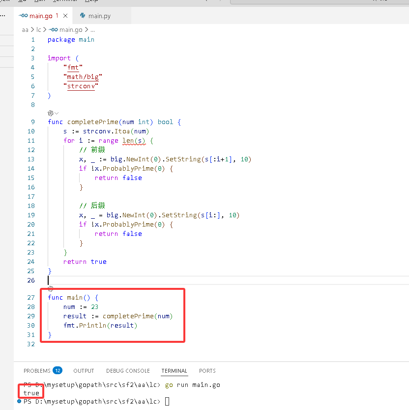

Go完整代码如下:
package main
import (
	"fmt"
	"math/big"
	"strconv"
func completePrime(num int) bool {
	s := strconv.Itoa(num)
	for i := range len(s) {
		// 前缀
		x, _ := big.NewInt(0).SetString(s[:i+1], 10)
		if !x.ProbablyPrime(0) {
			return false
		// 后缀
		x, _ = big.NewInt(0).SetString(s[i:], 10)
			return false
	return true
func main() {
	num := 23
	result := completePrime(num)
	fmt.Println(result)

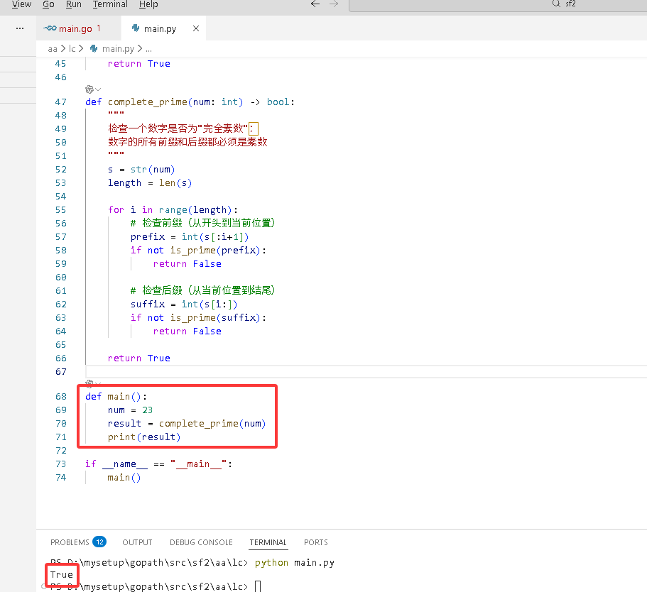

Python完整代码如下:
# -*-coding:utf-8-*-
import math
def is_prime(n: int) -> bool:
    """判断一个整数是否为素数"""
    if n < 2:
        return False
    if n == 2:
        return True
    if n % 2 == 0:
        return False
    # 使用Miller-Rabin素性测试,这里使用确定性版本处理小数字
    # 对于int范围内的数字,测试这些基数就足够了
    if n < 2:
        return False
    small_primes = [2, 3, 5, 7, 11, 13, 17, 19, 23, 29]
    if n in small_primes:
        return True
    d = n - 1
    s = 0
    while d % 2 == 0:
        d //= 2
        s += 1
    def check_composite(a):
        x = pow(a, d, n)
        if x == 1 or x == n - 1:
            return False
        for _ in range(s - 1):
            x = pow(x, 2, n)
            if x == n - 1:
                return False
        return True
    # 对于小于2^64的数字,这些基数足够
    test_bases = [2, 325, 9375, 28178, 450775, 9780504, 1795265022]
    for a in test_bases:
        if a % n == 0:
            continue
        if check_composite(a):
            return False
    return True
def complete_prime(num: int) -> bool:
    检查一个数字是否为"完全素数":
    数字的所有前缀和后缀都必须是素数
    s = str(num)
    length = len(s)
    for i in range(length):
        # 检查前缀(从开头到当前位置)
        prefix = int(s[:i+1])
        if not is_prime(prefix):
            return False
        # 检查后缀(从当前位置到结尾)
        suffix = int(s[i:])
        if not is_prime(suffix):
            return False
    return True
def main():
    num = 23
    result = complete_prime(num)
    print(result)
if __name__ == "__main__":
    main()

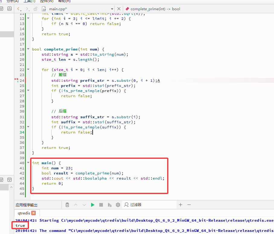

C++完整代码如下:
#include <iostream>
#include <string>
#include <cmath>
// 简单的试除法素性测试(适用于较小的数字)
bool is_prime_simple(int n) {
    if (n < 2) return false;
    if (n == 2) return true;
    if (n % 2 == 0) return false;
    int limit = static_cast<int>(std::sqrt(n));
    for (int i = 3; i <= limit; i += 2) {
        if (n % i == 0) return false;
    return true;
bool complete_prime(int num) {
    std::string s = std::to_string(num);
    size_t len = s.length();
    for (size_t i = 0; i < len; i++) {
        // 前缀
        std::string prefix_str = s.substr(0, i + 1);
        int prefix = std::stoi(prefix_str);
        if (!is_prime_simple(prefix)) {
            return false;
        // 后缀
        std::string suffix_str = s.substr(i);
        int suffix = std::stoi(suffix_str);
        if (!is_prime_simple(suffix)) {
            return false;
    return true;
int main() {
    int num = 23;
    bool result = complete_prime(num);
    std::cout << std::boolalpha << result << std::endl;
    return 0;
