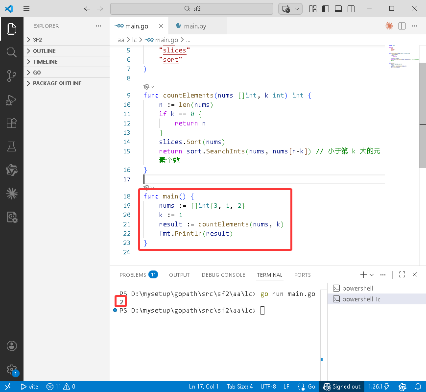

Go完整代码如下:
package main
import (
	"fmt"
	"slices"
	"sort"
func countElements(nums []int, k int) int {
	n := len(nums)
	if k == 0 {
		return n
	slices.Sort(nums)
	return sort.SearchInts(nums, nums[n-k]) // 小于第 k 大的元素个数
func main() {
	nums := []int{3, 1, 2}
	k := 1
	result := countElements(nums, k)
	fmt.Println(result)

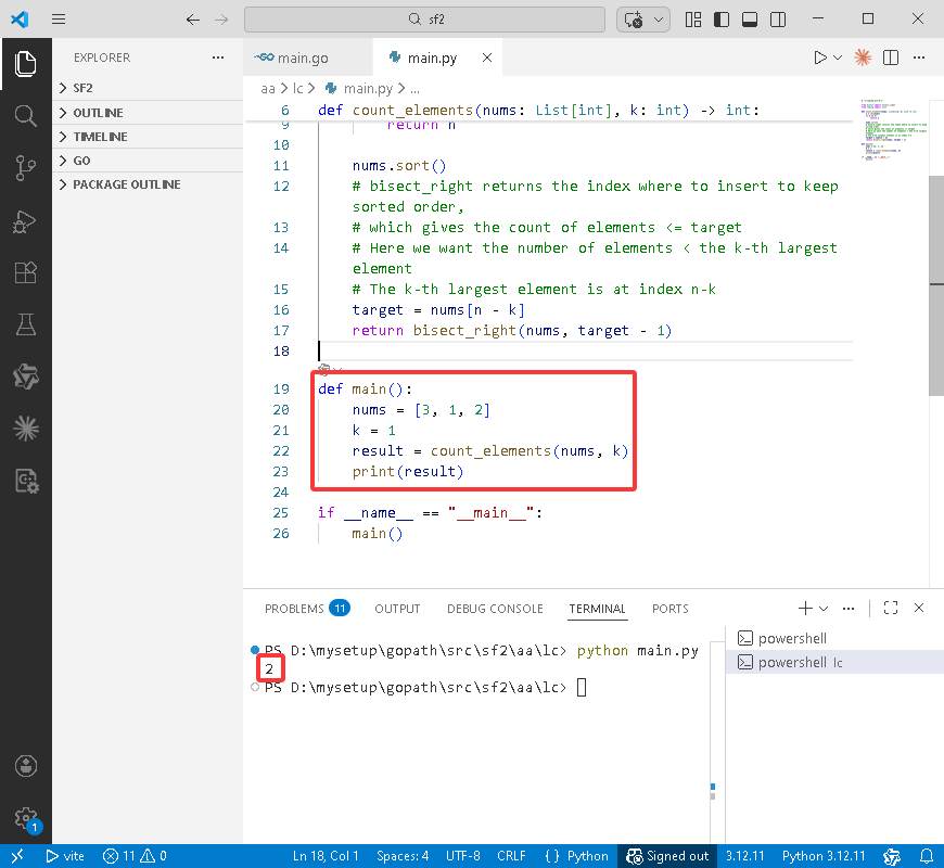

Python完整代码如下:
# -*-coding:utf-8-*-
from bisect import bisect_right
from typing import List
def count_elements(nums: List[int], k: int) -> int:
    n = len(nums)
    if k == 0:
        return n
    nums.sort()
    # bisect_right returns the index where to insert to keep sorted order,
    # which gives the count of elements <= target
    # Here we want the number of elements < the k-th largest element
    # The k-th largest element is at index n-k
    target = nums[n - k]
    return bisect_right(nums, target - 1)
def main():
    nums = [3, 1, 2]
    k = 1
    result = count_elements(nums, k)
    print(result)
if __name__ == "__main__":
    main()

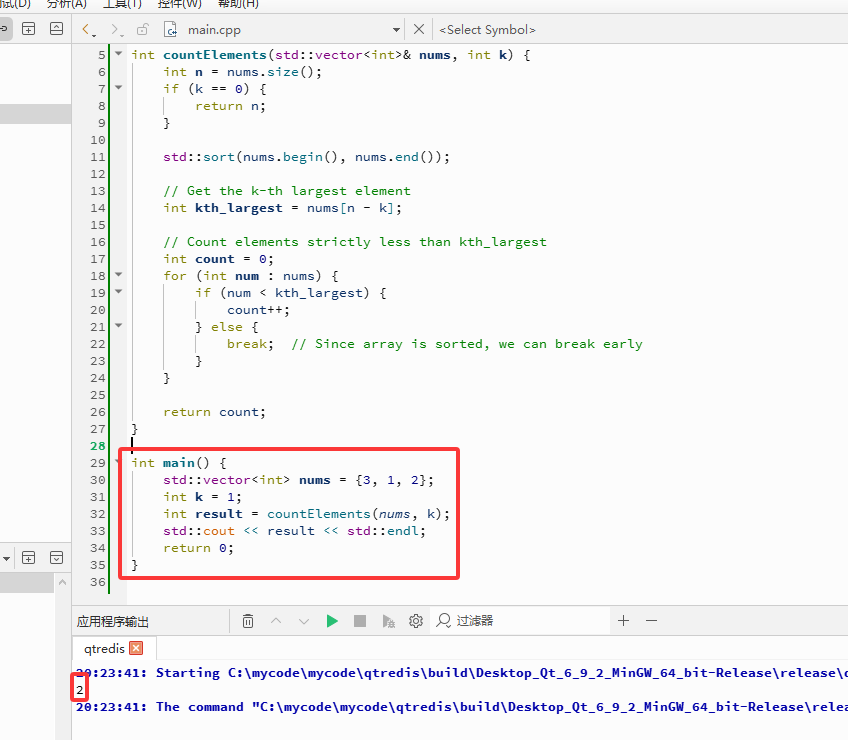

C++完整代码如下:
#include <iostream>
#include <vector>
#include <algorithm>
int countElements(std::vector<int>& nums, int k) {
    int n = nums.size();
    if (k == 0) {
        return n;
    std::sort(nums.begin(), nums.end());
    // Get the k-th largest element
    int kth_largest = nums[n - k];
    // Count elements strictly less than kth_largest
    int count = 0;
    for (int num : nums) {
        if (num < kth_largest) {
            count++;
        } else {
            break;  // Since array is sorted, we can break early
    return count;
int main() {
    std::vector<int> nums = {3, 1, 2};
    int k = 1;
    int result = countElements(nums, k);
    std::cout << result << std::endl;
    return 0;
