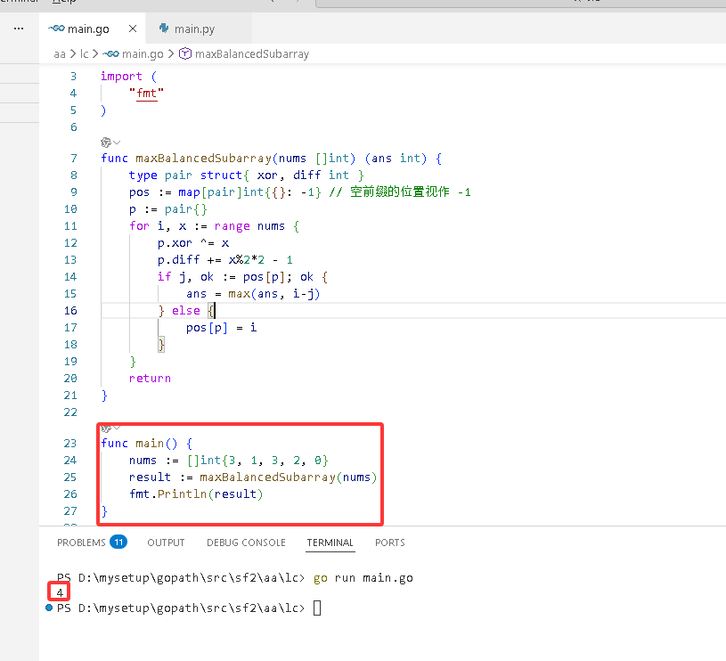

Go完整代码如下:
package main
import (
	"fmt"
func maxBalancedSubarray(nums []int) (ans int) {
	type pair struct{ xor, diff int }
	pos := map[pair]int{{}: -1} // 空前缀的位置视作 -1
	p := pair{}
	for i, x := range nums {
		p.xor ^= x
		p.diff += x%2*2 - 1
		if j, ok := pos[p]; ok {
			ans = max(ans, i-j)
		} else {
			pos[p] = i
	return
func main() {
	nums := []int{3, 1, 3, 2, 0}
	result := maxBalancedSubarray(nums)
	fmt.Println(result)

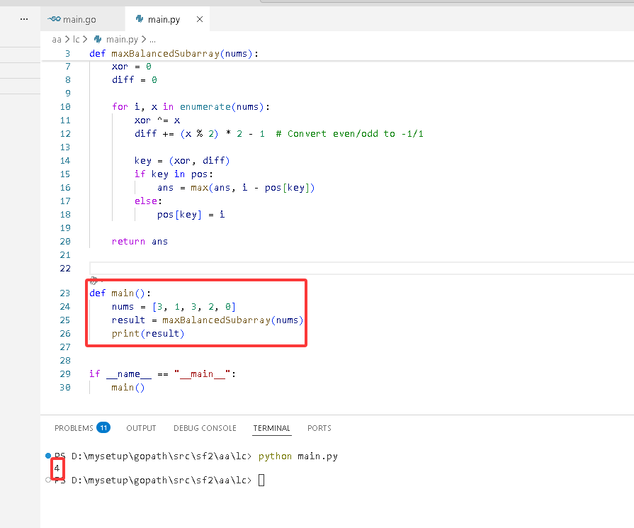

Python完整代码如下:
# -*-coding:utf-8-*-
def maxBalancedSubarray(nums):
    ans = 0
    # Use a dictionary to store the first occurrence of each (xor, diff) pair
    pos = {(0, 0): -1}  # Empty prefix position is -1
    xor = 0
    diff = 0
    for i, x in enumerate(nums):
        xor ^= x
        diff += (x % 2) * 2 - 1  # Convert even/odd to -1/1
        key = (xor, diff)
        if key in pos:
            ans = max(ans, i - pos[key])
        else:
            pos[key] = i
    return ans
def main():
    nums = [3, 1, 3, 2, 0]
    result = maxBalancedSubarray(nums)
    print(result)
if __name__ == "__main__":
    main()

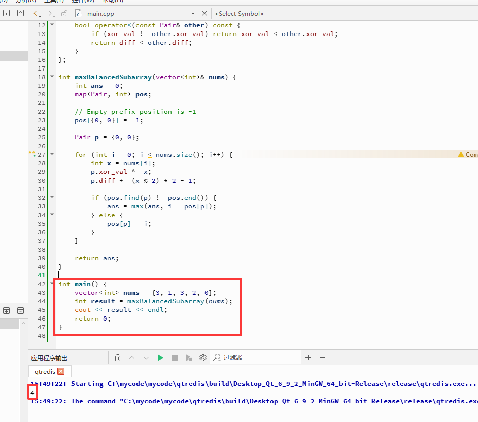

C++完整代码如下:
#include <iostream>
#include <vector>
#include <map>
#include <algorithm>
using namespace std;
struct Pair {
    int xor_val;
    int diff;
    bool operator<(const Pair& other) const {
        if (xor_val != other.xor_val) return xor_val < other.xor_val;
        return diff < other.diff;
int maxBalancedSubarray(vector<int>& nums) {
    int ans = 0;
    map<Pair, int> pos;
    // Empty prefix position is -1
    pos[{0, 0}] = -1;
    Pair p = {0, 0};
    for (int i = 0; i < nums.size(); i++) {
        int x = nums[i];
        p.xor_val ^= x;
        p.diff += (x % 2) * 2 - 1;
        if (pos.find(p) != pos.end()) {
            ans = max(ans, i - pos[p]);
        } else {
            pos[p] = i;
    return ans;
int main() {
    vector<int> nums = {3, 1, 3, 2, 0};
    int result = maxBalancedSubarray(nums);
    cout << result << endl;
    return 0;
