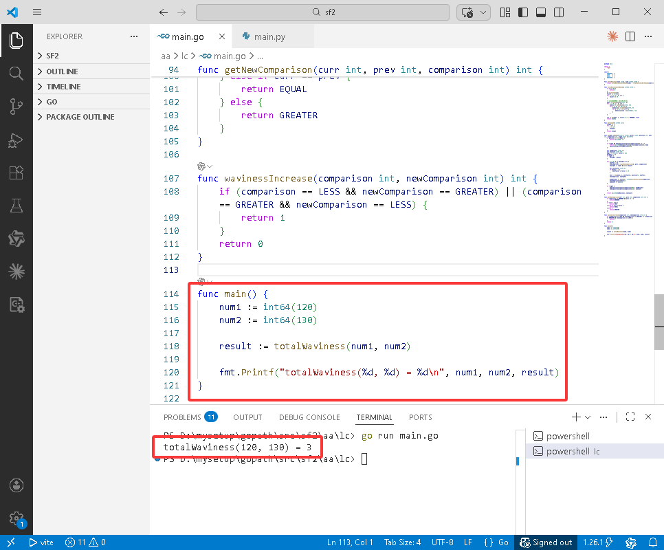

Go完整代码如下:
package main
import (
	"fmt"
const (
	UNKNOWN = 0
	LESS    = 1
	EQUAL   = 2
	GREATER = 3
func totalWaviness(num1 int64, num2 int64) int64 {
	return totalWavinessWithBound(num2) - totalWavinessWithBound(num1-1)
func totalWavinessWithBound(n int64) int64 {
	if n <= 100 {
		return 0
	m := getLength(n)
	factor := int64(1)
	for i := 1; i < m; i++ {
		factor *= 10
	// 创建memo数组: [m][10][4][2]
	memo := make([][][][]int64, m)
	for i := 0; i < m; i++ {
		memo[i] = make([][][]int64, 10)
		for j := 0; j < 10; j++ {
			memo[i][j] = make([][]int64, 4)
			for k := 0; k < 4; k++ {
				memo[i][j][k] = []int64{-1, -1}
	res := dp(memo, n, factor, 0, 0, UNKNOWN, true)
	return res[0]
func getLength(n int64) int {
	length := 0
	for n > 0 {
		n /= 10
		length++
	return length
func dp(memo [][][][]int64, n int64, factor int64, position int, prev int, comparison int, tight bool) []int64 {
	if position == len(memo) {
		return []int64{0, 1}
	if !tight && memo[position][prev][comparison][0] >= 0 {
		return []int64{memo[position][prev][comparison][0], memo[position][prev][comparison][1]}
	var newWaviness int64 = 0
	var newCount int64 = 0
	digit := int(n / factor % 10)
	maxDigit := 9
	if tight {
		maxDigit = digit
	for d := 0; d <= maxDigit; d++ {
		newPrev := d
		newComparison := getNewComparison(d, prev, comparison)
		newTight := tight && (d == digit)
		var nextFactor int64 = 1
		if factor > 1 {
			nextFactor = factor / 10
		next := dp(memo, n, nextFactor, position+1, newPrev, newComparison, newTight)
		newWaviness += next[0] + int64(wavinessIncrease(comparison, newComparison))*next[1]
		newCount += next[1]
	if !tight {
		memo[position][prev][comparison][0] = newWaviness
		memo[position][prev][comparison][1] = newCount
	return []int64{newWaviness, newCount}
func getNewComparison(curr int, prev int, comparison int) int {
	if comparison == UNKNOWN && prev == 0 {
		return UNKNOWN
	if curr < prev {
		return LESS
	} else if curr == prev {
		return EQUAL
	} else {
		return GREATER
func wavinessIncrease(comparison int, newComparison int) int {
	if (comparison == LESS && newComparison == GREATER) || (comparison == GREATER && newComparison == LESS) {
		return 1
	return 0
func main() {
	num1 := int64(120)
	num2 := int64(130)
	result := totalWaviness(num1, num2)
	fmt.Printf("totalWaviness(%d, %d) = %d\n", num1, num2, result)

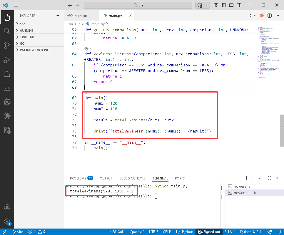

Python完整代码如下:
# -*-coding:utf-8-*-
def total_waviness(num1: int, num2: int) -> int:
    return total_waviness_with_bound(num2) - total_waviness_with_bound(num1 - 1)
def total_waviness_with_bound(n: int) -> int:
    UNKNOWN, LESS, EQUAL, GREATER = 0, 1, 2, 3
    if n <= 100:
        return 0
    m = get_length(n)
    factor = 10 ** (m - 1)
    # 创建memo字典,因为Python的多维列表初始化比较复杂
    from functools import lru_cache
    @lru_cache(maxsize=None)
    def dp(position: int, prev: int, comparison: int, tight: bool) -> tuple:
        if position == m:
            return (0, 1)
        new_waviness = 0
        new_count = 0
        digit = (n // factor) % 10 if position == 0 else (n // (10 ** (m - position - 1))) % 10
        max_digit = digit if tight else 9
        for d in range(max_digit + 1):
            new_prev = d
            new_comparison = get_new_comparison(d, prev, comparison, UNKNOWN)
            new_tight = tight and (d == digit)
            next_waviness, next_count = dp(position + 1, new_prev, new_comparison, new_tight)
            new_waviness += next_waviness + waviness_increase(comparison, new_comparison, LESS, GREATER) * next_count
            new_count += next_count
        return (new_waviness, new_count)
    result, _ = dp(0, 0, UNKNOWN, True)
    return result
def get_length(n: int) -> int:
    length = 0
    while n > 0:
        n //= 10
        length += 1
    return length if length > 0 else 1
def get_new_comparison(curr: int, prev: int, comparison: int, UNKNOWN: int) -> int:
    LESS, EQUAL, GREATER = 1, 2, 3
    if comparison == UNKNOWN and prev == 0:
        return UNKNOWN
    if curr < prev:
        return LESS
    elif curr == prev:
        return EQUAL
    else:
        return GREATER
def waviness_increase(comparison: int, new_comparison: int, LESS: int, GREATER: int) -> int:
    if (comparison == LESS and new_comparison == GREATER) or (comparison == GREATER and new_comparison == LESS):
        return 1
    return 0
def main():
    num1 = 120
    num2 = 130
    result = total_waviness(num1, num2)
    print(f"totalWaviness({num1}, {num2}) = {result}")
if __name__ == "__main__":
    main()

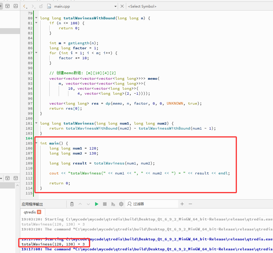

C++完整代码如下:
#include <iostream>
#include <vector>
#include <cstring>
using namespace std;
const int UNKNOWN = 0;
const int LESS = 1;
const int EQUAL = 2;
const int GREATER = 3;
int getNewComparison(int curr, int prev, int comparison) {
    if (comparison == UNKNOWN && prev == 0) {
        return UNKNOWN;
    if (curr < prev) {
        return LESS;
    } else if (curr == prev) {
        return EQUAL;
    } else {
        return GREATER;
int wavinessIncrease(int comparison, int newComparison) {
    if ((comparison == LESS && newComparison == GREATER) ||
        (comparison == GREATER && newComparison == LESS)) {
        return 1;
    return 0;
int getLength(long long n) {
    int length = 0;
    while (n > 0) {
        n /= 10;
        length++;
    return length;
// memo[position][prev][comparison][0] = waviness, [1] = count
vector<long long> dp(vector<vector<vector<vector<long long>>>>& memo,
                     long long n, long long factor,
                     int position, int prev, int comparison, bool tight) {
    if (position == memo.size()) {
        return {0, 1};
    if (!tight && memo[position][prev][comparison][0] >= 0) {
        return {memo[position][prev][comparison][0], memo[position][prev][comparison][1]};
    long long newWaviness = 0;
    long long newCount = 0;
    int digit = (n / factor) % 10;
    int maxDigit = tight ? digit : 9;
    for (int d = 0; d <= maxDigit; d++) {
        int newPrev = d;
        int newComparison = getNewComparison(d, prev, comparison);
        bool newTight = tight && (d == digit);
        long long nextFactor = (factor > 1) ? factor / 10 : 1;
        vector<long long> next = dp(memo, n, nextFactor, position + 1,
                                    newPrev, newComparison, newTight);
        newWaviness += next[0] + wavinessIncrease(comparison, newComparison) * next[1];
        newCount += next[1];
    if (!tight) {
        memo[position][prev][comparison][0] = newWaviness;
        memo[position][prev][comparison][1] = newCount;
    return {newWaviness, newCount};
long long totalWavinessWithBound(long long n) {
    if (n <= 100) {
        return 0;
    int m = getLength(n);
    long long factor = 1;
    for (int i = 1; i < m; i++) {
        factor *= 10;
    vector<vector<vector<vector<long long>>>> memo(
        m, vector<vector<vector<long long>>>(
            10, vector<vector<long long>>(
                4, vector<long long>(2, -1))));
    vector<long long> res = dp(memo, n, factor, 0, 0, UNKNOWN, true);
    return res[0];
long long totalWaviness(long long num1, long long num2) {
    return totalWavinessWithBound(num2) - totalWavinessWithBound(num1 - 1);
int main() {
    long long num1 = 120;
    long long num2 = 130;
    long long result = totalWaviness(num1, num2);
    cout << "totalWaviness(" << num1 << ", " << num2 << ") = " << result << endl;
    return 0;
