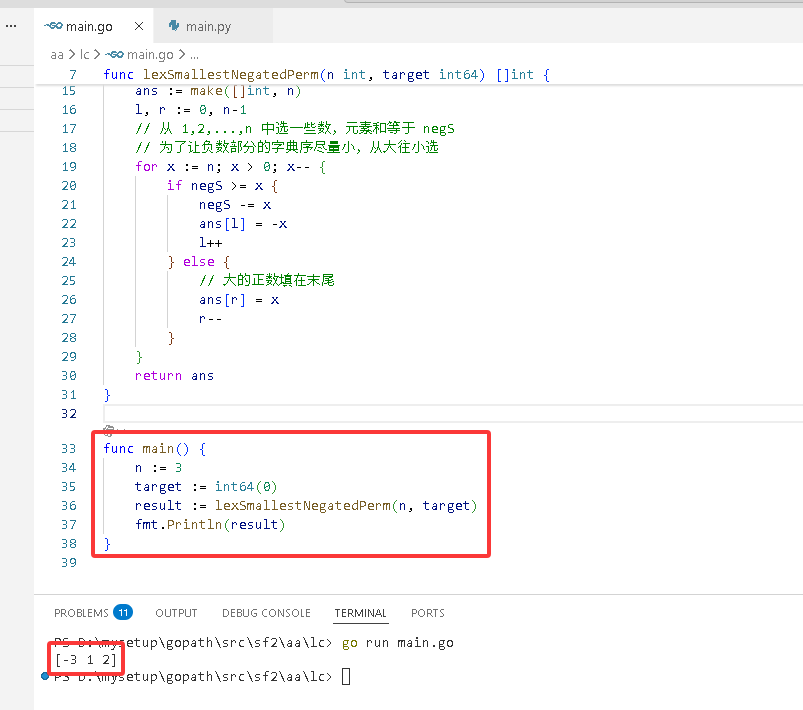

Go完整代码如下:
package main
import (
	"fmt"
func lexSmallestNegatedPerm(n int, target int64) []int {
	t := int(target)
	mx := n * (n + 1) / 2
	if t > mx || -t > mx || (mx-t)%2 != 0 {
		return nil
	negS := (mx - t) / 2 // 取负号的元素(的绝对值)之和
	ans := make([]int, n)
	l, r := 0, n-1
	// 从 1,2,...,n 中选一些数,元素和等于 negS
	// 为了让负数部分的字典序尽量小,从大往小选
	for x := n; x > 0; x-- {
		if negS >= x {
			negS -= x
			ans[l] = -x
			l++
		} else {
			// 大的正数填在末尾
			ans[r] = x
			r--
	return ans
func main() {
	n := 3
	target := int64(0)
	result := lexSmallestNegatedPerm(n, target)
	fmt.Println(result)

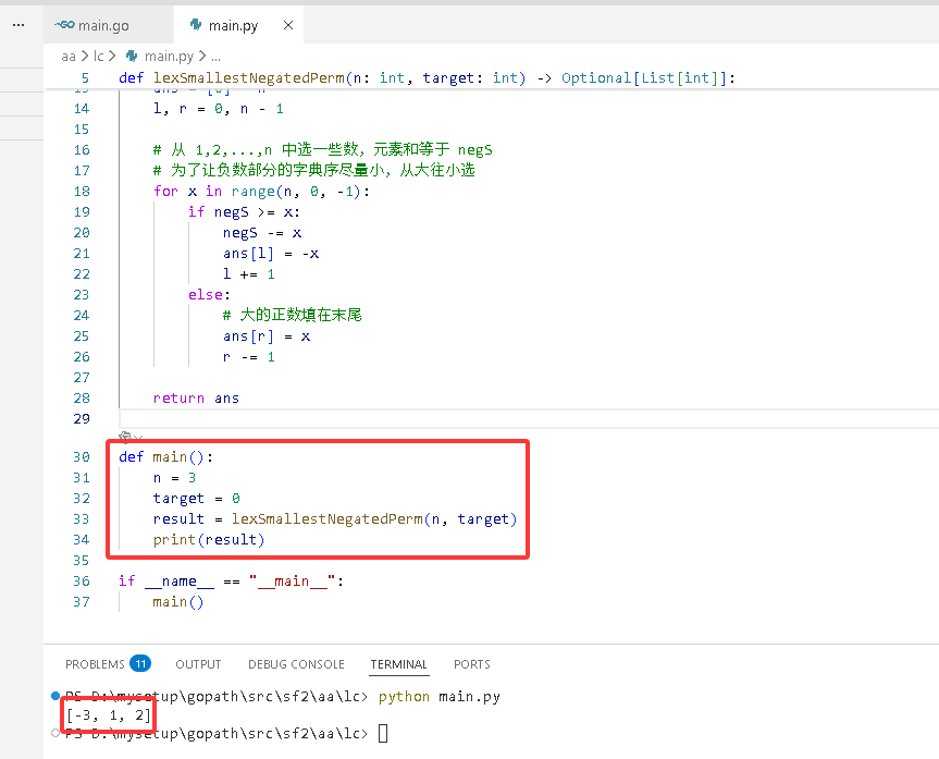

Python完整代码如下:
# -*-coding:utf-8-*-
from typing import List, Optional
def lexSmallestNegatedPerm(n: int, target: int) -> Optional[List[int]]:
    t = target
    mx = n * (n + 1) // 2
    if t > mx or -t > mx or (mx - t) % 2 != 0:
        return None
    negS = (mx - t) // 2  # 取负号的元素(的绝对值)之和
    ans = [0] * n
    l, r = 0, n - 1
    # 从 1,2,...,n 中选一些数,元素和等于 negS
    # 为了让负数部分的字典序尽量小,从大往小选
    for x in range(n, 0, -1):
        if negS >= x:
            negS -= x
            ans[l] = -x
            l += 1
        else:
            # 大的正数填在末尾
            ans[r] = x
            r -= 1
    return ans
def main():
    n = 3
    target = 0
    result = lexSmallestNegatedPerm(n, target)
    print(result)
if __name__ == "__main__":
    main()

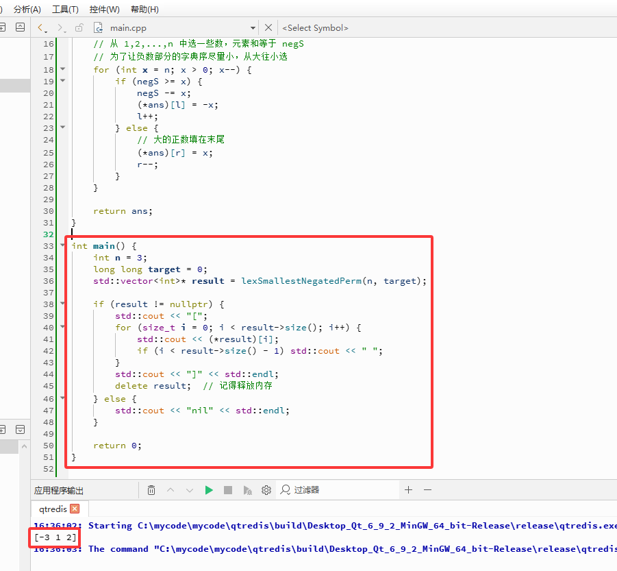

C++完整代码如下:
#include <iostream>
#include <vector>
std::vector<int>* lexSmallestNegatedPerm(int n, long long target) {
    int t = static_cast<int>(target);
    int mx = n * (n + 1) / 2;
    if (t > mx || -t > mx || (mx - t) % 2 != 0) {
        return nullptr;
    int negS = (mx - t) / 2;  // 取负号的元素(的绝对值)之和
    std::vector<int>* ans = new std::vector<int>(n);
    int l = 0, r = n - 1;
    for (int x = n; x > 0; x--) {
        if (negS >= x) {
            negS -= x;
            (*ans)[l] = -x;
            l++;
        } else {
            // 大的正数填在末尾
            (*ans)[r] = x;
            r--;
    return ans;
int main() {
    int n = 3;
    long long target = 0;
    std::vector<int>* result = lexSmallestNegatedPerm(n, target);
    if (result != nullptr) {
        std::cout << "[";
        for (size_t i = 0; i < result->size(); i++) {
            std::cout << (*result)[i];
            if (i < result->size() - 1) std::cout << " ";
        std::cout << "]" << std::endl;
        delete result;  // 记得释放内存
    } else {
        std::cout << "nil" << std::endl;
    return 0;
