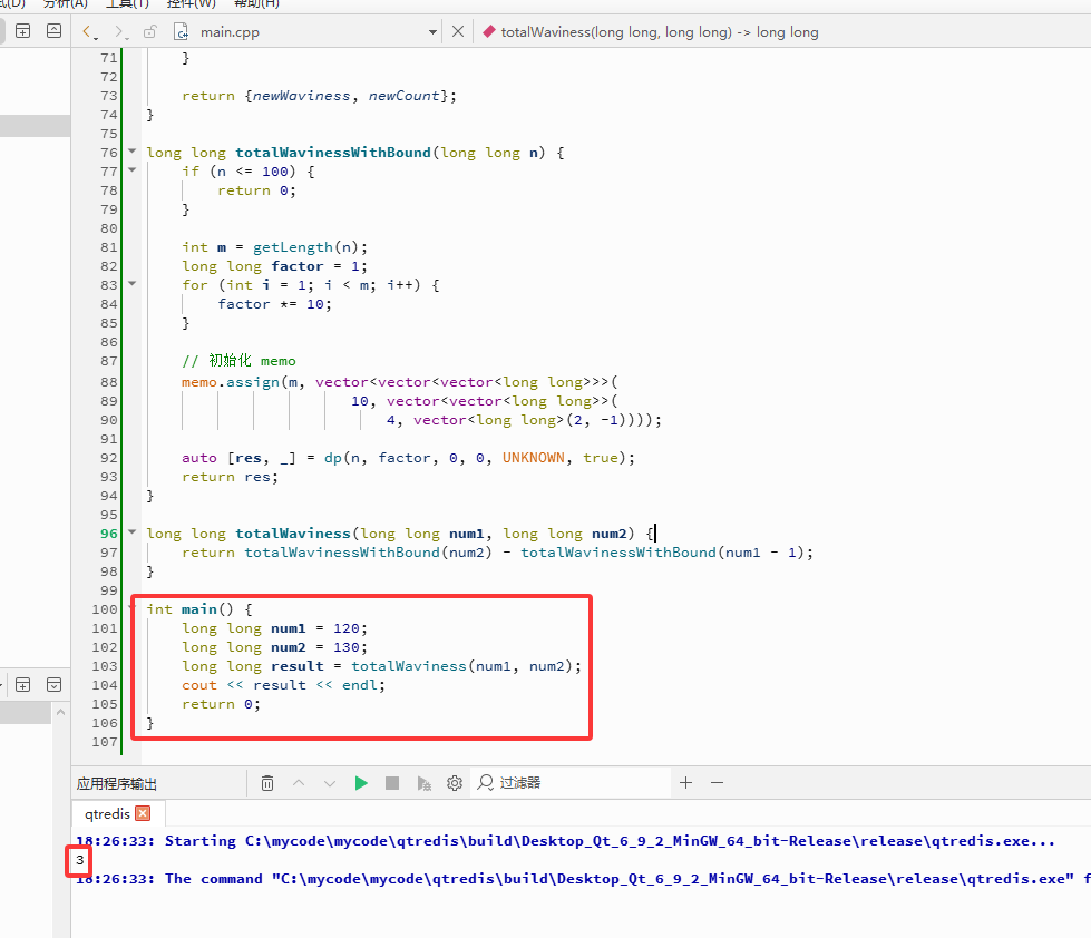

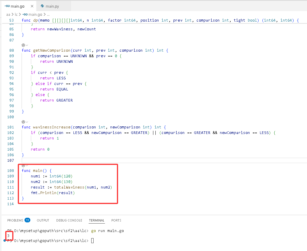

Go完整代码如下:
package main

func main() {
	num1 := int64(120)
	num2 := int64(130)
	result := totalWaviness(num1, num2)
	fmt.Println(result)

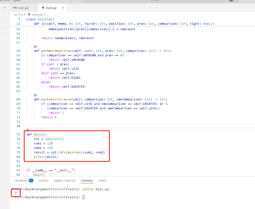

Python完整代码如下:
# -*-coding:utf-8-*-
class Solution:
    UNKNOWN = 0
    LESS = 1
    EQUAL = 2
    GREATER = 3
    def totalWaviness(self, num1: int, num2: int) -> int:
        return self.totalWavinessWithBound(num2) - self.totalWavinessWithBound(num1 - 1)
    def totalWavinessWithBound(self, n: int) -> int:
        if n <= 100:
            return 0
        m = self.getLength(n)
        factor = 10 ** (m - 1)
        # memo[position][prev][comparison] = [waviness, count] for non-tight states
        memo = [[[[-1, -1] for _ in range(4)] for _ in range(10)] for _ in range(m)]
        res, _ = self.dp(memo, n, factor, 0, 0, self.UNKNOWN, True)
        return res
    def getLength(self, n: int) -> int:
        length = 0
        while n > 0:
            n //= 10
            length += 1
        return length
    def dp(self, memo, n: int, factor: int, position: int, prev: int, comparison: int, tight: bool):
        if position == len(memo):
            return 0, 1
        if not tight and memo[position][prev][comparison][0] >= 0:
            return memo[position][prev][comparison][0], memo[position][prev][comparison][1]
        newWaviness = 0
        newCount = 0
        digit = (n // factor) % 10
        maxDigit = digit if tight else 9
        for d in range(maxDigit + 1):
            newPrev = d
            newComparison = self.getNewComparison(d, prev, comparison)
            newTight = tight and (d == digit)
            nextWav, nextCount = self.dp(memo, n, factor // 10, position + 1, newPrev, newComparison, newTight)
            newWaviness += nextWav + self.wavinessIncrease(comparison, newComparison) * nextCount
            newCount += nextCount
        if not tight:
            memo[position][prev][comparison][0] = newWaviness
            memo[position][prev][comparison][1] = newCount
        return newWaviness, newCount
    def getNewComparison(self, curr: int, prev: int, comparison: int) -> int:
        if comparison == self.UNKNOWN and prev == 0:
            return self.UNKNOWN
        if curr < prev:
            return self.LESS
        elif curr == prev:
            return self.EQUAL
        else:
            return self.GREATER
    def wavinessIncrease(self, comparison: int, newComparison: int) -> int:
        if (comparison == self.LESS and newComparison == self.GREATER) or \
           (comparison == self.GREATER and newComparison == self.LESS):
            return 1
        return 0
def main():
    sol = Solution()
    num1 = 120
    num2 = 130
    result = sol.totalWaviness(num1, num2)
    print(result)
if __name__ == "__main__":
    main()

long long totalWaviness(long long num1, long long num2) {
    return totalWavinessWithBound(num2) - totalWavinessWithBound(num1 - 1);
int main() {
    long long num1 = 120;
    long long num2 = 130;
    long long result = totalWaviness(num1, num2);
    cout << result << endl;
    return 0;
