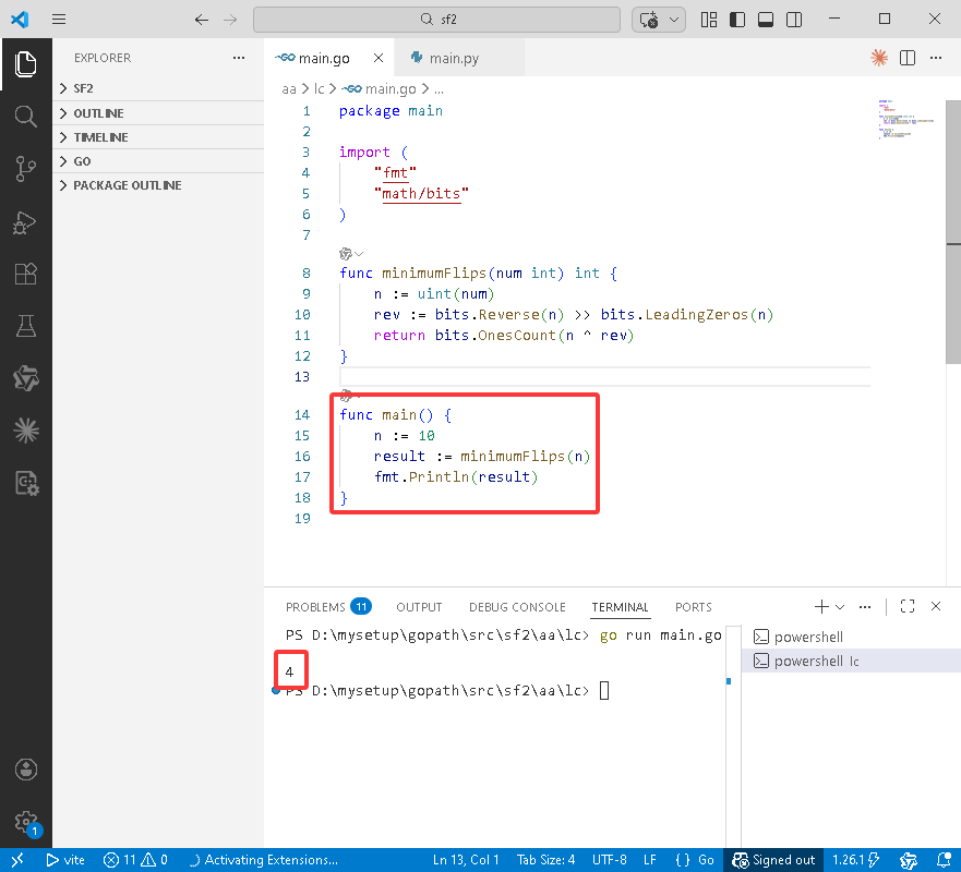

Go完整代码如下:
package main
import (
	"fmt"
	"math/bits"
func minimumFlips(num int) int {
	n := uint(num)
	rev := bits.Reverse(n) >> bits.LeadingZeros(n)
	return bits.OnesCount(n ^ rev)
func main() {
	n := 10
	result := minimumFlips(n)
	fmt.Println(result)

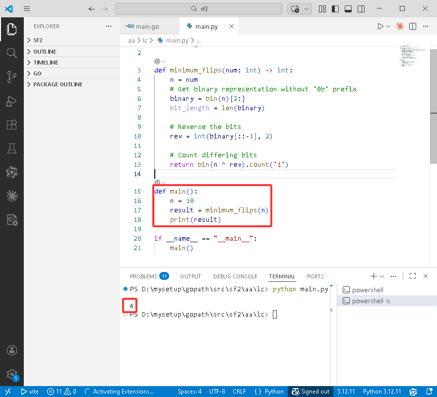

Python完整代码如下:
# -*-coding:utf-8-*-
def minimum_flips(num: int) -> int:
    n = num
    # Get binary representation without '0b' prefix
    binary = bin(n)[2:]
    bit_length = len(binary)
    # Reverse the bits
    rev = int(binary[::-1], 2)
    # Count differing bits
    return bin(n ^ rev).count('1')
def main():
    n = 10
    result = minimum_flips(n)
    print(result)
if __name__ == "__main__":
    main()

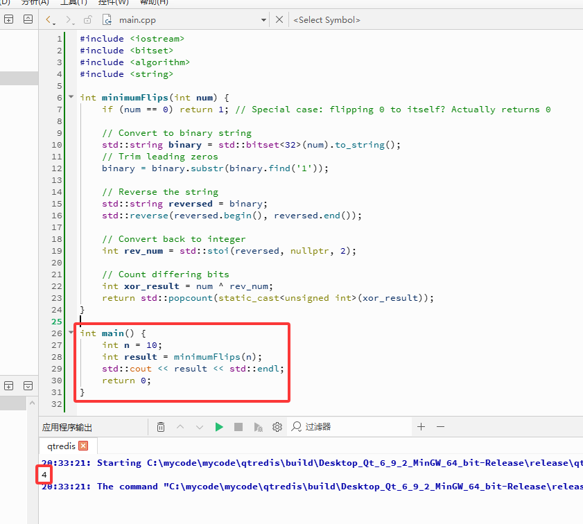

C++完整代码如下:
#include <iostream>
#include <bitset>
#include <algorithm>
#include <string>
int minimumFlips(int num) {
    if (num == 0) return 1; // Special case: flipping 0 to itself? Actually returns 0
    // Convert to binary string
    std::string binary = std::bitset<32>(num).to_string();
    // Trim leading zeros
    binary = binary.substr(binary.find('1'));
    // Reverse the string
    std::string reversed = binary;
    std::reverse(reversed.begin(), reversed.end());
    // Convert back to integer
    int rev_num = std::stoi(reversed, nullptr, 2);
    // Count differing bits
    int xor_result = num ^ rev_num;
    return std::popcount(static_cast<unsigned int>(xor_result));
int main() {
    int n = 10;
    int result = minimumFlips(n);
    std::cout << result << std::endl;
    return 0;
