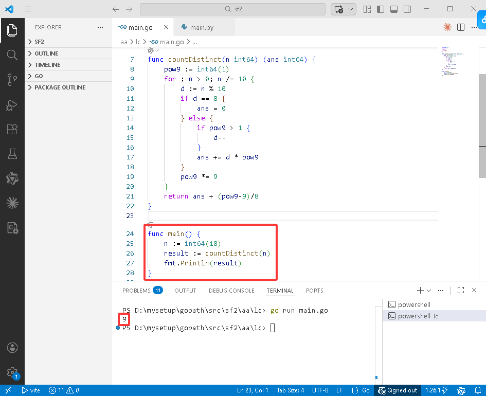

package main
import (
	"fmt"
func countDistinct(n int64) (ans int64) {
	pow9 := int64(1)
	for ; n > 0; n /= 10 {
		d := n % 10
		if d == 0 {
			ans = 0
		} else {
			if pow9 > 1 {
				d--
			ans += d * pow9
		pow9 *= 9
	return ans + (pow9-9)/8
func main() {
	n := int64(10)
	result := countDistinct(n)
	fmt.Println(result)

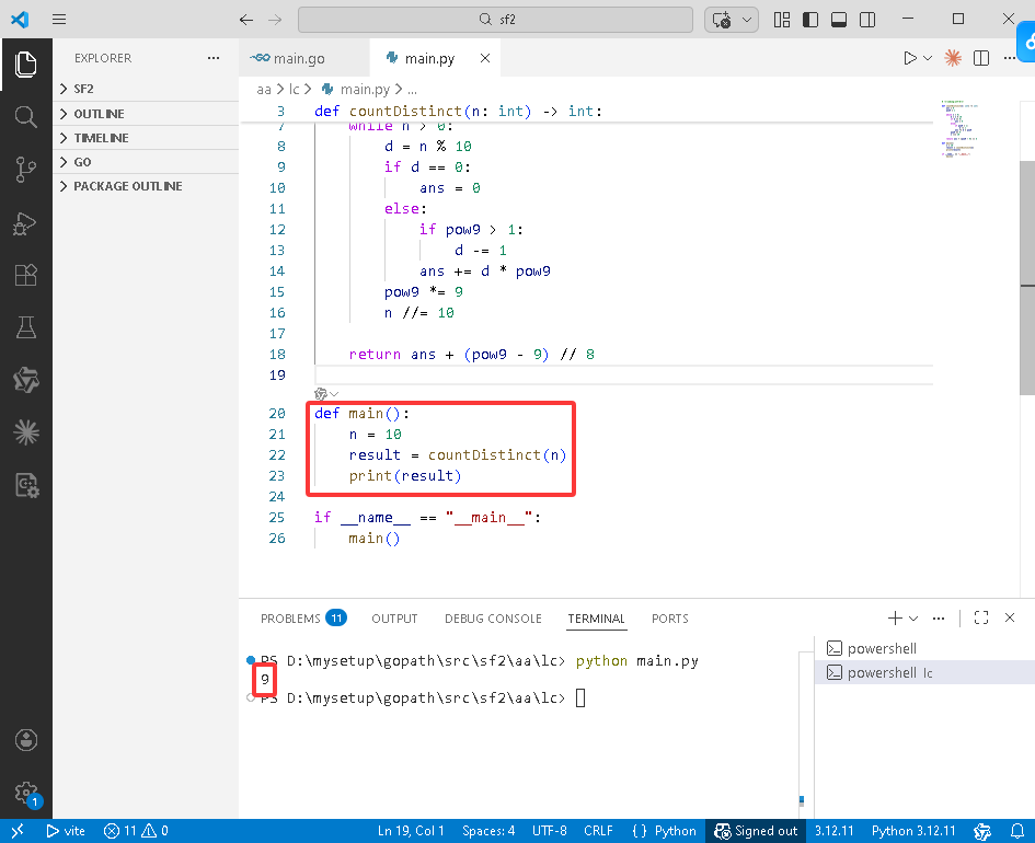

# -*-coding:utf-8-*-
def countDistinct(n: int) -> int:
    ans = 0
    pow9 = 1
    while n > 0:
        d = n % 10
        if d == 0:
            ans = 0
        else:
            if pow9 > 1:
                d -= 1
            ans += d * pow9
        pow9 *= 9
        n //= 10
    return ans + (pow9 - 9) // 8
def main():
    n = 10
    result = countDistinct(n)
    print(result)
if __name__ == "__main__":
    main()

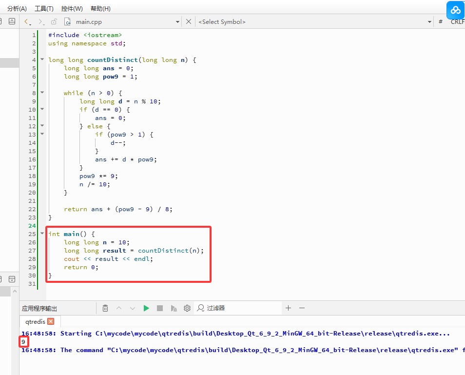

C++完整代码如下:
#include <iostream>
using namespace std;
long long countDistinct(long long n) {
    long long ans = 0;
    long long pow9 = 1;
    while (n > 0) {
        long long d = n % 10;
        if (d == 0) {
            ans = 0;
        } else {
            if (pow9 > 1) {
                d--;
            ans += d * pow9;
        pow9 *= 9;
        n /= 10;
    return ans + (pow9 - 9) / 8;
int main() {
    long long n = 10;
    long long result = countDistinct(n);
    cout << result << endl;
    return 0;
