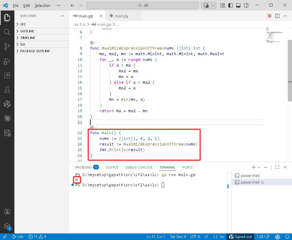

package main
import (
	"fmt"
	"math"
func maximizeExpressionOfThree(nums []int) int {
	mx, mx2, mn := math.MinInt, math.MinInt, math.MaxInt
	for _, x := range nums {
		if x > mx {
			mx2 = mx
			mx = x
		} else if x > mx2 {
			mx2 = x
		mn = min(mn, x)
	return mx + mx2 - mn
func main() {
	nums := []int{1, 4, 2, 5}
	result := maximizeExpressionOfThree(nums)
	fmt.Println(result)

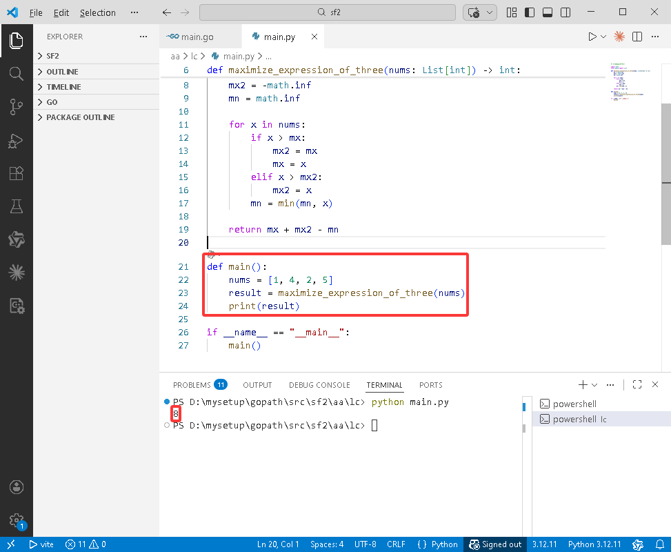

# -*-coding:utf-8-*-
import math
from typing import List
def maximize_expression_of_three(nums: List[int]) -> int:
    mx = -math.inf
    mx2 = -math.inf
    mn = math.inf
    for x in nums:
        if x > mx:
            mx2 = mx
            mx = x
        elif x > mx2:
            mx2 = x
        mn = min(mn, x)
def main():
    nums = [1, 4, 2, 5]
    result = maximize_expression_of_three(nums)
    print(result)
if __name__ == "__main__":
    main()

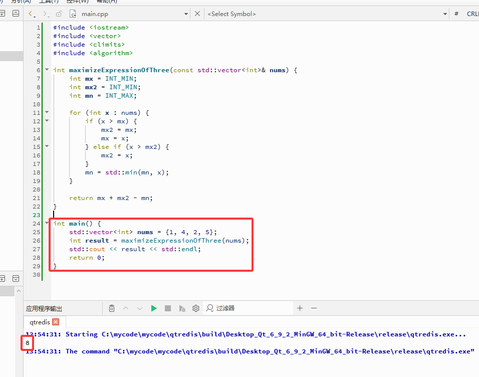

#include <iostream>
#include <vector>
#include <climits>
#include <algorithm>
int maximizeExpressionOfThree(const std::vector<int>& nums) {
    int mx = INT_MIN;
    int mx2 = INT_MIN;
    int mn = INT_MAX;
    for (int x : nums) {
        if (x > mx) {
            mx2 = mx;
            mx = x;
        } else if (x > mx2) {
            mx2 = x;
        mn = std::min(mn, x);
    return mx + mx2 - mn;
int main() {
    std::vector<int> nums = {1, 4, 2, 5};
    int result = maximizeExpressionOfThree(nums);
    std::cout << result << std::endl;
    return 0;
