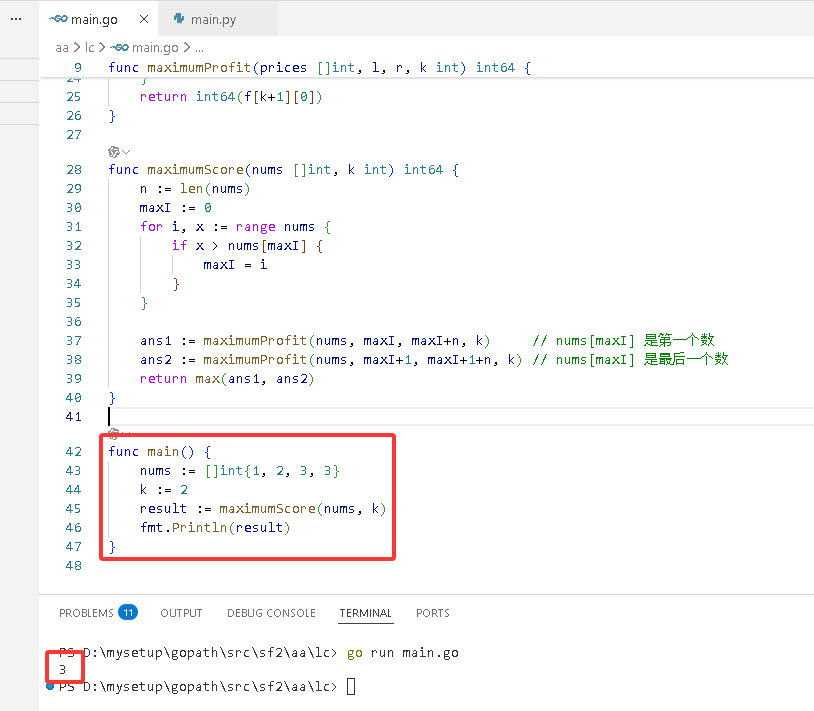

Go完整代码如下:
package main
import (
	"fmt"
	"math"
// 3573. 买卖股票的最佳时机 V
func maximumProfit(prices []int, l, r, k int) int64 {
	n := len(prices)
	f := make([][3]int, k+2)
	for j := 1; j <= k+1; j++ {
		f[j][1] = math.MinInt / 2
		f[j][2] = math.MinInt / 2
	f[0][0] = math.MinInt / 2
	for i := l; i < r; i++ {
		p := prices[i%n]
		for j := k + 1; j > 0; j-- {
			f[j][0] = max(f[j][0], f[j][1]+p, f[j][2]-p)
			f[j][1] = max(f[j][1], f[j-1][0]-p)
			f[j][2] = max(f[j][2], f[j-1][0]+p)
	return int64(f[k+1][0])
func maximumScore(nums []int, k int) int64 {
	n := len(nums)
	maxI := 0
	for i, x := range nums {
		if x > nums[maxI] {
			maxI = i
	ans1 := maximumProfit(nums, maxI, maxI+n, k)     // nums[maxI] 是第一个数
	ans2 := maximumProfit(nums, maxI+1, maxI+1+n, k) // nums[maxI] 是最后一个数
	return max(ans1, ans2)
func main() {
	nums := []int{1, 2, 3, 3}
	k := 2
	result := maximumScore(nums, k)
	fmt.Println(result)

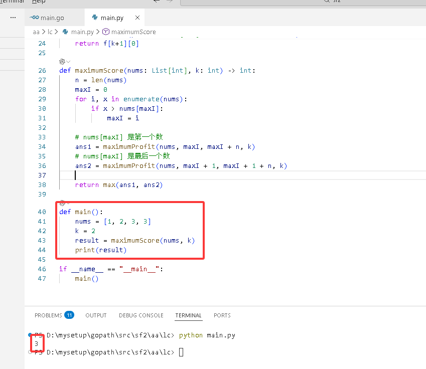

Python完整代码如下:
# -*-coding:utf-8-*-
from typing import List
def maximumProfit(prices: List[int], l: int, r: int, k: int) -> int:
    n = len(prices)
    # 创建dp数组: f[j][0], f[j][1], f[j][2]
    f = [[0, 0, 0] for _ in range(k + 2)]
    # 初始化
    for j in range(1, k + 2):
        f[j][1] = -10**9  # 相当于 math.MinInt/2
        f[j][2] = -10**9
    f[0][0] = -10**9
    for i in range(l, r):
        p = prices[i % n]
        # 倒序遍历j
        for j in range(k + 1, 0, -1):
            f[j][0] = max(f[j][0], f[j][1] + p, f[j][2] - p)
            f[j][1] = max(f[j][1], f[j-1][0] - p)
            f[j][2] = max(f[j][2], f[j-1][0] + p)
    return f[k+1][0]
def maximumScore(nums: List[int], k: int) -> int:
    n = len(nums)
    maxI = 0
    for i, x in enumerate(nums):
        if x > nums[maxI]:
            maxI = i
    # nums[maxI] 是第一个数
    ans1 = maximumProfit(nums, maxI, maxI + n, k)
    # nums[maxI] 是最后一个数
    ans2 = maximumProfit(nums, maxI + 1, maxI + 1 + n, k)
def main():
    nums = [1, 2, 3, 3]
    k = 2
    result = maximumScore(nums, k)
    print(result)
if __name__ == "__main__":
    main()

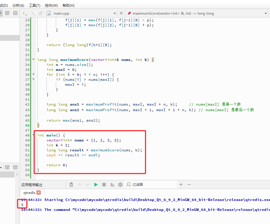

C++完整代码如下:
#include <iostream>
#include <vector>
#include <algorithm>
#include <climits>
using namespace std;
long long maximumProfit(vector<int>& prices, int l, int r, int k) {
    int n = prices.size();
    // 创建dp数组: f[j][0], f[j][1], f[j][2]
    vector<vector<int>> f(k + 2, vector<int>(3));
    // 初始化
    for (int j = 1; j <= k + 1; j++) {
        f[j][1] = INT_MIN / 2;
        f[j][2] = INT_MIN / 2;
    f[0][0] = INT_MIN / 2;
    for (int i = l; i < r; i++) {
        int p = prices[i % n];
        for (int j = k + 1; j > 0; j--) {
            f[j][0] = max({f[j][0], f[j][1] + p, f[j][2] - p});
            f[j][1] = max(f[j][1], f[j-1][0] - p);
            f[j][2] = max(f[j][2], f[j-1][0] + p);
    return (long long)f[k+1][0];
long long maximumScore(vector<int>& nums, int k) {
    int n = nums.size();
    int maxI = 0;
    for (int i = 0; i < n; i++) {
        if (nums[i] > nums[maxI]) {
            maxI = i;
    long long ans1 = maximumProfit(nums, maxI, maxI + n, k);     // nums[maxI] 是第一个数
    long long ans2 = maximumProfit(nums, maxI + 1, maxI + 1 + n, k); // nums[maxI] 是最后一个数
    return max(ans1, ans2);
int main() {
    vector<int> nums = {1, 2, 3, 3};
    int k = 2;
    long long result = maximumScore(nums, k);
    cout << result << endl;
    return 0;
